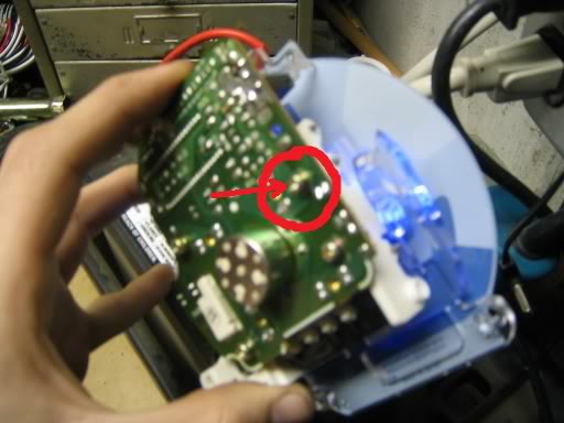

Well, I ended up taking the thing apart and looking at it. Pulled the speedo completely out and noticed what looked like a solder point under the circled screw in the pic below. Well, it was pretty worn away and did not seem to be making contact with the screw any more but there was still a TINY bit of solder left. Since I am no good with soldering, i just got a larger washer to increase the contact area and put that on. Screwed everything back together and, knock on wood, no speedo issues for 3-4 days.

I have had same problems since the summer. I replaced the vss first because that was most likely and easiest to get too. Didn't help. Speedo and cruise control stopped working under load. Finally took the instrument cluster out today and took the speedo out today. Thanks for the pic 2brosgixxer. I noticed the solder point as well. I took screw out and in and tightened all screws a bit. Everything is back together. The speedometer and cruise control seem to be working. I was able to go up our big hill using cruise control and everything was fine. Don't know what to tell you about the ticking though. Good luck and good post.
