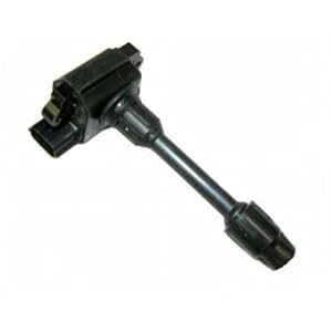

ignition coils...they look a little like a popgun if you hold them the right way...
