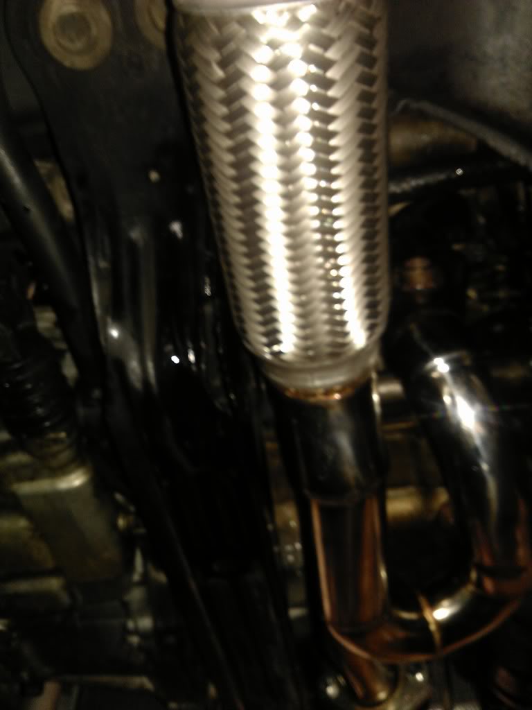

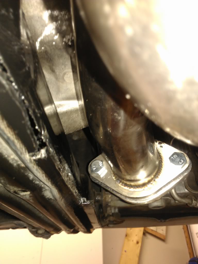

I've got them installed finally. It feels amazing. I do have a minor exhaust leak between the cat and the ypipe. That will be fixed in a week or 2 when I install my test pipe.

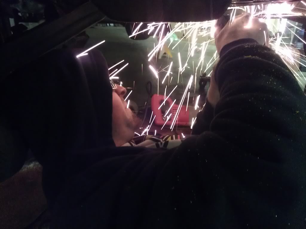

My buddy grinding the cross member

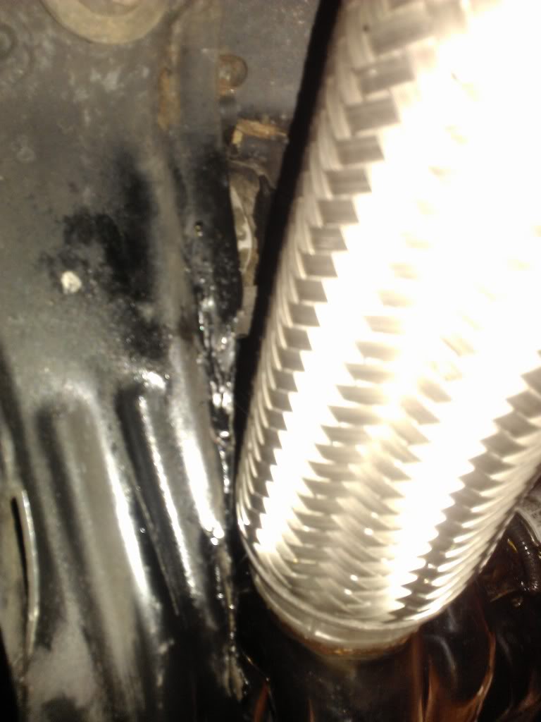

Pictures of the cross member and where it was cut and ground. I painted the cross member after it was finished to prevent rust.

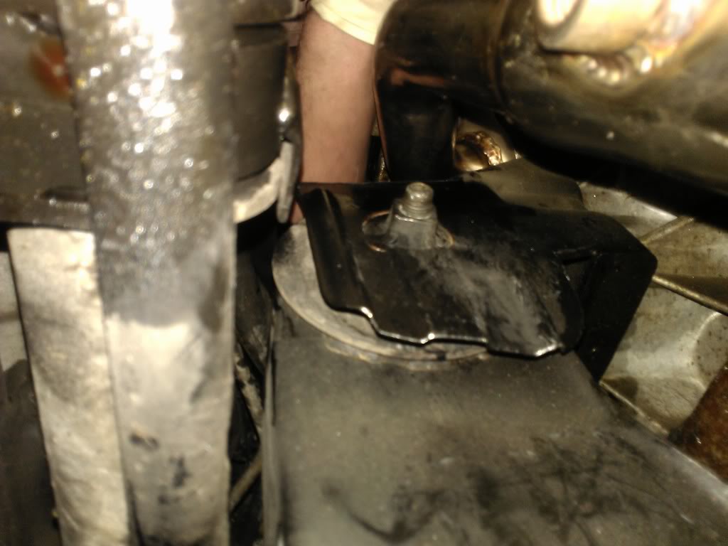

Pictures of the motor mount cover. I cut the passenger side of the cover off with a grinder and then broke the other side with a pry bar and hammer.
I did undo the inner power steering hose. It's only a clamp and 2 bolts and it made working the headers in place much easier. As stated, you don't have to remove these, but I personally found it easier to just take it off for extra room. The rear o2 sensor in the ypipe is a tight fit between the sway bar and the firewall but you can get it to fit, once it's screwed in all the way it won't touch anything. I've deleted the ENTIRE EGR system. None of it is longer bolted to the car. I've rerouted all the coolant lines to bypass their original set up and removed everything related to the EGR. I then cut the top of the EGR tube off from pipe and welded it shut and re-bolted it to the intake manifold.
All in all, this project took about 8-10 hours. It's a lot of trial and error. However, once you finally get the headers on and start it up for the first time, you get the biggest amount of satisfaction. It feels like a whole new car. Like nothing is holding it back. The time it takes to get from 75-110 happens so much quicker then stock and it just keeps climbing and climbing like it doesn't even have to try. The sound is also quite nice, minus the exhaust leak that I have. I'll be sure to make a video of the sound once I get the leak fixed.

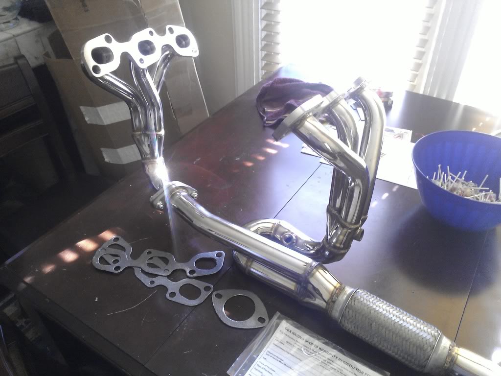

OBX-R V2 Headers/ypipe for VQ35
Really it's just fitment that's a *****. You have to unhook everything just to get the rear header to slide up into place. Then it's constant remove, grind, place, remove, grind, etc. It's going to be well worth it though, so I'm just going to keep at it. I should have it done by tonight.
