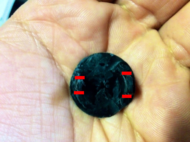

I then had to figure out how to plug up this pointless key lock hole.
The OEM lock doesn't even fit into so you'd have to dremel out the hole some. I'd rather not. You'd also have to cut out the back of the trunk to swap everything over. There are no openings on the inside of the trunk. I really wish this hole wasn't here like the Ionic trunk.
What I decided to do was get a black 7/8" nylon plug hole from Lowes. It took a bit of trimming as you can see here. The red shows what's left from the back:
But the plug fits great.

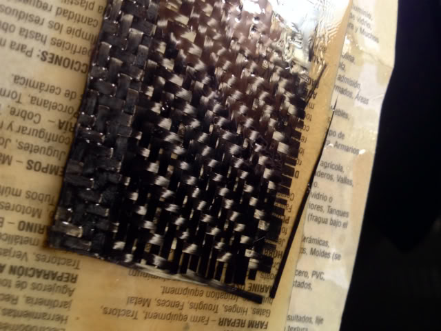

I have some twill weave here but no resin. I'm experimenting with some urethane since I have plenty of that from clearing headlight lenses. I'll see how that goes. Hopefully that'll work.
Old Jan 28, 2014 | 05:14 PM
  #65
So here's what I've got after five coats of the urethane. The small strip on the left only received one coat just to see how much better the piece would get with more coats:
It has a slight yellowish hue like the urethane because the white cardboard under the CF absorbed it. It's also not 100% smooth because I used a plastic spoon to smooth the urethane over
Next time I'll use a black painted piece of cardboard with a thinned out urethane mix to see how that goes. It'll probably need more than five coats but whatever. It should come out decent enough for that plug. I wouldn't wrap a big piece like this.

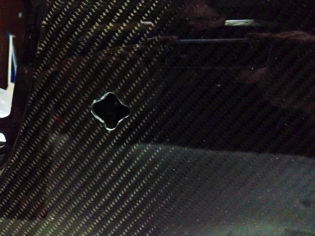

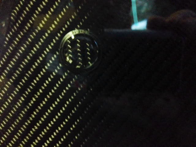

I ditched the DIY CF plug idea and decided to buy something. What I ended up using was a CF handlebar end plug from One-10 Sports. After some modification it fit pretty well and looks a lot better than the plain black nylon plug.
Old Feb 23, 2014 | 12:15 PM
  #69
Now I have some questions for those who have CF trunks installed; what do you guys do about the torsion bars (if that's what they're called) that hold the trunk up? Do I remove one or both of them? What's the easiest way to remove them?
Old Feb 23, 2014 | 02:48 PM
  #70
I removed both of mine. I forget if they only work together as a pair. If not, remove one and try it out and see if the tension is just right for when you pop the trunk.
As for removal, I can't remember how I did it. Been way too long.
Plug looks good. Can you rotate it so the weave goes in the same direction as the trunk?

I removed both of mine. I forget if they only work together as a pair. If not, remove one and try it out and see if the tension is just right for when you pop the trunk. As for removal, I can't remember how I did it. Been way too long.
I'll do that. I may just cut one bar in the center and wiggle it out. I really don't feel like struggling with it.
Does your trunk pop up when you unlock it without the bars?
For now I'm going to leave it as is. If it annoys me enough, I have another plug that I'll modify to make the weave go the same way.

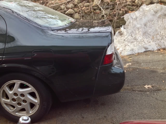

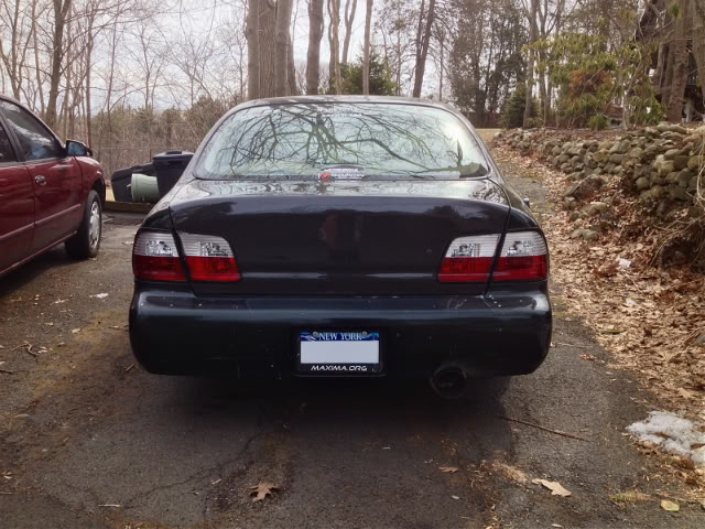

Installed!

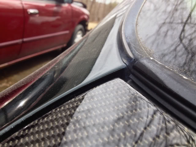

Install went straight forward. First thing I did was remove the bars that hold the trunk up when opened. What I did was use an angle grinder with cutting blade to cut them right in the center. Kind of sketchy but it worked. Both were easily removed.
Then I removed the tails, wiring, latch and OEM trunk (with the help of my brother). When installing the CF one, everything was pretty much a direct fit. I had to play with the fitment very little to get the gaps pretty much even on each side.
The only down side is that in the top corners, they sit a little lower on each side than the quarter panels. A little bit of an eye sore but I'm sure it can be solved with washers (haven't bothered yet).
For now, I'm very happy with the way it looks and fits. Eventually I'll add some washers to get it to fit 100% and have to play with the tail light fitment a little as well. The OEM inners fit great. My eBay ones... not so great but acceptable for now.

I do dislike how the trunk doesn't stay up when opened. Any fix for that James? I tried a bungee cord but that didn't work.
Old Mar 17, 2014 | 12:02 PM
  #75
Quickywd01's Avatar
iTrader: (16)
Joined: May 2007
Posts: 3,078
From: NorthernNJ
Looking good Chris! What about gas struts? That was my first thought. You may need only one because the trunk is so light.
