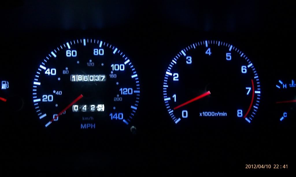

These are cool white plug n play leds. They are not quite as blue as the pic in person. And they are more even colored in person too but you get the idea. They are about the same color in person as the 40 is lit up.
