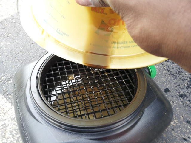

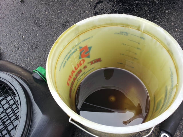

Here is what the old oil looked like. I talked to someone who has extensive knowledge on car repairs for like 70's and 80's cars and he said the fluid looked fine and probably didn't need replacing. I thought this fluid was supposed to be red. Anyway, I replaced it with ~4.5 quarts of Redline MT-90 GL-4 75W90 Oil. When I drive with the thermostat reading cold, the car shifts smoothly but when the thermostat is centered, the car seems to be rough or stiff in the gearbox when shifting. Any suggestions on what I should do to resolve this issue?
Yes, Automatic transmission FLUID is red.
No, GEAR OIL for manual transmissions is NOT red, it should be golden brown.
How did it shift before changing fluid? If the synchros ore toast no gear oil will fix that.

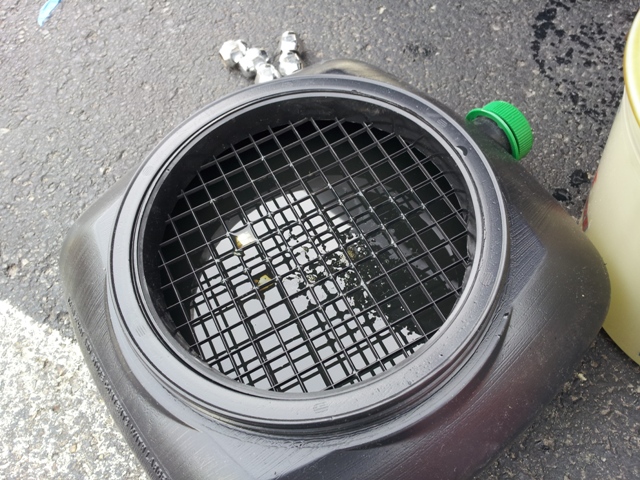

For what I paid for a few bottles of synth tranny oil the other day, it's getting reused next time. That drained fluid looked fine, did you happen to notice any metal flakes or shavings in it?

No flakes or shavings but when I shifted with that fluid, I would get grinding of gears once in a while. The Red Line fluid was red btw. The shifting was stiff and smooth on and off. I hope I didn't make my situation worse...
The shifting was stiff but all my gears work and shifting from 1st to 2nd was not very smooth. With the Red Line, its smooth when cold but seems to go back to the way it was or gets a little more stiff when warm.
Red line is red, just as royal purple is purple, its marketing. Gear oil is generally the same color as motor oil.
Sounds like damage is already done to the synchros, only time will tell. The redline is good, it won't cause any (more) damage.
