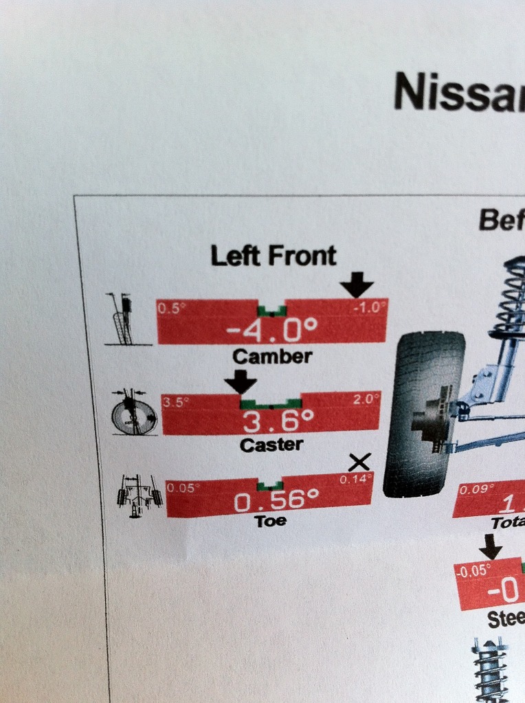

Well had the alignment done today and turns out it was just the toe that was off. Although looking at the tires I could have sworn the camber is off by the way they are sitting but the $30k machine they used to align my car doesn't lie. Left front camber was -0.1 degrees and right front camber was -0.3 degrees so they were both within spec. Toe on the left was 0.47 degrees which wasn't too bad but toe on the right was 1.81 degrees which would definitely explain why it was pulling to the right. Hate paying other people to work on my cars but for $62 and the pinpoint accuracy a shop has with their expensive equipment sometimes its just best to let them do it. Thanks to everyone who contributed to this thread.

VisciousMo's Avatar
Joined: Dec 2010
Posts: 803
From: SATX-HTX

I take my car to a specialist suspension shop that normally preps cars for the track. Our camber is set to what it is for the stock ride height. Once lowered the suspension geometry is now changed so the values don't function the same. All of the values must be changed in order to have a functioning system again. Now my car is far from "slammed", about 26" fender height give or take but my car goes straight as an arrow when I take my car off the line but still squats in the corners instead of bouncing around which is a sure sign of bad geometry. Slammed maxes simply don't handle good, its for looks. looks that I am jealous of....
