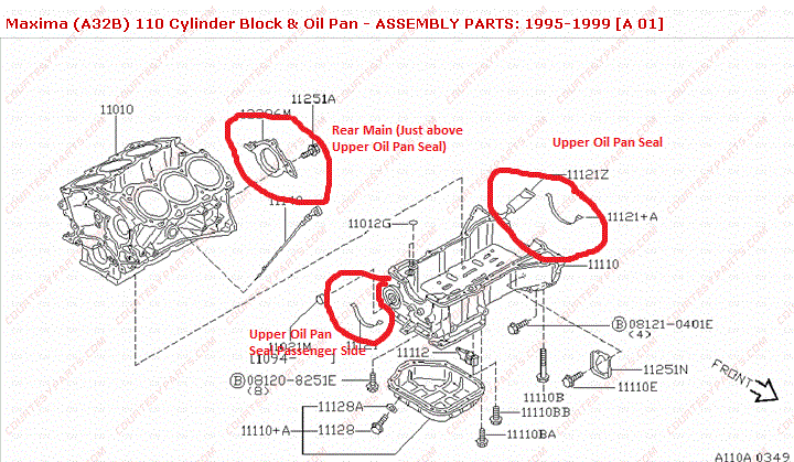

You sure it's the rear main leaking and not the Upper Oil pan half moon seal?

+1 if it is the RMS I would be surprised. What side of the car is it dripping on? Would be driver side for RMS but if it is the passenger side it could be one of a few things
Upper Oil pan seals are on the Driver AND Passenger sides. I would bet Upper pan before RMS
People still get confused up to today with this. It is the half moon seal leaking which is causing your oil leak. If it was the RMS, you would have been seeing white-bluish smoke out the exhaust.

Originally Posted by kasso28
why does everybody say replace the upper pan seal and not the rear main seal?? The half moon seal sits on the rear main seal. And your either gonna spend couple of hours or a couple grand, why not just replace a $50 seal?
The RMS actually sits on the Upper Pan seal IE, the RMS is above the pan seal (see my pic in post #8). We say to replace the Upper Pan seal because the RMS rarely goes bad on these cars unless you significantly overfill your oil. In order to do the RMS, you need to pull the tranny. To do the Upper pan, you don't need to pull the tranny. The seals for the Upper pan are about $10 the rest is labor.
