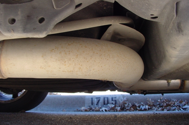

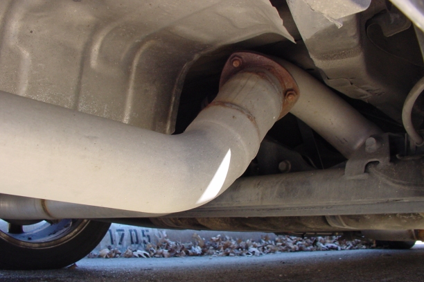

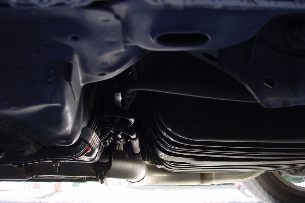

hate to break it to you guys but, a dual B-PIPE setup would be extremely hard to make because of space limitations under the car. having spent countless hours under my car, i can tell you that it'd be difficult to fit two pipes in the space after the cat. if you've looked at the b-pipe, you know there's a 90 degree bend in it when it goes around the gas tank. with a a dual setup the other pipe would have to have a 90 degree bend to the opposite side. however, the gas tank is offset. while there is maybe 5" of space(width) for the b-pipe to pass on the normal side, there is only about 3" of space on the other side AND there are fuel lines running there AND the space on the other side doesn't go up as high. if you were to run both pipes next to each other the whole way back, i don't think it would clear the rear beam because my 3" pipe barely clears the rear beam. now if it does clear the rear beam then you have to run the second pipe behind the beam to the other side and then back out. but to put a muffer on the other side there are two more obstacles. you have your EVAP canister sitting in the space directly opposite of your stock muffler's location, and then there's the trunk.
take a look for yourselves:
