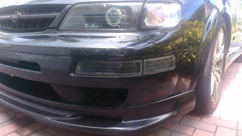

Here's a pick on the car don't mind my paint.... =/

Old Jun 2, 2013 | 01:17 PM
smittybizzle's Avatar
Joined: Apr 2009
Posts: 364
From: Winston-Salem
Looks good. I love when the older Maximas have projectors.
