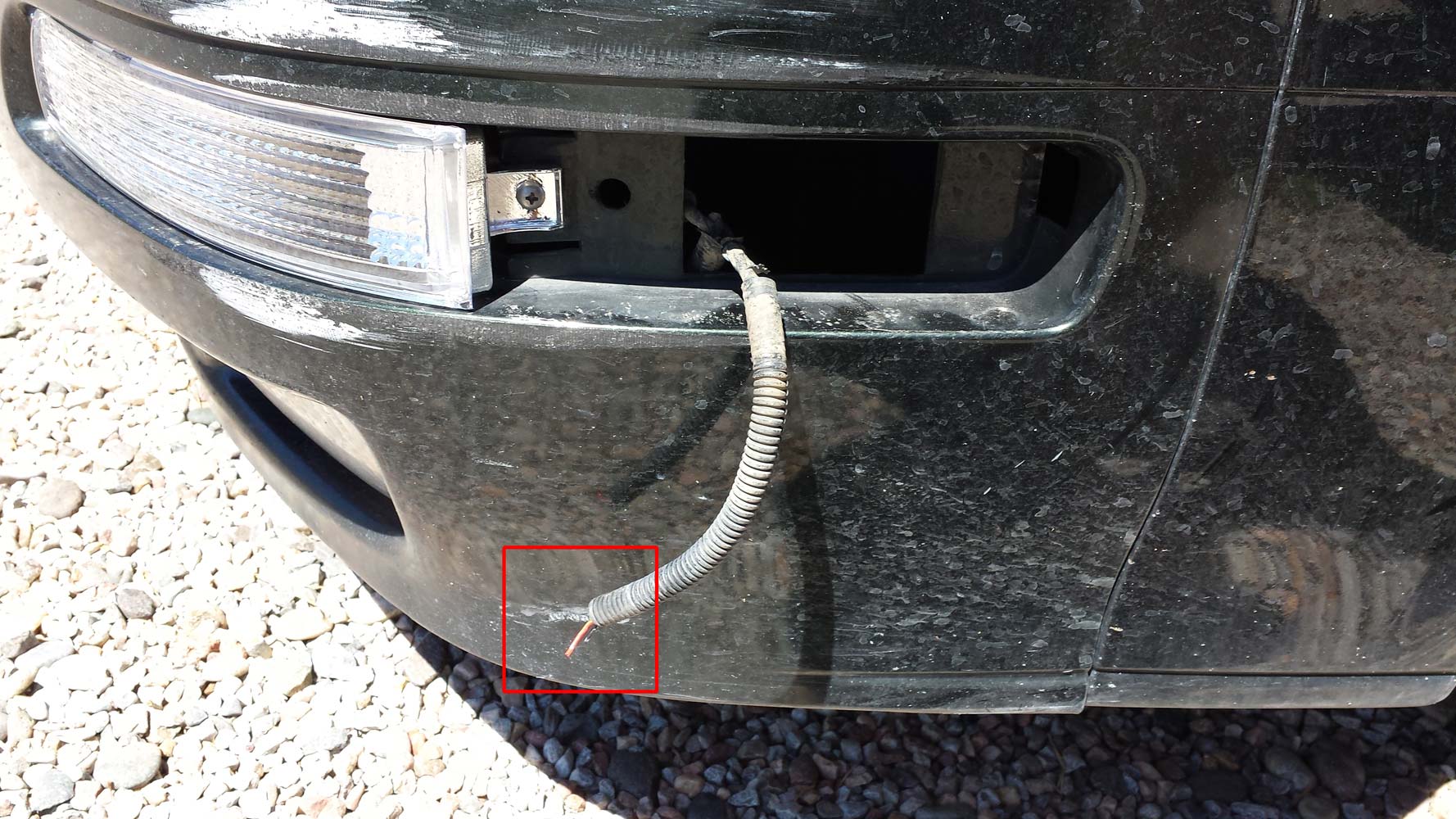

So the dreaded happened, and I finally lost a clear corner.
It took the whole dang assembly.
What I'm wondering is what I need to fix it.
Just the plug/bulb? Whole wire harness?
What part #s do I need to order?
Thanks.

Junkyard and a new set of clears unless you get lucky and find someone wanting to sell just one clear corner.
You just need the bulb plug with extra wire/pigtail.
There is no part number that I know of.

Here are some part numbers. I am not sure whether the outer lens comes with the complete assembly or not. I think it does.
Personally, I would check out a junkyard or pm Maxima_Joe, an org member who sells used parts.
1995 - 1996
LAMP ASSY-SIDE MARKER, LH 26185-40U25, list $50.50, on-line $40.63
1997 - 1999
LAMP ASSY-SIDE MARKER, LH 26185-40U26, list $50.50, on-line $40.63
1995 - 1999
LENS-SIDE MARKER LAMP, LH 26189-40U10, list $28.65, on-line $23.05
1995 - 1999
SOCKET ASSY-SIDE MARKER LAMP 26597-86E10, list $11.98, on-line $9.05
GROMMET-SCREW 26399-40U00, list $1.15, on-line $0.93

^^^ he's right. I left the wire harness end out.
1995 - 1999
CONNECTOR ASSY-HARNESS REPAIR, 2P 24342-0ZFY0, list $9.25, on-line $7.44
specification: FR SIDE MARKER Z02FGY

So just to make sure I need:
[26250] SOCKET ASSY-SIDE MARKER LAMP
[26180A] BULB-SIDE MARKER LAMP
[24342PD] CONNECTOR ASSY-HARNESS REPAIR,2P

Originally Posted by Acerbis
Thanks for the replies guys.
[26250] - yes
[26180A] - yes
[24342PD] - NO this is for the turn signal light. You need the side marker light 24342PF
