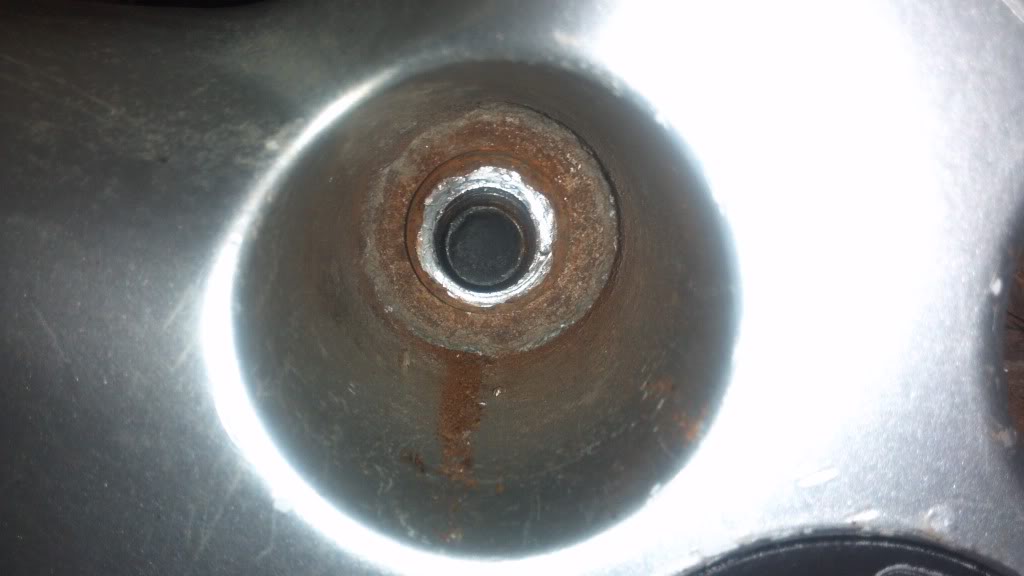

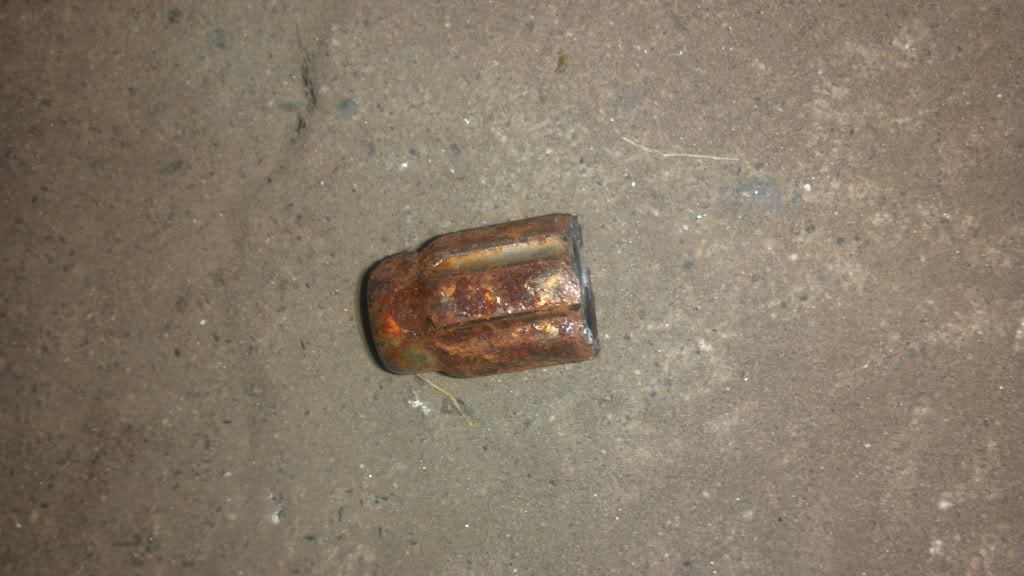

As the title says, I snapped a lug nut while it is still attached to the stud on the rear wheel. The lug nut is one of those locking types and the damn thing sheared right off. Any one have an idea how to get it out?? There is not enough of it left for me to get the special socket onto it. Heres some pics
Here is what is left of the Lug Nut.

And here is the remainder inside the wheel see the shiny silver...yeah, thats what is left. It's about 1/8 - 1/4 inch thick plus the tapered end that goes into the hole...not enough left to get a small socket onto.

Your best route is to get a new stud and lug, theyre dirt cheap. Had a similar situation when i got my new wheels; the idiots at the tire shop crossthreaded one of my lugs on with an impact gun which resulted in a ruined lug and stud.
Just take a rubber mallet (or a piece of wood and a normal sledge) and bang the stud out, one maybe two hits will get it out. Use pb to loosen it. Put the new stud in and use an open lug to pull it through noce and tight. Should take 10 mins tops.

You will need a new stud and lug, but getting that one out will be fun. You will need to drill out the stud before whacking it through the old nut. Start a small pilot hole by using a punch to center the bit and a small drill bit. After the pilot hole, use a bit one fraction of an inch smaller than the stud. You want to drill the threads off of the stud so the nut comes off. Hammer it through the hole in the rotor, remove the other nuts and rim. Then reinstall a new stud and nut.

Never saw that happen before. That's going to be a real PITA to get out. I think your only option might be to drill the stud until the remaining part of the lug nut falls off. It looks like a fairly flat surface to center punch, then drill. You want a bit size the same or ever so slightly larger then the stud. Once you pass through the lug, it should fall off. Take the other 4 nuts off so you can pull on the wheel a little as you get into it.

Like the others have said, you're going to have to drill the stud out and replace it. On something the size of the wheel studs, I would do three drill sizes - a small pilot hole no bigger than 1/8, an intermediate size no bigger than 1/4 and then the final size.

HAHA! I wish I knew! I was trying to pull the wheel off because the brake pads on that side are only making contact with the bottom half of the rotor. So I was trying to see what was going on. I tried to be very careful because the special socket I have is not the most rugged and I didn't want to snap that as I have before. Well, now I wish the socket snapped Oh well, I went to tire warehouse today and they said $35 to fix it. I'll just have them do it since most of my tools are packed away right now...plus I don't need any more headaches Gotta replace some brake lines soon too. Ahhh, the joys of a 16 year old car in Maine.

Got it done at the tire shop today...$24.
