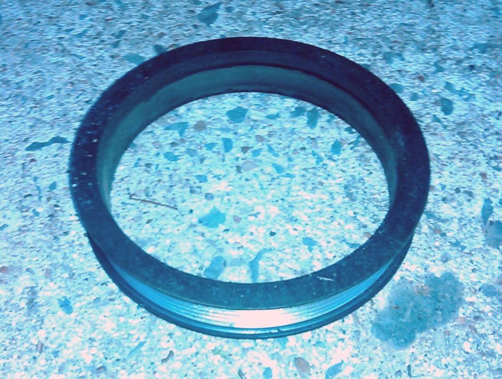

Here's what I know about VQ30DE crankshaft pulleys and harmonic balancers.
In this picture, you can see the crankshaft pulley with the holes drilled in the outer ring. The holes are drilled as part of a balancing process. If the holes are not in the correct location, the wheel will be out of balance. When I replaced this part on my I30, I looked for a quality part that I believed would be correctly balanced. I got lucky because the replacement has worked great.
Here's a picture of the crankshaft pulley/harmonic balancer on the car.
As you can see in the picture the pulley is connected to the inner spoke wheel by a rubber buffer area. I believe the rubber area is used to reduce vibration to/from the crankshaft and act as a shear pin type device in the event the A/C compressor clutch bearing or alternator bearings were to lock up any belt movement.
Since the Maxima water pump is driven from the timing chain, a major A/C clutch failure that locks up the main serpentine belt may not result in the car being rendered undriveable for a short distance. The engine will continue to turn the WATER and Power Steering pumps (via timing chain and a 2nd belt) even if the main belt is locked up with a failed compressor and alternator bearing. Unlike other cars, a Maxima can be driven some short distance without engine damage occurring in this situation. I like this crankshaft pulley setup better than any other I've seen to date.
Now if the rubber buffer area becomes worn over time (in my case it was 225,000 miles) by a failing alternator bearing or is exposed to excessive amounts of oil that causes rubber deterioration, the outer ring that drives the main serpentine belt, will separate from the inner wheel.
Here's a picture of the outer wheel from my I30 after it separated below.
Once the outer area separated from the inner wheel, you can bet all harmonic balancing was lost. If this happens the outer ring will start rubbing against the Power Steering belt and the noise will sound very severe.

Since I can't see the car or a video or it running, all I can do is reflect on my own experience with the VQ30DE crankshaft pulley/harmonic balancer. I hope this information helps.
