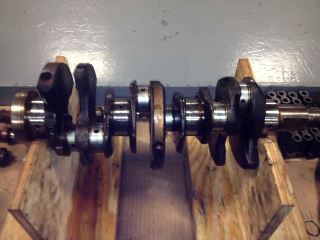

Got the 3.5 crank in today waiting on arp main studs to torque it and move further along.

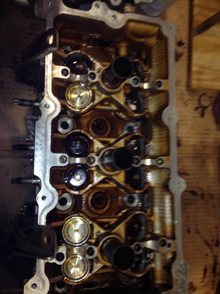

started head work today cutting seats kinda running out of steam on this only gonna do a 2 angle.

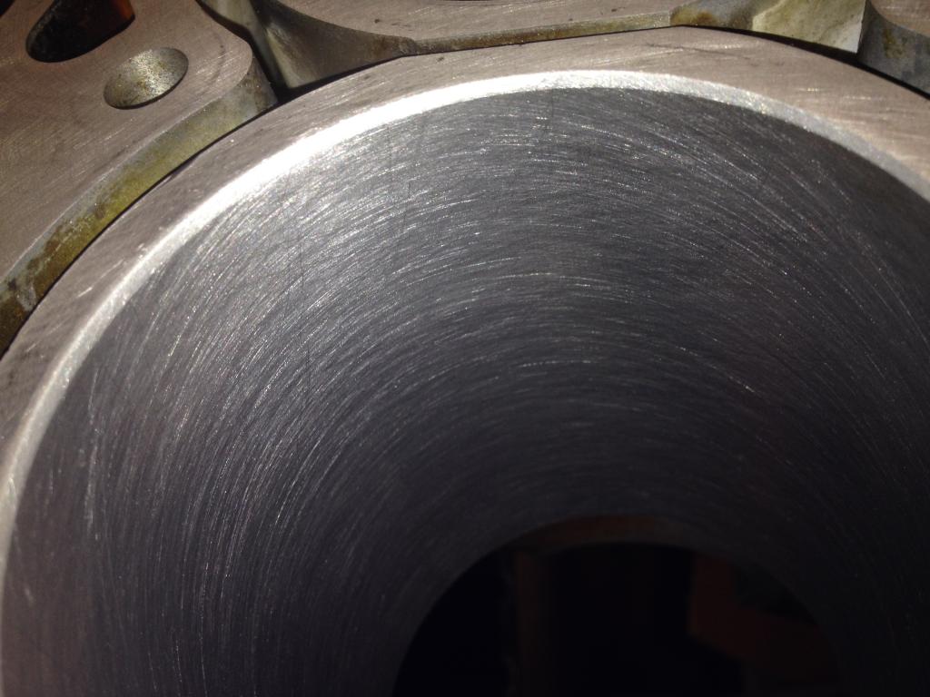

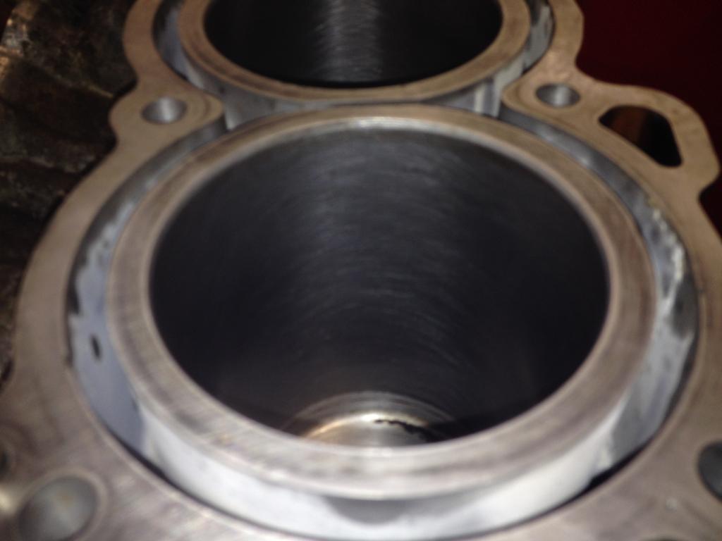

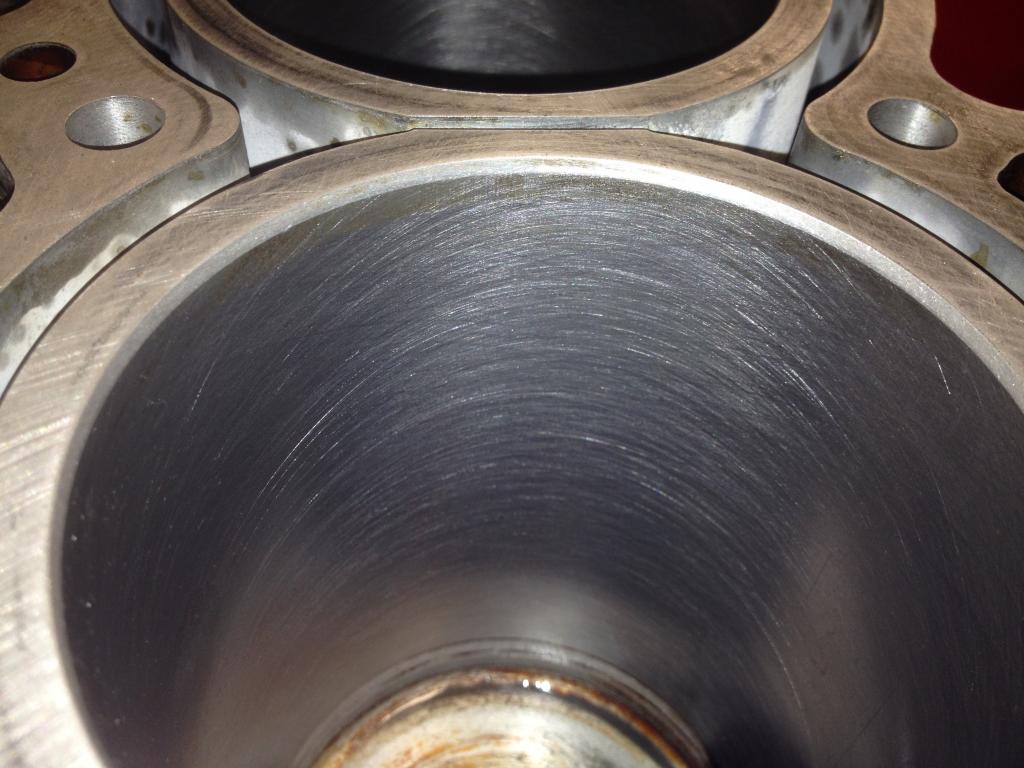

Ball Honed the cylinders to remove surface rust and check for pitting in all of the cylinders, 1 cylinder had 1 pit in it.... so close to getting away without boring if I wanted to but of course I want that 1mm extra displacement
Attachment 19917
Attachment 19918
Attachment 19919

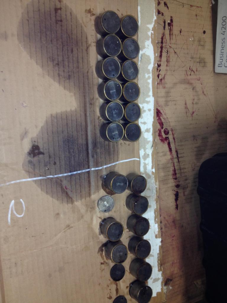

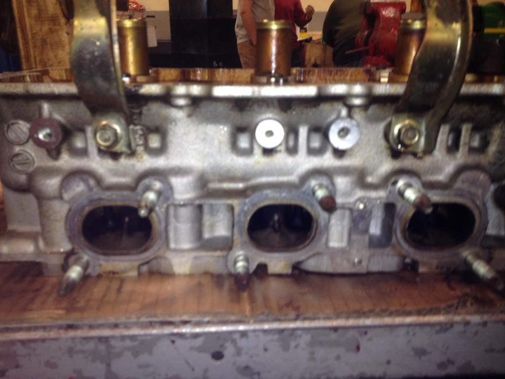

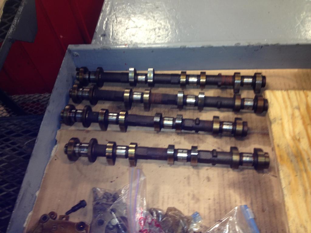

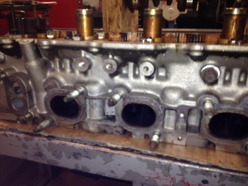

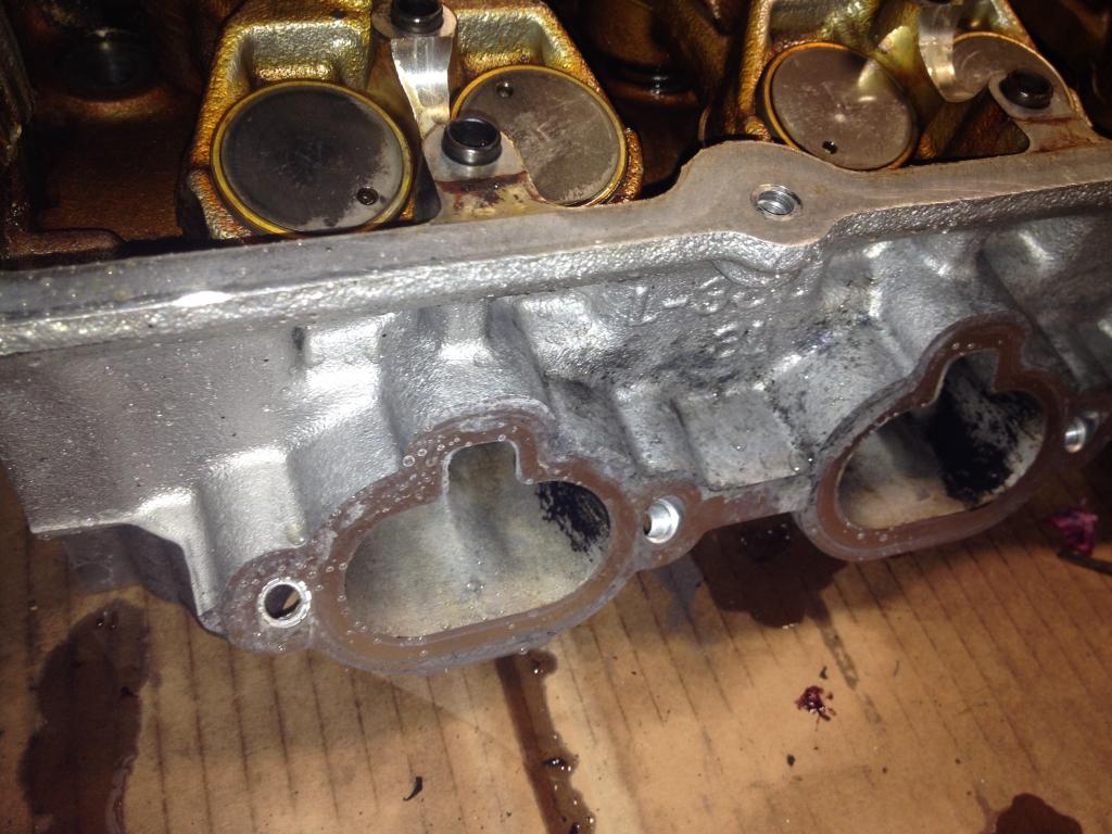

Pressurewashed the heads and started to remove the shims and buckets, 3 buckets will not come out I have pushed them in with rubber mallets and oiled them with 10w30, wd40, pb blast I even forced them to spin by using a pick pushed into the oil feed hole in them but I still cannot get those 3 out the rest either pulled out with a magnet or the previous method.
Attachment 19920
Attachment 19921
Attachment 19922
Attachment 19923
Attachment 19924
Attachment 19925
Attachment 19926

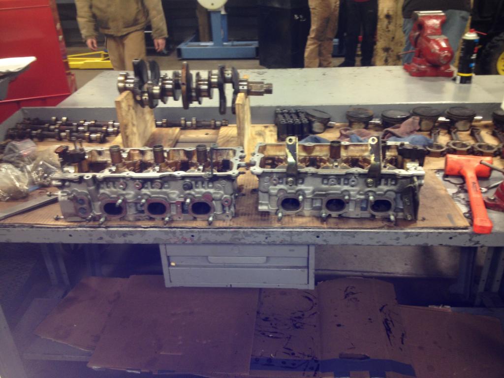

Started sorting out parts aswell that were just thrown into a box this is where I am really gonna need some forum help from people with experience, none of the bolts are labeled this is a nightmare of an issue but im keeping optimistic with it.
Attachment 19927
Attachment 19928
Attachment 19929
