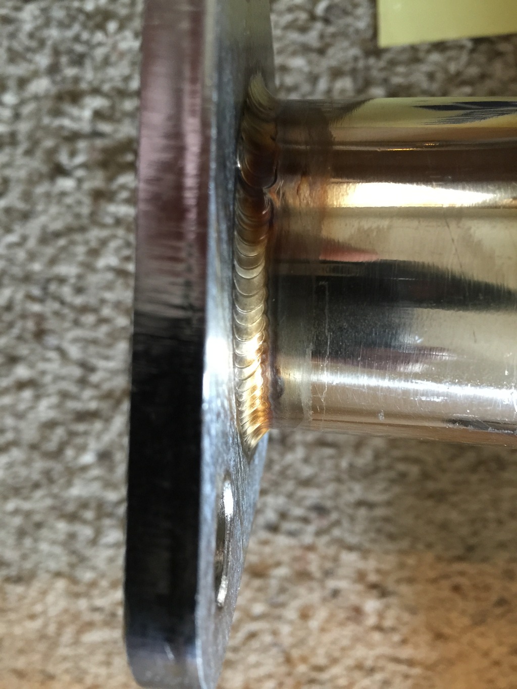

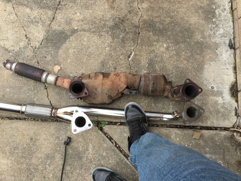

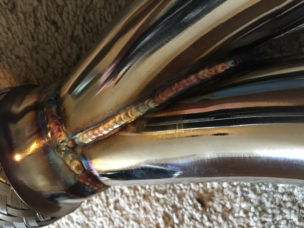

Ok so since I can't find a real good thread about eBay y pipes I figured I'd just make my own.
I recently won one on eBay for 50 dollars shipped to my door. Headers and Y pipe. I figured what the hell. 50 vs 275 for the warpspeed one. Meh I'll give it a go.
The brand name is Manzo. Never heard of them.
http://www.manzousa.com/index.php/pr...-downpipe.html

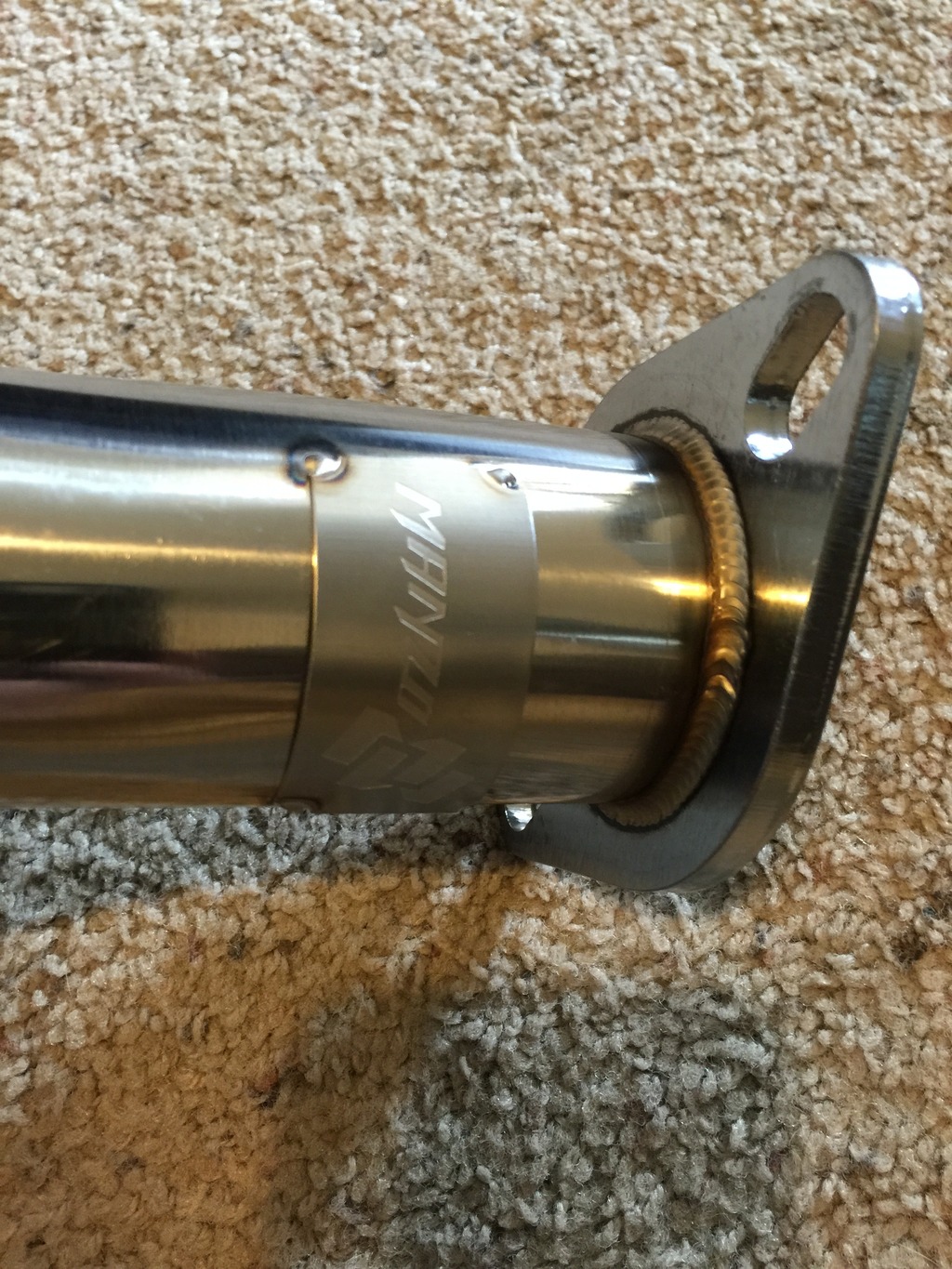

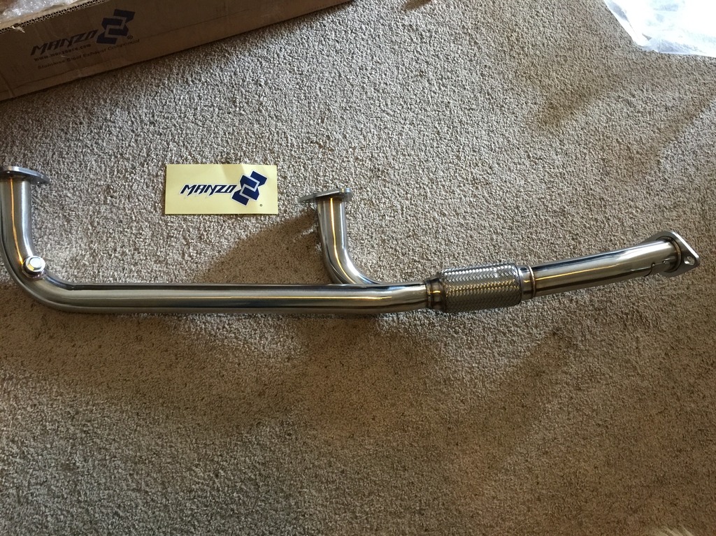

Packed very well. Welds look good. Couple of shots here.

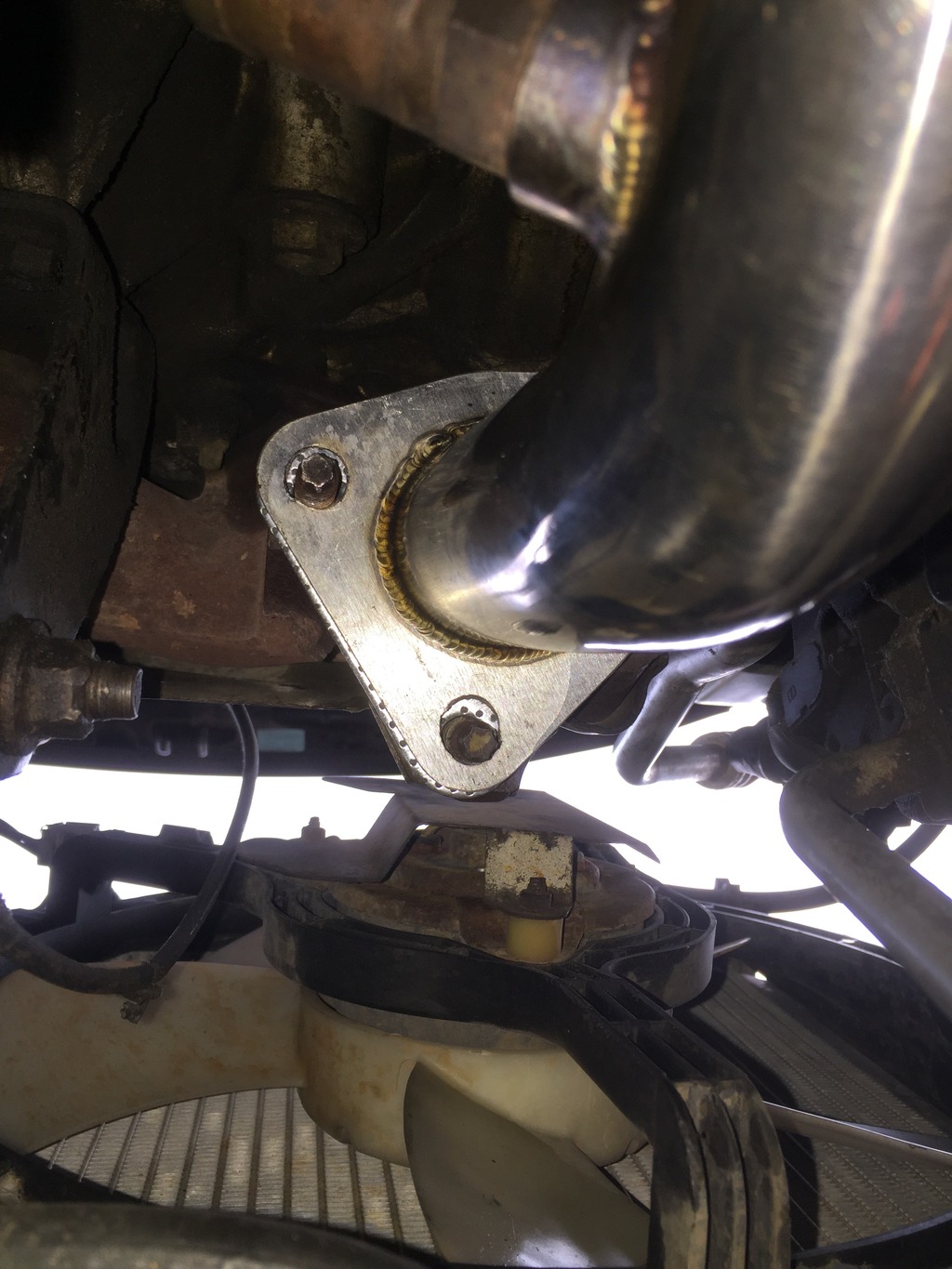

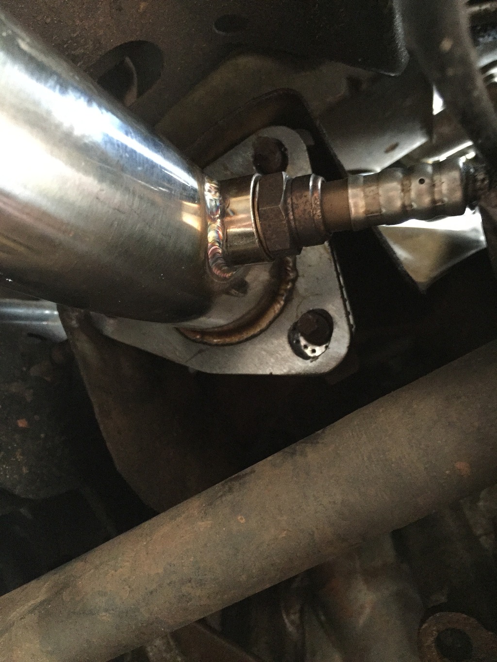

Got the Y pipe on. Without the headers it came with. Took a little massaging with the bolt holes. I'll upload pictures in a bit.

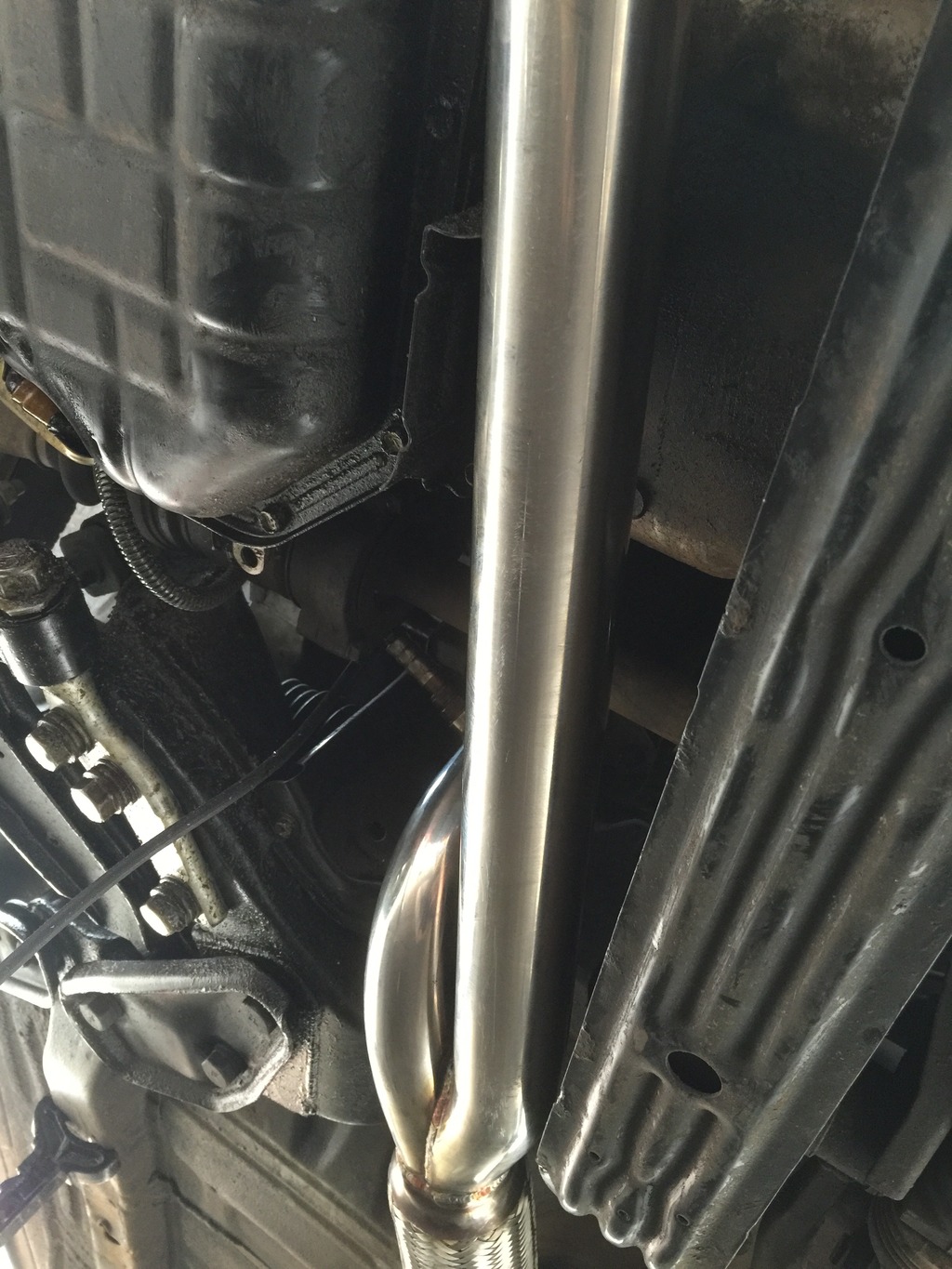

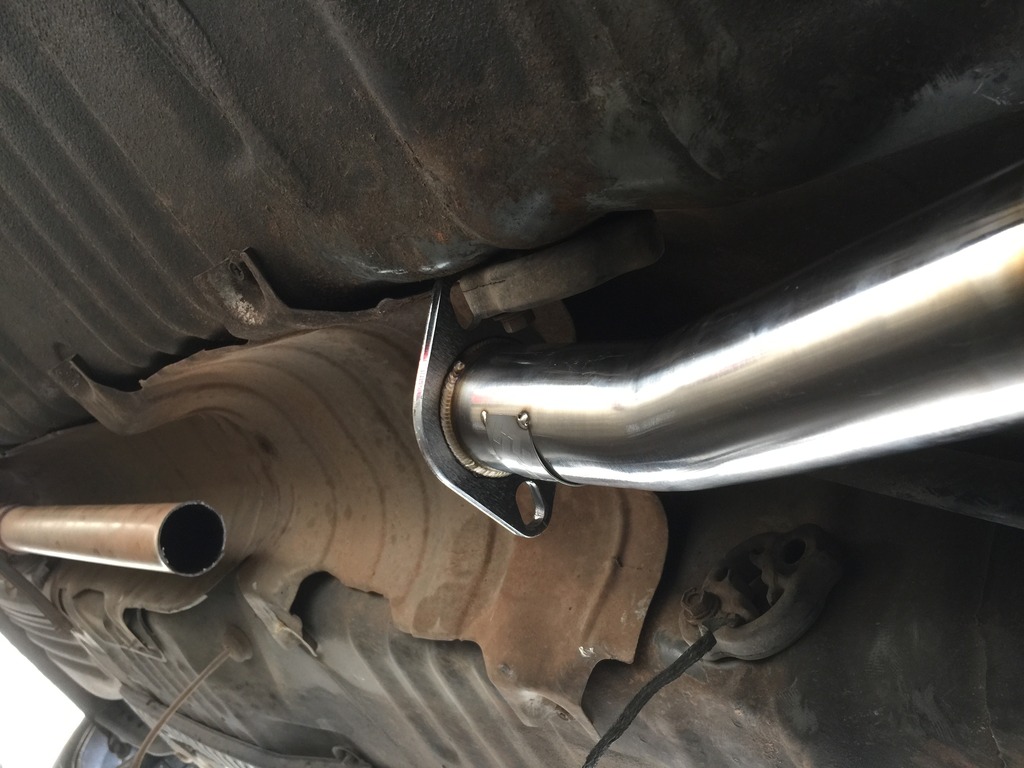

Roachjuice's Avatar
Joined: Dec 2014
Posts: 82
From: Owasso,OK
Ok. So it took me a while to do this. But it did eventually go on. I had to widen the holes on the pipe for it to fit. It didn't line up but a little prying and drilling out the holes it went in. The seller sent the wrong new nuts for the 6 studs. So I had to go to lowes and get them. No big deal. M10x 1.25 is the thread pitch for the studs if anyone cares. I also had to cut my cat off because the bolts were so rusted that they broke off. So I decided to just cut it off. I'll go to an exhaust shop Monday and have a resonator put in place of it. It's so loud open Y pipe lol.
Is it worth it? IMHO. Yea. It is. If your mechanically inclined and know what to do of stuff doesn't line up correctly. It's close. But it's no bolt up operation. For the 50 dollars I paid for it I say it's worth it. But buy what you want. eBay or warpspeed. It's your choice.
Again. This headers and Y pipe kit I just used the Y pipe out of the kit.

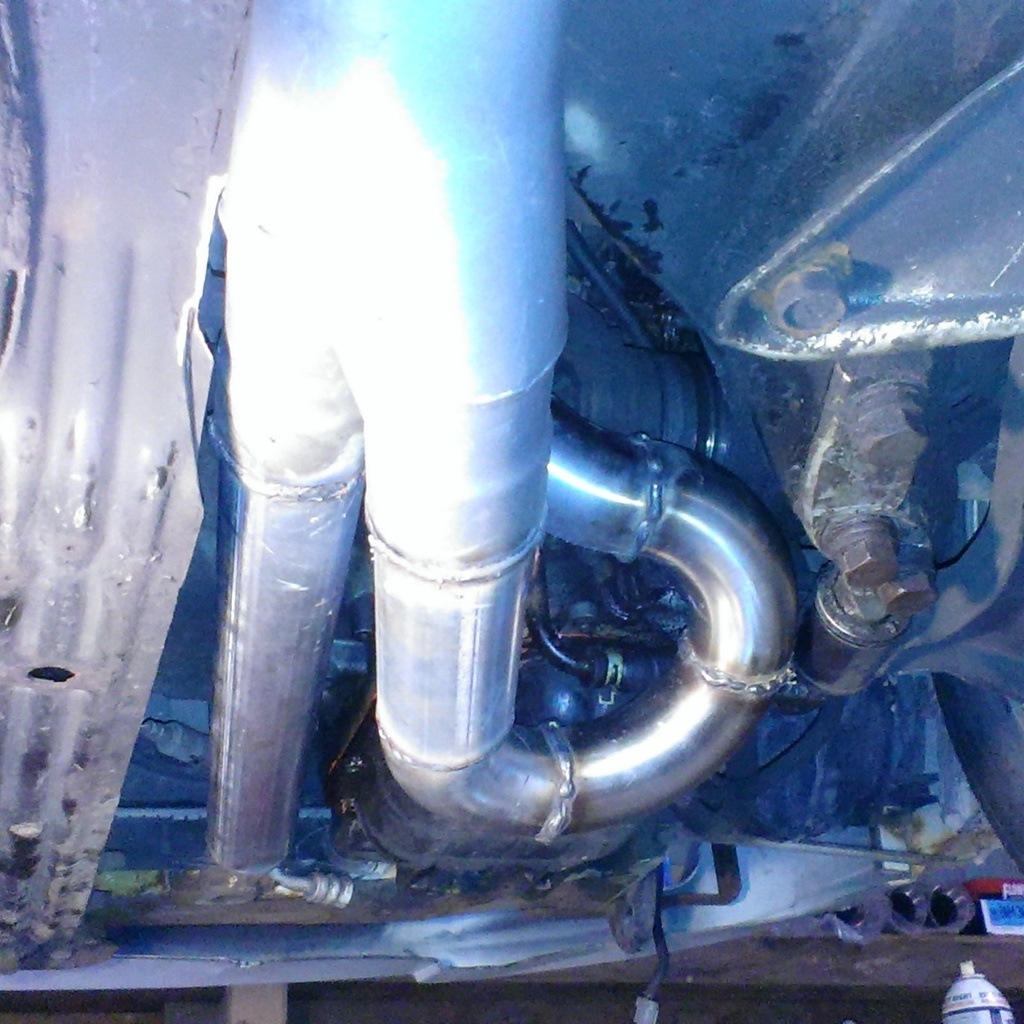

Little update on my exhaust.
You can feel a power difference. Pulls way better up top.
It was loud. I'm not running a cat. Went through 3 different exhaust setups this week.
First was straight pipe to a fart cannon (it was already on the car when I bought it and didn't sound half bad) well that was way to loud and had TONS of rasp.
So I chopped it off and got a thrush turbo muffler. Still rasp city. But quieter.
Ordered a 18in resonator and put it in where the cat went. It didn't seem to do anything.
This morning I got up and went an bought a 25in glasspack. Thrush cherry bomb. 3.5in round body. Cut that short resonator off and stuck the big one one. Huge difference. Lots better sound. Still a little poppy but meh. It's alright.
