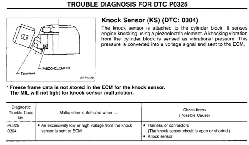

The knock sensor will NEVER trigger a CEL.

Where do you get this crap from. A bad knock sensor will cause the ECU to pull timing advance all the way back, it will not limit RPM, only a bad MAF will do that. I have had a bad KS and I assure you, shifting at 7,000 RPM was possible.
Stop spreading misinformation.

Clean or replace the EGR and the KS code might go away. $5 KS from ebay works great.

Plugged EGR can cause running hot and cause pinging, you should clean it or fix it. Doing that may clean up the knock sensor code as well.
Check the stickies for EGR cleaning. Don't buy new yet.

EGR stands for Exhaust Gas Recirculation. I sends exhaust (in inert gas) into the combustion chamber to lower chamber temperatures. Without it you CAN get some pinging and that is not good for the engine or performance. Crappiest part is that the KS will back off timing so you'll never here the pinging, you'll just lose power.
It's up to you man, some people delete them altogether. I would just try to clean it and then go from there.

You're over thinking this stuff. All your issues are easy to fix.
First, clear your codes and see if they come back. If they do, address the EGR issue first by cleaning the tube first. More work/troubleshooting may need to occur (like replacing the EGR valve) if the code still remains.
After the EGR code/issue is resolved, clear your codes and see if only the KS code returns. If it does, replace it. If it doesn't come back, you're done. The KS is often a piggyback code.
You have a 97, therefore changing the KS is a piece of cake and is a 20 minute job. Tell your mechanic he's crazy; he must be thinking of CA spec 99 Maxima.
DO IT YOURSELF. There are videos on Youtube and writeups and pictures all over the Org. Try the KS that you have, even though you dropped it. If you install it and you still have the KS code, buy a new one off of Ebay.
Regarding the airbag issue, are you saying you have side airbags in your seats? I thought that started in 98...
Any way, start by simply erasing the airbag light by this procedure.
Open the driver’s door. Note the rubber covered button located low on the B pillar, a button which is pressed by the door when the door is closed. This is the Driver’s Door Switch (DDS).
Turn the ignition from OFF to ON. Press the DDS at least 7 times within 7 seconds after turning the ignition switch ON. Turn the ignition OFF. Close the driver’s door. Start the engine.
If the airbag warning lamp is still on (or still flashing), there is a fault in the Supplemental Restraint System which must be diagnosed and/or repaired.
If this ^ doesn't work after a bunch of attempts, then simply unplug and plug in the airbag connector (with the battery disconnected for at least 10 minutes) several times to remove any film/buildup from the connector. Then try the above procedure again.
It may keep the flashing airbag light away for good, for 6 months, for 6 weeks, for 6 days..... you won't know until you try it. Of course it couldn't hurt to simply unplug and plug in the airbag connector (with the battery disconnected for at least 10 minutes) several times to remove any film/buildup from the connector.

Old Mar 29, 2015 | 12:20 AM
Originally Posted by vqmaxman
I have had the knock sensor code trigger the light to come on and the code was able to be pulled, I had no other code there.
That's

Don't believe it, but it happend the ecu and knock sensors communicate to throw the p0325 code nissan made it happened. The code comes on when you wot it and when the car kicks into limp mode.
Old Mar 29, 2015 | 01:21 AM
asand1's Avatar
Joined: Jun 2009
Posts: 3,942
From: Reedsport, OR
OK dude, NISSAN, I, and the rest of the world are lying.
The ecu does not suddenly pull timing when you go WOT with a bad ECU, the timing was never there to begin with. You know less about Nissan, and cars in general than you think you do. Please don't pull "Facts" out of your a$$ and share them with people, it is a disservice to everyone who comes to the ORG for help.
Sent from my XT1060 using Maxima
Sthp...dude you apparently Don't know anything about cars, apparently I know more than you, I am pulling nothing out of my tale. I worked on them more than you every could think of working on cars. The info you are stating is clearly wrong your giving misleading info about cars. The ecu doesn't sense the sensor knocking and kick it in limp mode. The code doesn't come on for ks and the ses light don't come on. Dude get off that shiz you on or don't post.
Now you're contradicting everything you previously said. How many years did you spend as a professional mechanic and as a dealer mechanic as I did? How many ASE certifications do you hold?
If you had a CEL on it was for something else. It will not trigger a light on its own. I took that image right out of the FSM. I have had a bad KS with no other codes, and the cell did not come on.
the knock sensor will show when you scan, but will not trigger a c/e light as it's a ghost code.
