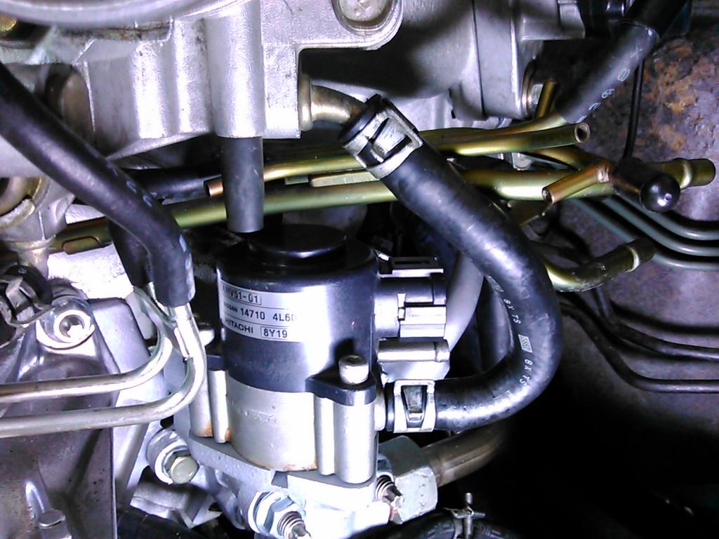

At roughly the same mileage, I experienced an EGR failure on my 99 model. It behaved like a vacuum leak. Initially it did not through a code. It took some time to find the issue. The 99 model uses an electric EGR.
If you continue experience EGR problems and need to replace yours. I can tell you that I replaced mine with a Standard Motor Products (SMP) Intermotor brand that has been running for over a year without issue. I noticed the SMP INtermotor uses the same Hitachi electro-motor part as the OEM.
STANDARD MOTOR PRODUCTS Part # EGV616 is $120.79 at RockAuto.
Advance Auto Online sells an Intermotor brand for $92.99 using the online discount code of TRT41. I bought mine at Advance. Be sure to check the replacement and make sure that it uses the same Hitachi electro-motor part number as the original.
Here's a picture of the 99 model electric EGR below.
