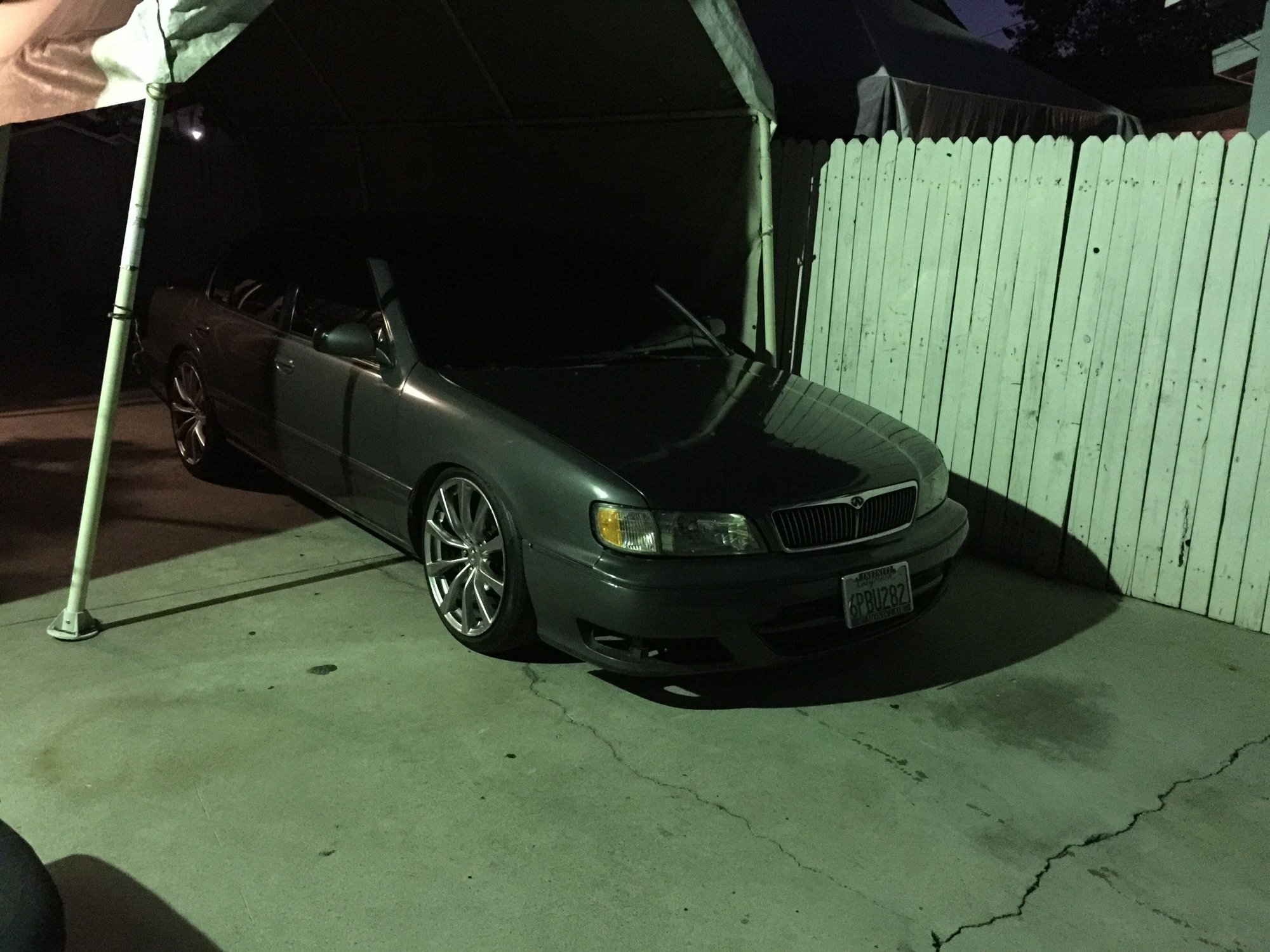

Going to put the tps and iac sesnor on hold because those were not wet but if all fails will check those. Lol water was not two feet it was about almost as high as a sidewalk and my car is dropped about 2 inches. Im going to check my cam and and crank sensor tomorrow. Yea dont have intake so no worries there. So say if my alternator were to have gotten wet is there any way that the alternator would still be functional after? Appreciate all the suggestions u guys have mentioned.
Pic of how low the car is

that is one clean I30, I like the color..considering how low you are, you have no fender gap. so yeah i can see why the rain could be an issue..hope you find out the solution, and when you do.. tell us! don't leave us hanging lol
