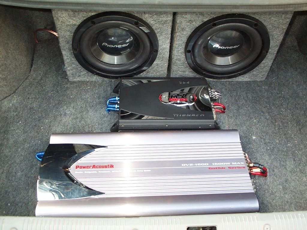

- sound system

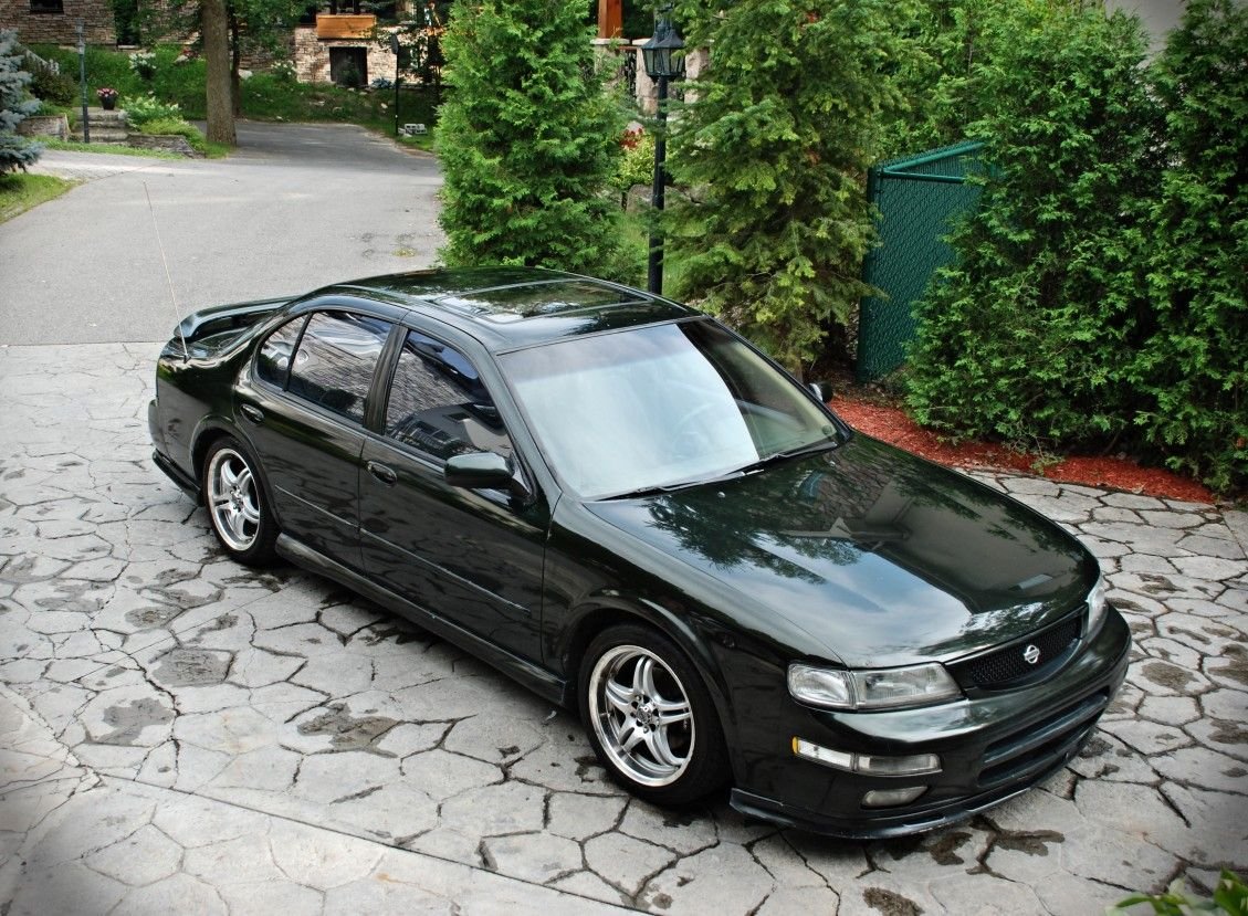

Finlay, some 2014 shoots, few days before the scrap yard. Last wash, last wax, last ride... :

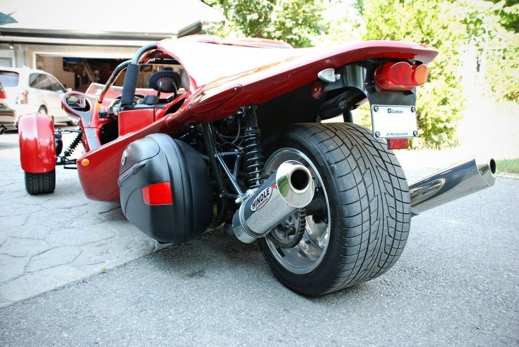

Oh yeah, technically, the Wagon is my 3rd car, not the 2nd.
I bought a t-rex and keep it 2 years. I had to sell it because wedding + house .
This was true love! I miss it everyday on my life. Getting my $$ together to get a new one with the 1400 kawasaki engine.

The firefighter told me it start from the sound system. But that wasn't true. Even when they flood the trunk, the 2 amplifier still working today. Even the subs are working. They are little bit burned, but still working.
The fire came really on the back driver side. The fuel pump module was destroyed when I clean the car. That is my guess. I had a new spiral grid battery, the voltage might be bad...

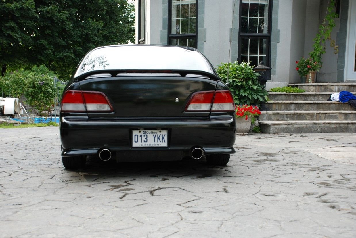

Since I got few PM about my exhaust, here what I did.
first you have to cut the spare enclosure. Then weld a metal plate to cap the hole.
Then I bought a G35 exhaust. The intake is from the left side since our car the B-pipe end on the right side.
So I made a custom 2.5'' pipe. Maybe 3 feet long, 2 90° elbow.
I weld rod on the muffler to fit the oem exhaust fixation.
On the left side I add a rubber to attach the left side muffler. The attach is simply bolt in a hole already there on the car.
Muffler cost me about 200$ used back in 2006.
3' custom piping cost me 230$.
And the rest is a lot of time because I did the rest my self. I have a welding machine and I had metal sheet scrap in my garage, so cost me not that much.
