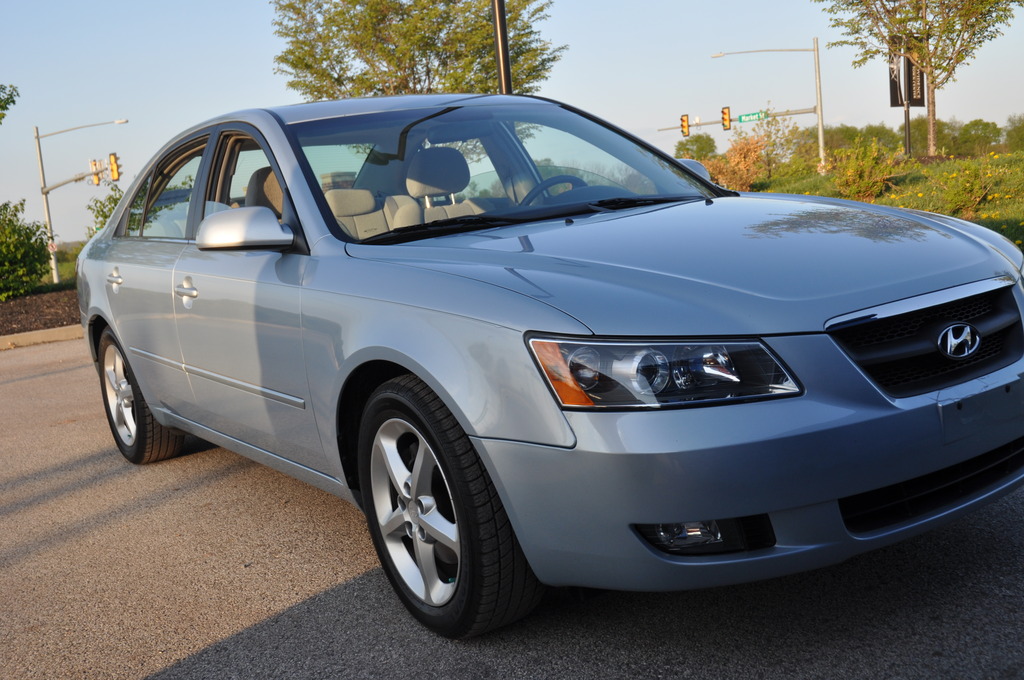

ha, u funny josh. what r u like 24? i have 280,000 on this car and she still runs great. and jvg, i wish i had the money and time to do all 6 injectors, or all 6 coil packs, but its true. if aint broke, i won't fix it cause the cars not worth the money to me. i keep it running and check all fluids constantly including any codes that pop up i fix asap. cars not worth spending all my hard earned dough on, trust me, i've spent a boatload already. o, and i have another car, here she is...
