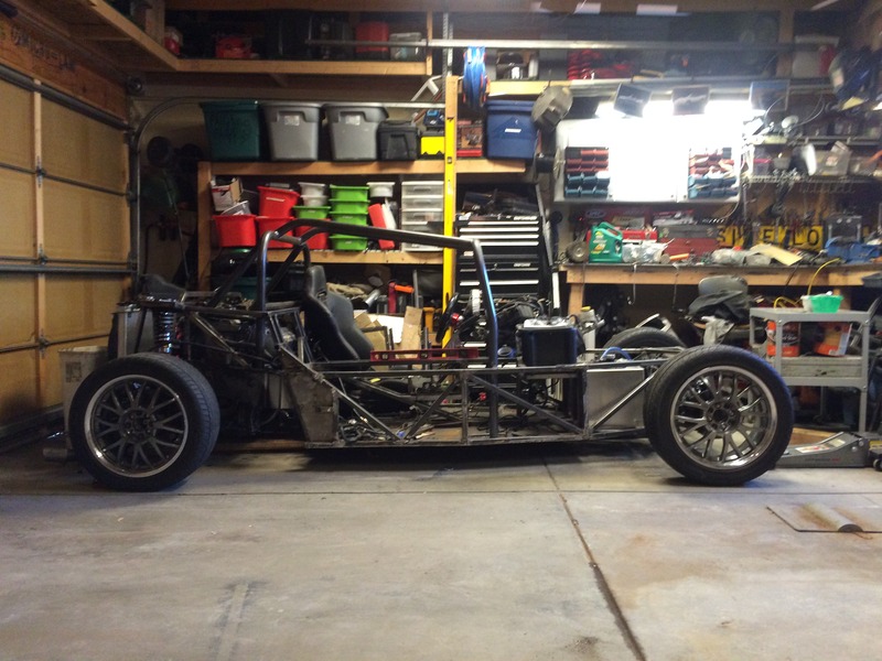

I have a project I am working on. It's a locost 7 that has a mid mounted vq30 from an Infiniti i30t auto. I want to change the trans to a 5speed with lsd. I und Rostand I need to find an ae? Maxima for the lsd.
I since my auto trans has an lsd can I swap it into a non lsd 5speed and just change the ring gear? Are auto lsd cv axles the same as 5sp lsd axles?
Thank you
Evo
