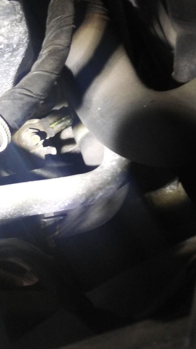

My alternator took a s*** 2 days ago so today i went out to the car to double check all the grounding straps and came of cross a few drips of coolant around the engine ground cable
Small drop
Couldnt get a better picture but there is some coolant on the cable terminal and some around what im guessing is another radiator hose below the one you see on top
The hoses arent in the best shape nor the worst. But is this just a hose swap and im good or is there something else that could be dripping
Sorry for the poor post. I had i mich better post going but my phone decided to close it out and frustrate me so i made this one short and sweet

While I know this car quite well, I can't place what part of the car I'm looking at.
Hoses should be replaced when possible. Better now than when it decides to go out unexpectedly. It is 20ish years old, after all.

Just looking at the hose clamp and condition of the hose around it in the 2nd picture, I think you are in for some new hoses sooner than later.

This is on the right side by the battery and upper radiator hoses ..car has been worked in yet so crap alternator is still in there.
Today im going to pull the alternator and swap it with one from my other maxima and plan on replacing hoses while i do it. Thank you
Having trouble finding exact names of the hoses any chance you have a diagram or could name them by location ....im guessing
Upper and lower radiator hoses
There is a small elbow hose underneath the upper radiator hose
And i can only assume the hoses towards the firewall are the heater hoses

There is upper radiator hose, lower radiator hose, and the elbow heater hose that connects to the pipe that runs across the front of the engine.
