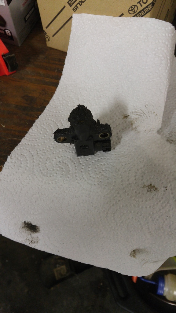

To keep problems away, I try to clean mine every 3 years. Though the front gets a visual with every oil change. I clean the sensor ends, then clean/check the electrical connections, and lubricate with a small amount of dielectric grease.
The rear sensor will usually have a couple of metal fragments from the starter gear wear. The front may pick up some random road grime.
