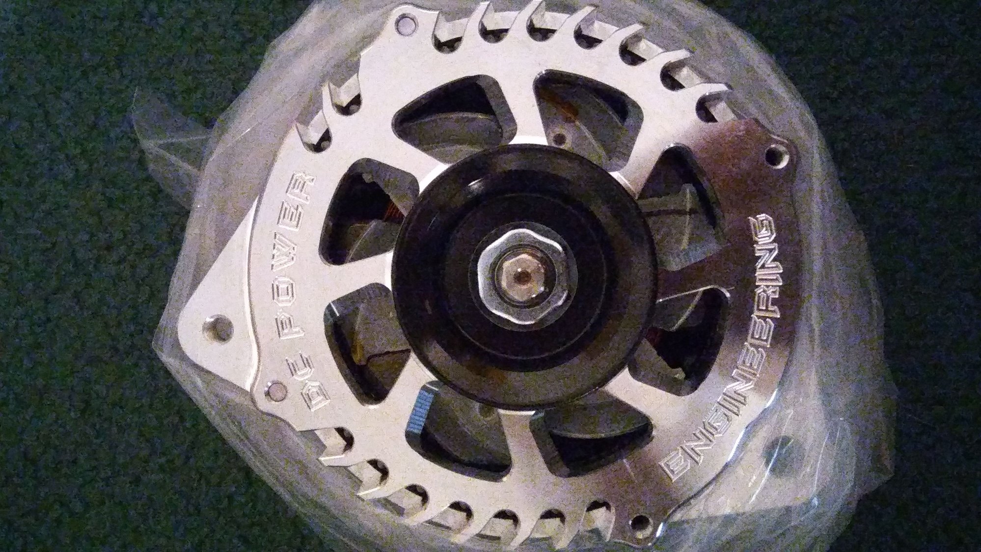

Alright so my stock alternator gave out about a month ago, which gave me an excuse to buy something ive had my eye on for awhile, the DCPowerInc 270amp high-output alternator.
After reading countless reviews and forums about the company and the product for the last 2 years I found this to be one BAD*** piece of equipment that would have no problem powering my audio system.
My system isnt insane, 2 1200watt 12 inch sony xplods running of a kicker kx600, and 4 pioneer a series speakers running off a mtx thunder 204.
The only issues i had up until the stock alternator gave out, was the subs would cutout at 3/4 volume if it got bass heavy for more than 4 seconds (this didnt bother me a whole lot considering i rarely drove around with the volume that high for more than a few minutes, and the subwoofers werent turned on most of the time anyway, only when i wanted).
Long story: my alternator gave out on me on a 2 hour drive home from work. Got the car home swapped it with a spare stock alternator i had. Put the charger on the battery to get it back to normal.
At this point i contacted DC Power Engineering about getting a new high output alternator and ended up putting the order in right before thanksgiving. Next day took the battery off the charger tossed it in the car and started it up, everything ran fine i checked the voltage off the battery and was pulling between 13.6and 14 volts with the engine running. I checked this every morning and night after and before driving . i also checked the battery after shutting of the engine everytime and it started at around 13.2 (after it was charged) and eventually dropped down to 12.6- 12.8 after a week and eventually stayed in that range since.
Now that seems perfect to me except i feel like the alternator is going to give out like the last one.
'Radio has not been hooked up since the alternator was swapped'
Symptoms:
Alternator squeals on several different occasions
1. When any accessories are turned on
2. When i hit the brakes ( stopped or in motion)
2a. The headlights will also dim when i hit brakes
3. When accelerating
Now after about a month of driving the car very sparingly without the radio hooked up, my new
DCPowerInc 270xp highoutput alternator has arrived.
These claim and have been proven to give up to 200amps at idle, which is more than i may ever need.
Unboxing:
The alternator came packed really well.
Appears to be heavy duty and high quailty
Alright now hopefully i can get some decent weather this weekend, so i can toss this beast in the car.
Thanks for reading ill keep this updated through the process and let you guys know how it goes.
If anyone else has had any experience with highoutput alternators or DCpowerInc themselves and has any suggestions or anything , id appreciate the knowledge.
