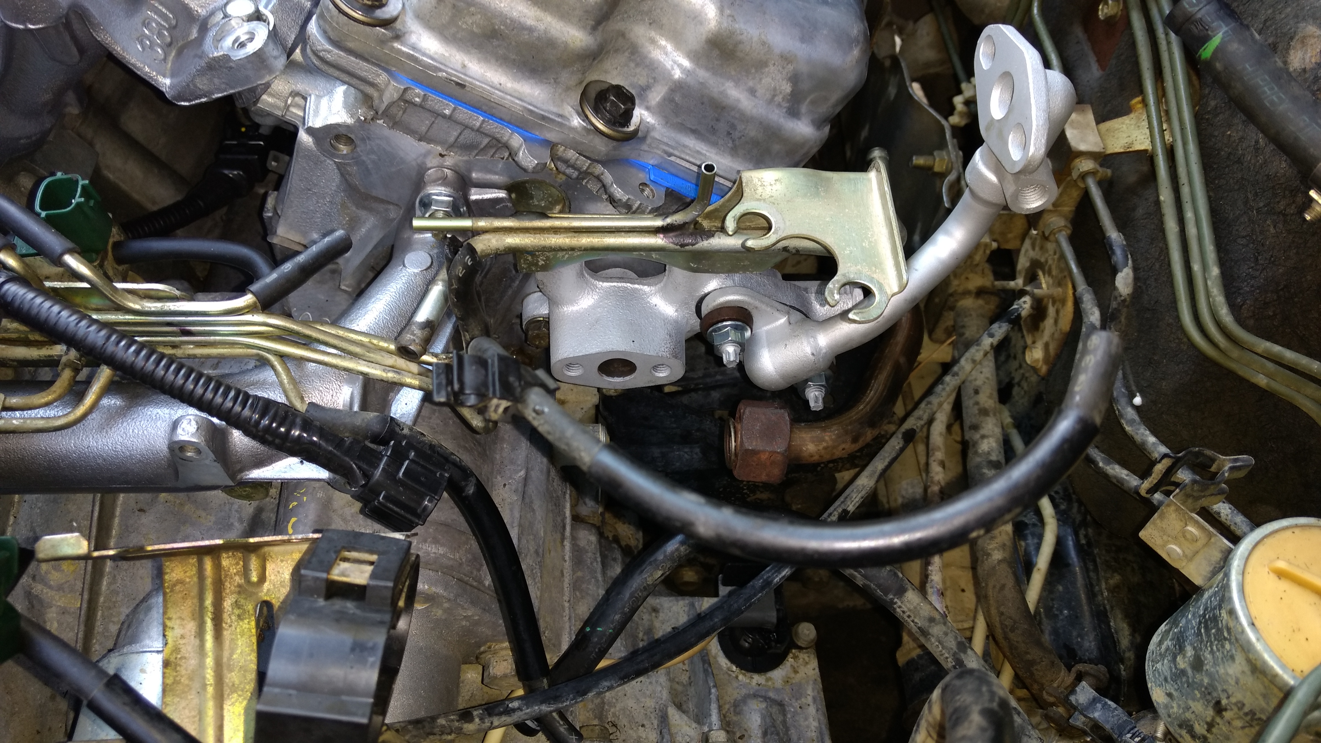

The EGR gaskets are mounted on the silver looking tube and mounting assembly in the picture.

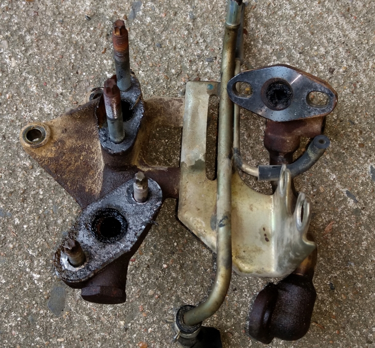

Here's a picture of the EGR parts before cleaning. Over time, the tubes get filled with carbon and clog.

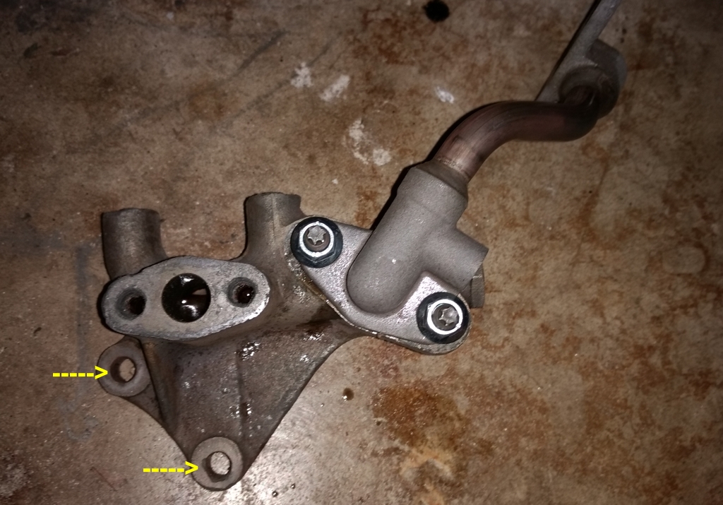

If you decide to do the EGR cleaning job, you will most likely remove the UIM to clean the EGR port that connects to the EGR tube (upper right) in the picture.
Here's a tip for easy EGR removal and re-installation in the picture below.
After I loosen EGR valve bolt nuts and exhaust connection pipe, and loosen the nuts that hold EGR tube to the mounting assembly, there are two hard to see 14 mm bolts on the bottom of the EGR assembly (yellow arrows) that I remove first.
Once I remove the two 14mm bolts (yellow arrows) that hold the EGR mounting assembly to the engine, then I can swing the rest of the EGR assembly away from the engine and tube without much effort.
BTW 97_GXE - That's a good looking Y33 interior you have in your signature line.
