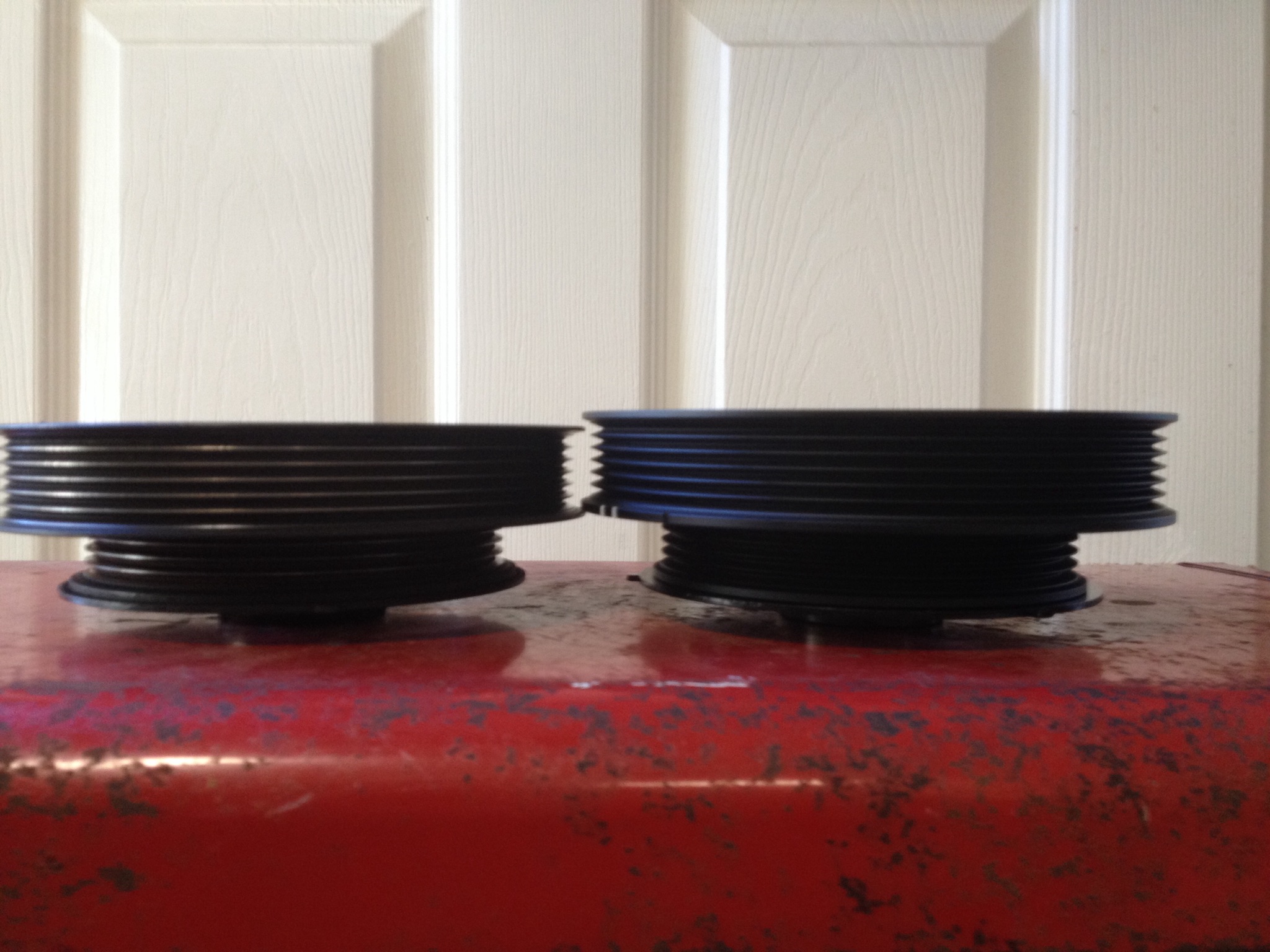

Attached is a side photo of the original pulley (left) and the new pulley(right). It's obvious the outer pulley shifted inward and that caused it to rub against the power steering belt, hence causing the noise. I guess you can expect this from an 18+ year old part. Thanks again to all org contributors who shared their knowledge, and allowed me to troubleshoot this issue.
Good to see you are running again. I had one separate about 5 years ago on the 99 I30 at roughly 225,000 miles. Since then I started replacing them as a mid-life maintenance item along with rubber items like belts and hoses.
