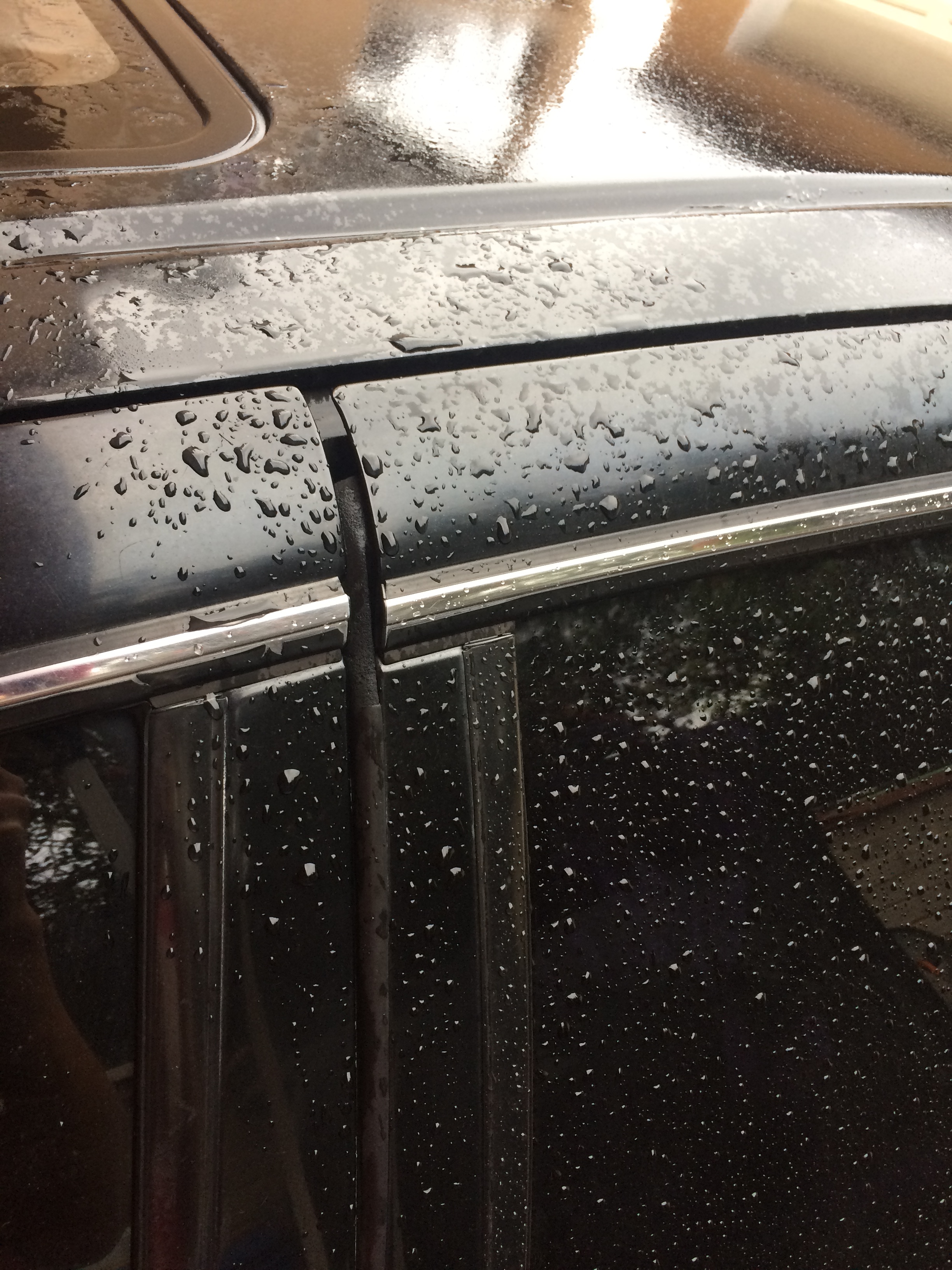

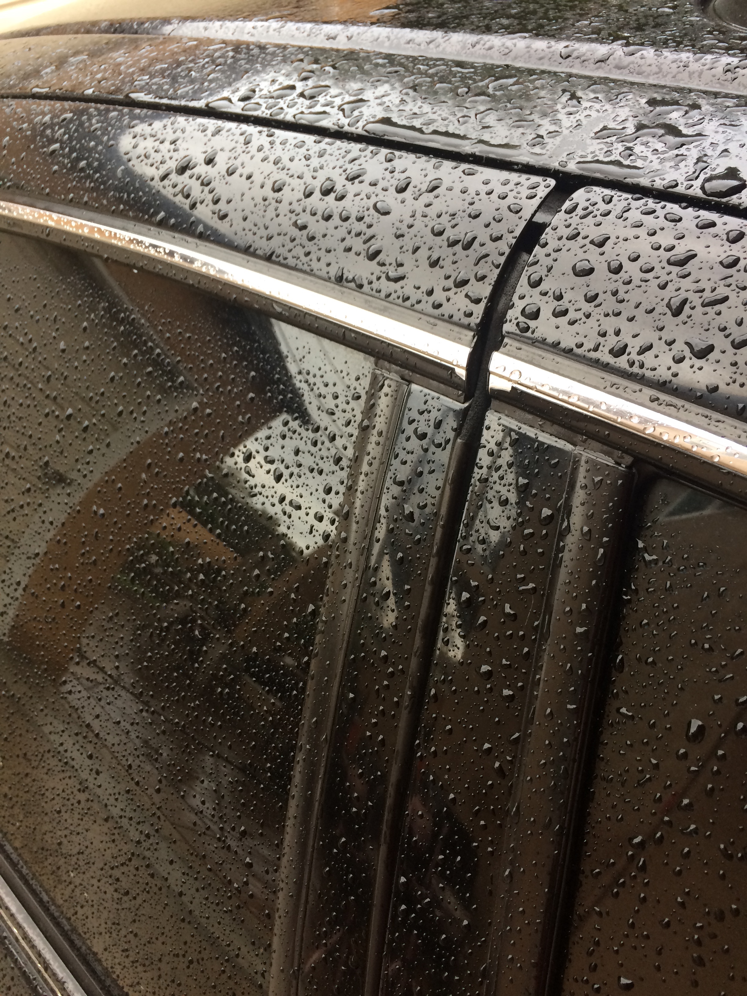

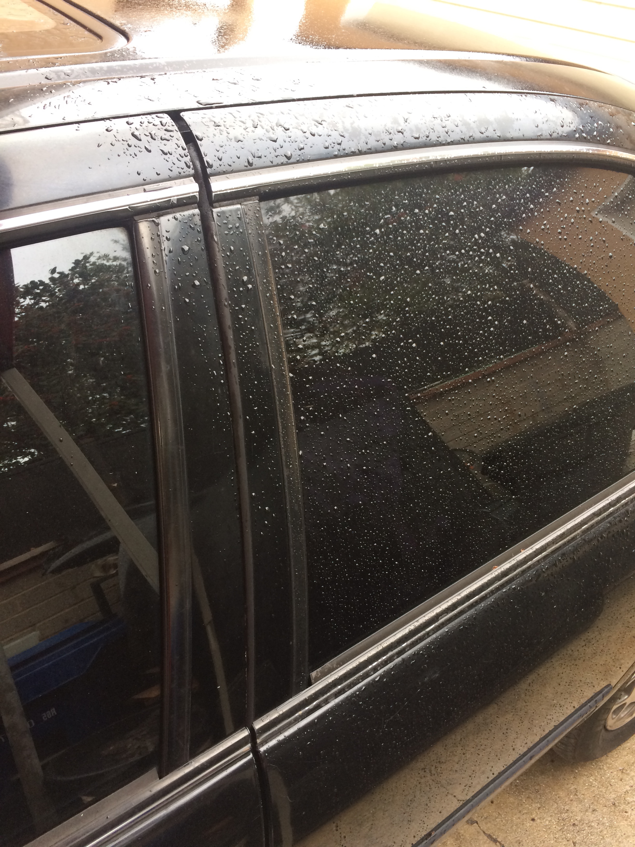

Does anyone have a solution to fixing saggy rear passenger doors? I was thinking about going to my local salvage yard to pick up some new hinges, but first I would like some insight from the Maxima community. I will have pictures attached below.
It could be either the full hinge that needs to be replaced, or else just the pin may need to be replaced. or else a bushing that the pin goes through in the hinge. Or, if you;re real lucky, you may be able to just adjust the hinge.
Good luck.

Did you try adjusting the doors hinges at the B-pillar?

Yeah, I got the SRSCU situated. Went to the salvage yard and found one that didn't have a hard code on it and simply plugged it into my vehicle. Also, I did have to use the door reset method to get it to work.
And yeah I think my rear passenger doors might need some hinge work because my pillars aren't damage and neither is my unibody.

I saw a trick on here where washers were used to space the door hinge so you didn't have to slam the front door from worn out hinges. You can probably find it if you look for door sag. That or junkyard hinges are probably least expensive.
Years ago, my ex wife had a Chevy Monza, and it started with the sag thing. Ultimately to my surprise, it was little plastic grommets that went into one side of each hinge that buffered between the hinge pins and hinge holes. When they crumbled, they gave enough slop for the door to sag and closing and rattle was miserable. Cost a couple dollars at the dealer.
Maybe double check that isn't the case here and the plastic grommets aren't crumbling. Hope this helps!
