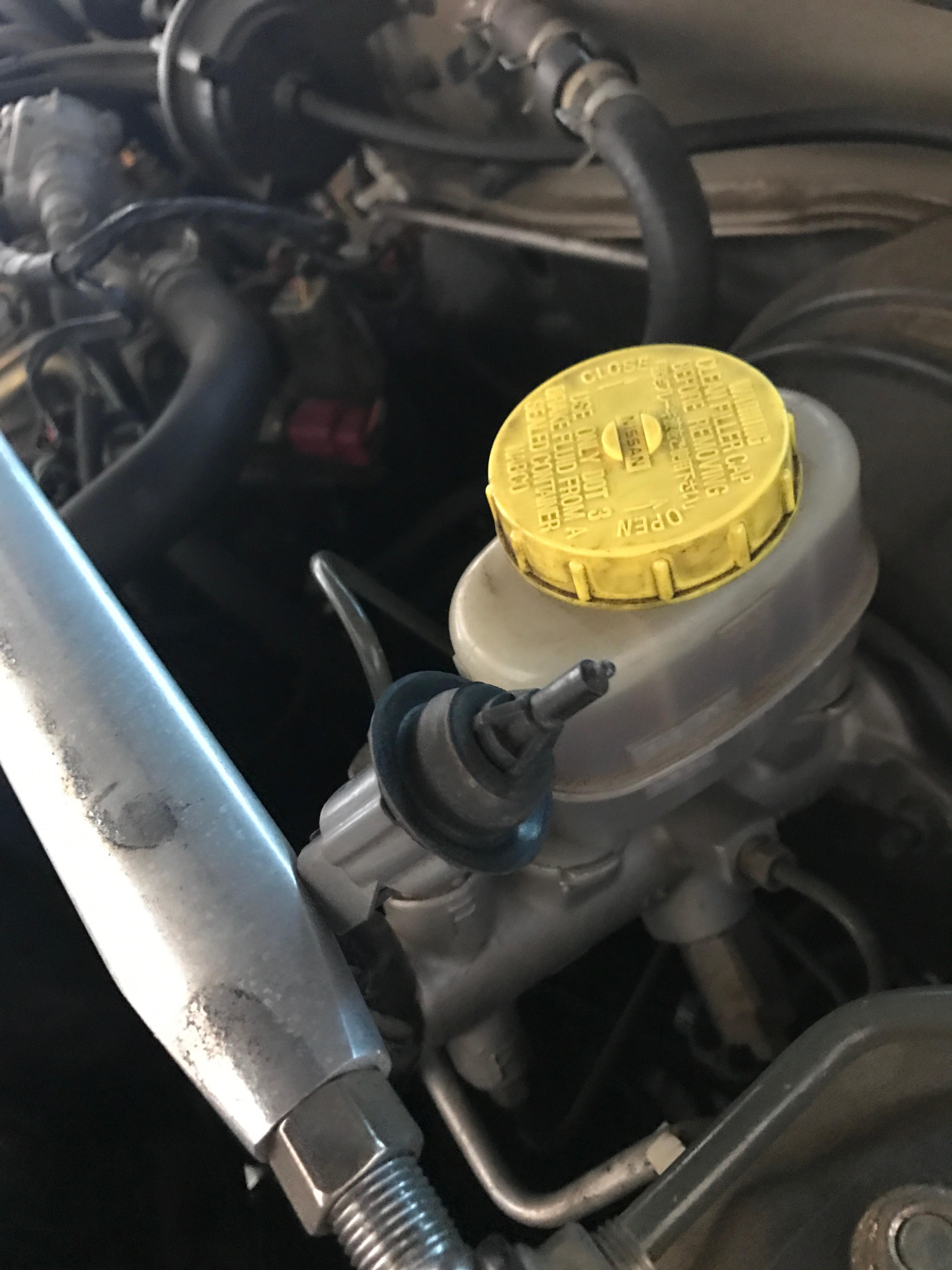

Can someone tell me where this sensor plugs in the engine bay?
I noticed this sensor hanging out in the engine bay when I replaced my MAF today. Where is this guy supposed to plug in and what is it? Thanks!
Attached Thumbnails Can someone tell me where this sensor plugs in the engine bay?-maxima-sensor.jpg

That is the intake air temperature sensor. It plugs into the air filter box on the side towards the firewall. Look for the opening and plug it in.

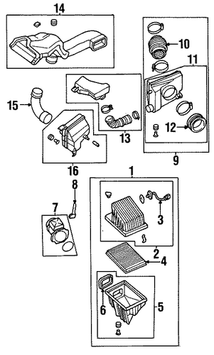

But ... I can't tell from the looking at the components in the background of your photo what year your car is.
I know that in a '99 and I think in a '98 the IAT inserts into the elbow of the air intake snorkel (#14 in the illustration).
