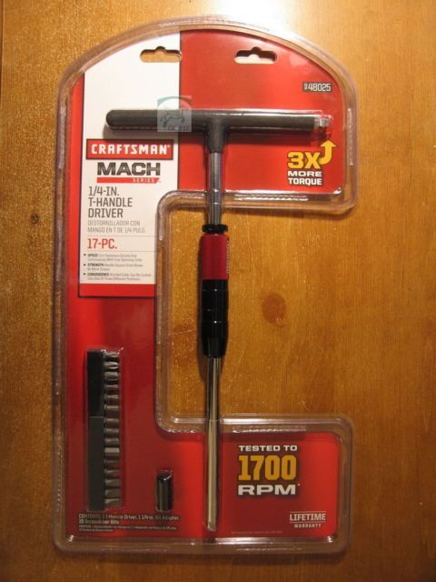

I used the T-handle and extractor after I was struggling and drilling. (I went out and bought them during the swap)
The Craftsman Mach T-Handle screwdriver and the Craftsman screw extractor are awesome!
The T-handle is actually long enough to get both of your hands on it, and it helps you get enough force to push on the screw to get it off. At least 2 screws were able to be removed without stripping, thanks to this thing. Again,

T-Handle
