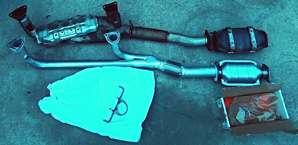

After 3+ years of use, I had to drop the Warpspeed Y-Pipe to remove the upper oil pan. In looking at the area where the header ring seals were originally installed, it appears the seals have now become married to the Y-Pipe. So I'm beginning to doubt that I can remove the old seals to install replacements.
Has anyone used Permatex Ultra Copper RTV to reseal a Warpspeed Y-Pipe to the exhaust header?
Here's a picture where you can see the groves in the new pipe header fittings below where the ring seals should be mounted.

Craig ... I personally have never been a proponent of using a chemical gaskets in exhaust applications.
Although "physical" exhaust gaskets can and do fail, I've always felt that chemical seals have a much shorter life expectancy and tend to deteriorate much faster than a proper material gasket.
I've only used chemical gasket material in an exhaust application when sealing (sandwiching) two material gaskets together.
If I'm understanding your situation correctly, what I might do is either purchase or cut replacement gasket material for your Y-Pipe surfaces ... just buy or make 4 of them.
Use your preferred chemical gasket material to "glue" two of the material gaskets together.
Use the double gaskets to seal the Y-Pipe flanges to the header/manifold flanges.
This method provides a bit of "cushion" so that imperfections (marred or toothed surfaces) in either/both mating surfaces can be sealed.
I used this technique in the truck with success.

Here's the final solution. I must have had a small exhaust leak around the collector. I could hear a slight exhaust hum that I attributed to the lack of cats. That noise want away today.
I wanted to get a triangular shaped gasket like the one in the picture above. So this morning I took an extra header that I have in the workshop to O'Reilly Auto to find a match.
Luckily the guy working at O today is someone I've been buying parts from for years at Advance Auto. He said I will not have a ready made gasket to fit the Nissan collector. The stock Nissan collector gasket uses a metal ring type seal. No argument from me on that point. My problem was the ring type gasket has become part of the y-pipe flange.
I purchased a sheet of "Mr Gasket" exhaust gasket material and fabricated my own gaskets. Once I had my homemade gaskets ready to install, I applied a thin coat of Permatex Ultra Copper Exhaust RTV to smooth out the mating surface.
I replaced the 14 mm exhaust y-pipe nuts with some Brass 17 mm -- M10 x 1.25 Dorman exhaust bolts. The nuts came with studs in a package of two. So it took three packages to get the new bolts.
After I installed the new gaskets, there is no noise from the exhaust manifold area. How long will this last? I have no idea. All I can say is it is quiet now.

Thank you TB. I basically took this approach with my homemade gasket and some Permatex Ultra Copper RTV on each end.Originally Posted by Turbobink
