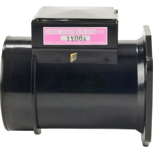

My choice would be Bosch or Beck/Arnley. They are reboxed OEM MAF sensors.
Bosch part number is 63128. I forget what Beck/Arnley's part number is.
I bought the Bosch 2 years ago, and it is still working great after 2 years/25k
Old Aug 17, 2017 | 06:12 PM
CS_AR's Avatar
Joined: Jan 2011
Posts: 3,037
From: Central AR
Now doesn't the Bosch in the link below look like a gen-u-ine Nissan JECS MAF?
https://www.oreillyauto.com/detail/b.../63128/2576832
The better deal is at this link.
http://www.myautopartswholesale.com/...il/bosch/63128
