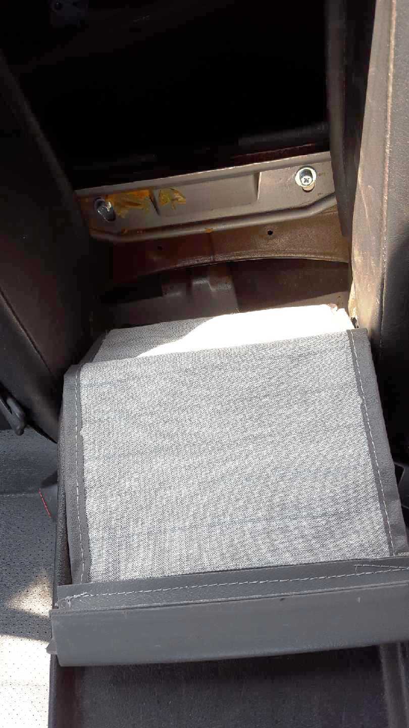

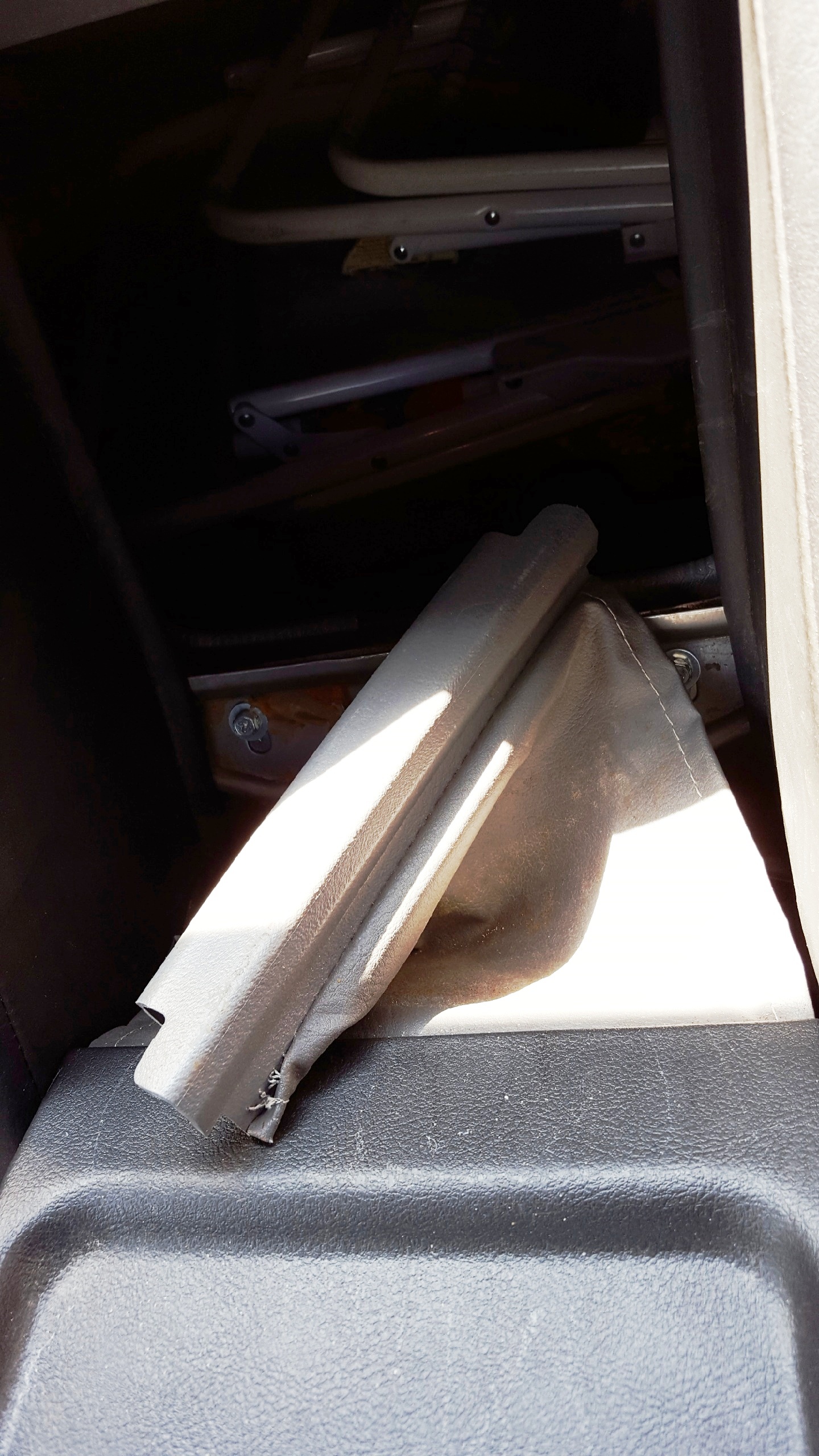

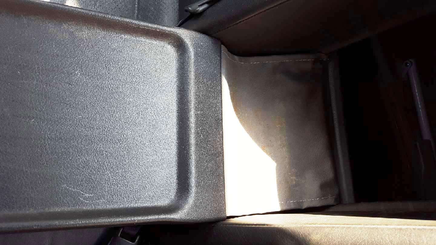

Below are pictures of where it goes. One end kind of flops into place and the other end is sandwiched into the plastic that divides the trunk and arm rest. Getting that plastic barrier out to reinstall the fabric end will most likely entail pulling the rear back seat bottom and then top to get it out to be dealt with.
Attached Thumbnails Trunk grey cover-resized_20170826_132834.jpeg   Trunk grey cover-resized_20170826_132731_003.jpeg   Trunk grey cover-resized_20170826_132819.jpeg
Old Aug 26, 2017 | 11:45 AM
KP11520's Avatar
Joined: May 2012
Posts: 1,620
From: Long Island
Also.....
I remember when working behind the seat, I thought the bottom seat didn't really need to be removed to get the top/back out. It's 4 bolts. You can see two center bolts in the third picture above. The other two are at the lower outside corners (one each), 1.5 inches below the top bottom seat. Push it down to see. All 4 bolts are 10mm. You'll have to wrestle with the two outside bolts a bit to make this work, but nothing too difficult.
Hope this helps!
