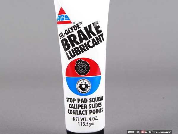

Many times when just one brake pad on a wheel wears out faster than the other, you have a problem with the caliper slide pins losing their lubrication and the caliper is sticking instead of centering on the rotor. Always check those pins when you work on brakes.
I've learned the hard way to use silicone grease (in a tube) on all the friction points (NOT where the Pad and Rotor meet, LOL) of the pads and calipers and pins and pin boots.
I use Sil-Glyde, but Super Lube has a version too.

yep same thing happen to me inboard pad down to metal and the out board pad about half .. the caliper slide pin rusted lucky got it out and trash it bought new slide pins and used sli glyde on them .. good stuff will keep the moisture out from corroding... 👌
