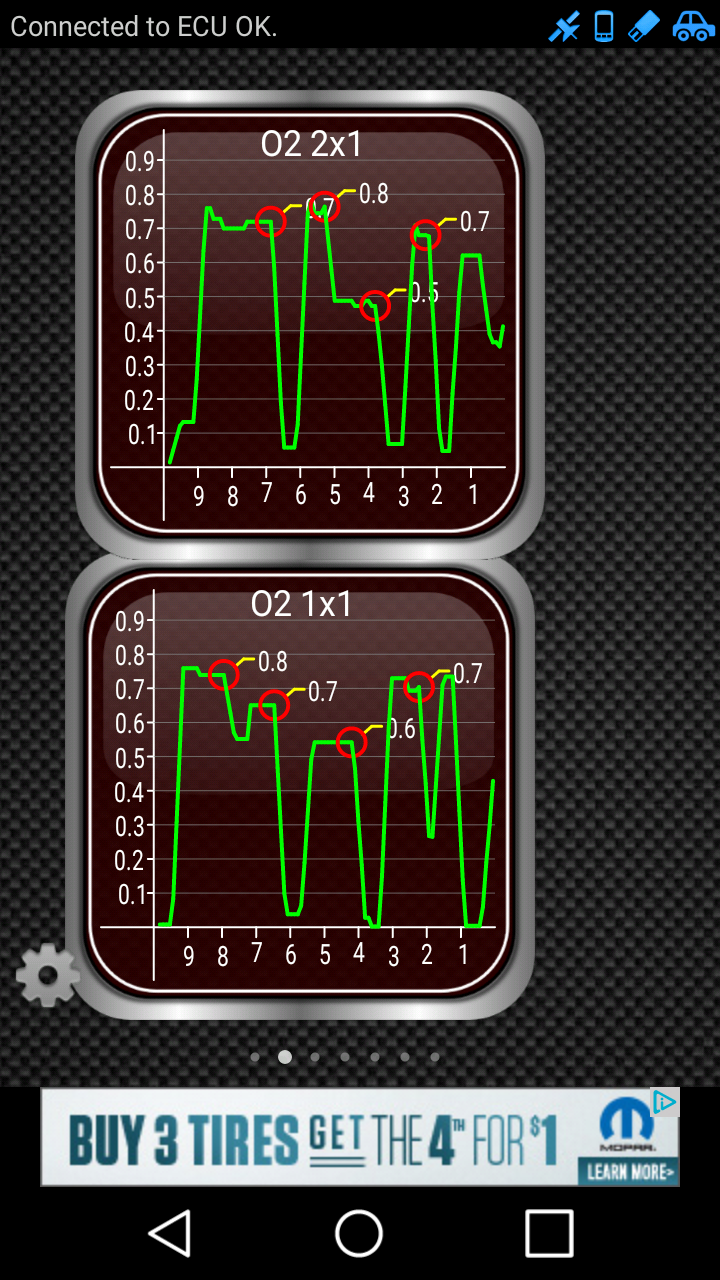

Hi all,
I'm hoping someone can help me solve this issue.
I've replaced all three oxygen sensors. I checked the wiring, and it looks ok. I've used a multimeter to confirm that the sensor is getting voltage.
I have a new y pipe, I've cleaned the MAF and throttle body, and I have a new fuel filter. I've tried three different oxygen sensors for Bank 1. I still have this low voltage issue.
On the highway, it will operate in a closed loop, but the Bank 1 sensor fluctuates at much smaller amplitudes (0.2-0.4). On local roads, it reports open loop due to system failure, and the Bank 1 voltage stays around 0.3. Sometimes it reports open loop due to insufficient temperature, and then switches to system failure.

Any ideas?
(See images)

In order to fix the oxygen sensor ground, I cut the middle black wire from the sensor side and connected it to a new ground wire. Unfortunately, that black wire from the sensor was NOT the ground wire
This made me realize that the front sensor is actually bank 2, not bank 1 (bank 2 sensor immediately failed). My problem this whole time was with the rear sensor, and I had replaced the front one three times, thinking that I was having bad luck with eBay sensors. I swapped in 2 of the eBay sensor's I had from a few months ago, and all is well now.
