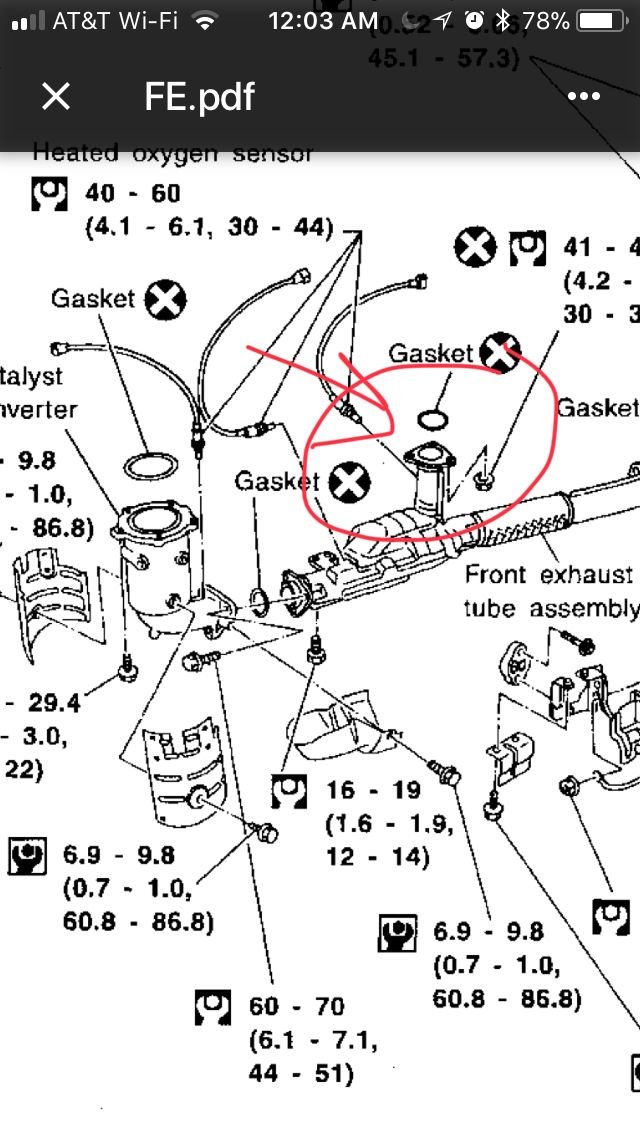

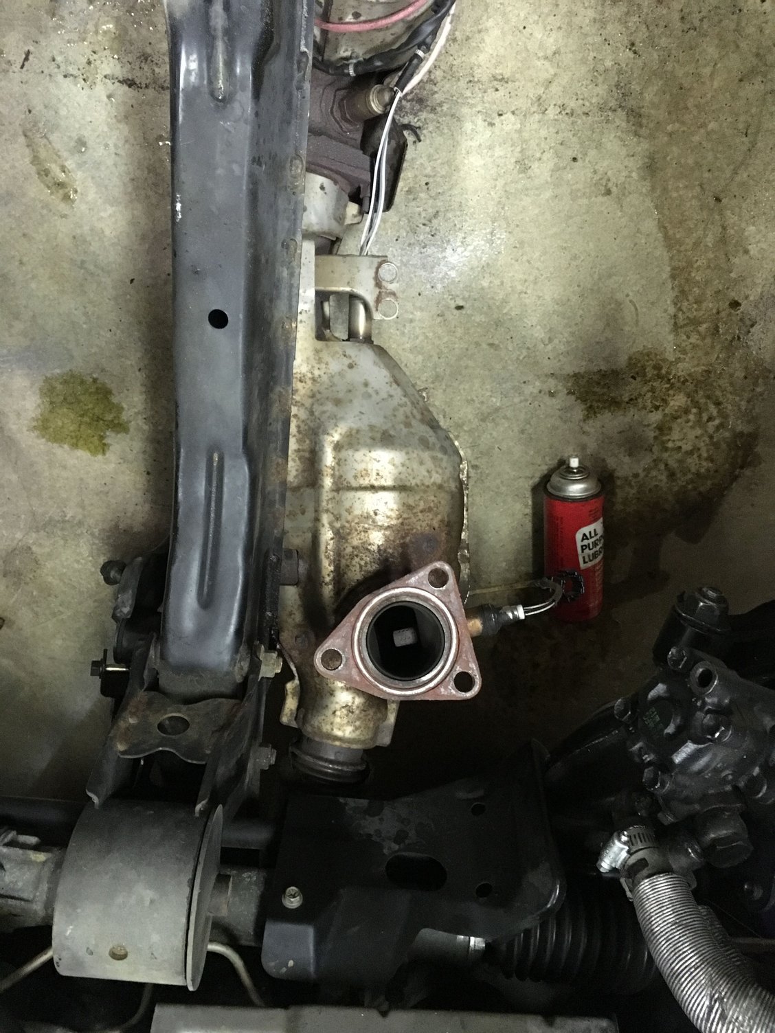

What is this exhaust gasket?
The one I picked up from Autozone was wrong... I have a Cali spec exhaust. Looking for a part number if possible!

The Nissan part number is 20691-38U00, MSRP $10.38 at the dealer.
at autozone, I think this is the one you want. It has an O.D. of 2.76 inches
http://www.autozone.com/gaskets/exha...9_451315_26534

This is the ring gasket for the y-pipe. This sits on the flanges where the rounded grooves on the pipe are on.
