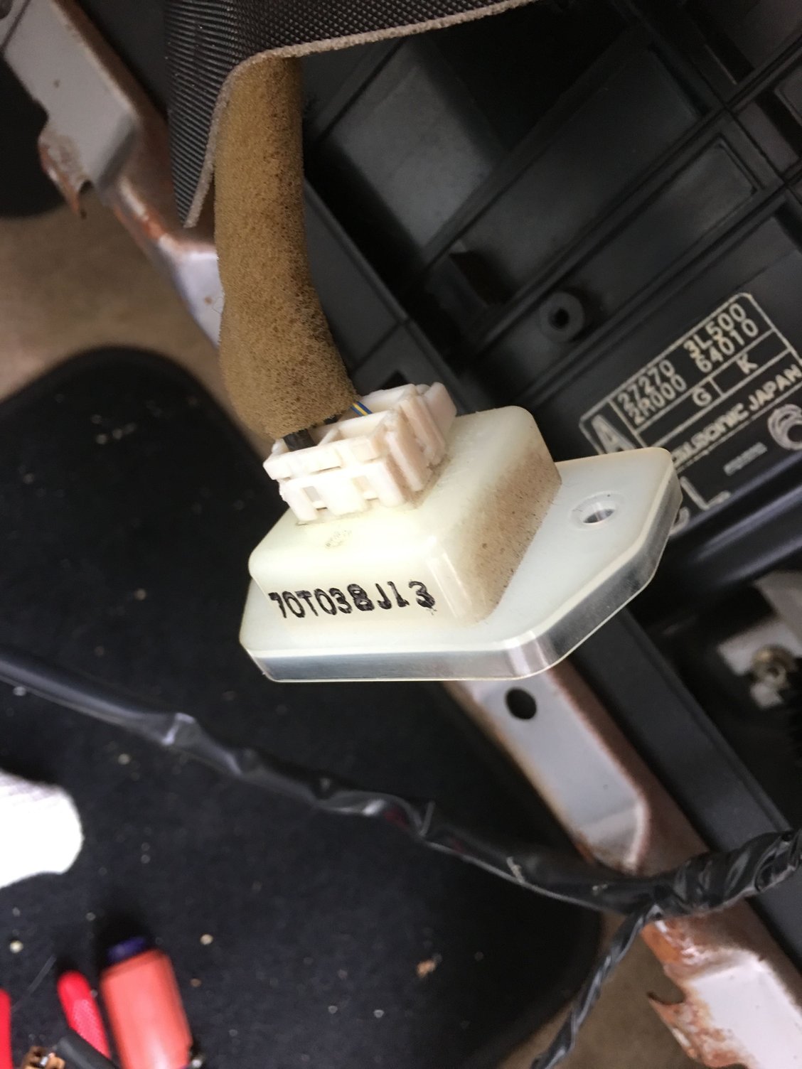

This the top part I’m replacing the resister .. we’re is the auto amplifier at ? Or does this part do the same thing?

That is the fan control amplifier for the auto HVAC system. The 2 units look different, the resistor for the manual system is more of a straight line design than a square.
You have to tell the parts place that you have the auto a/c controls and hope they give you the correct part.

The dorman part is exactly what I order .. plus it called a blower motor control Module /resistor got be same thing .. just Nissan names it a blower amplifier..
