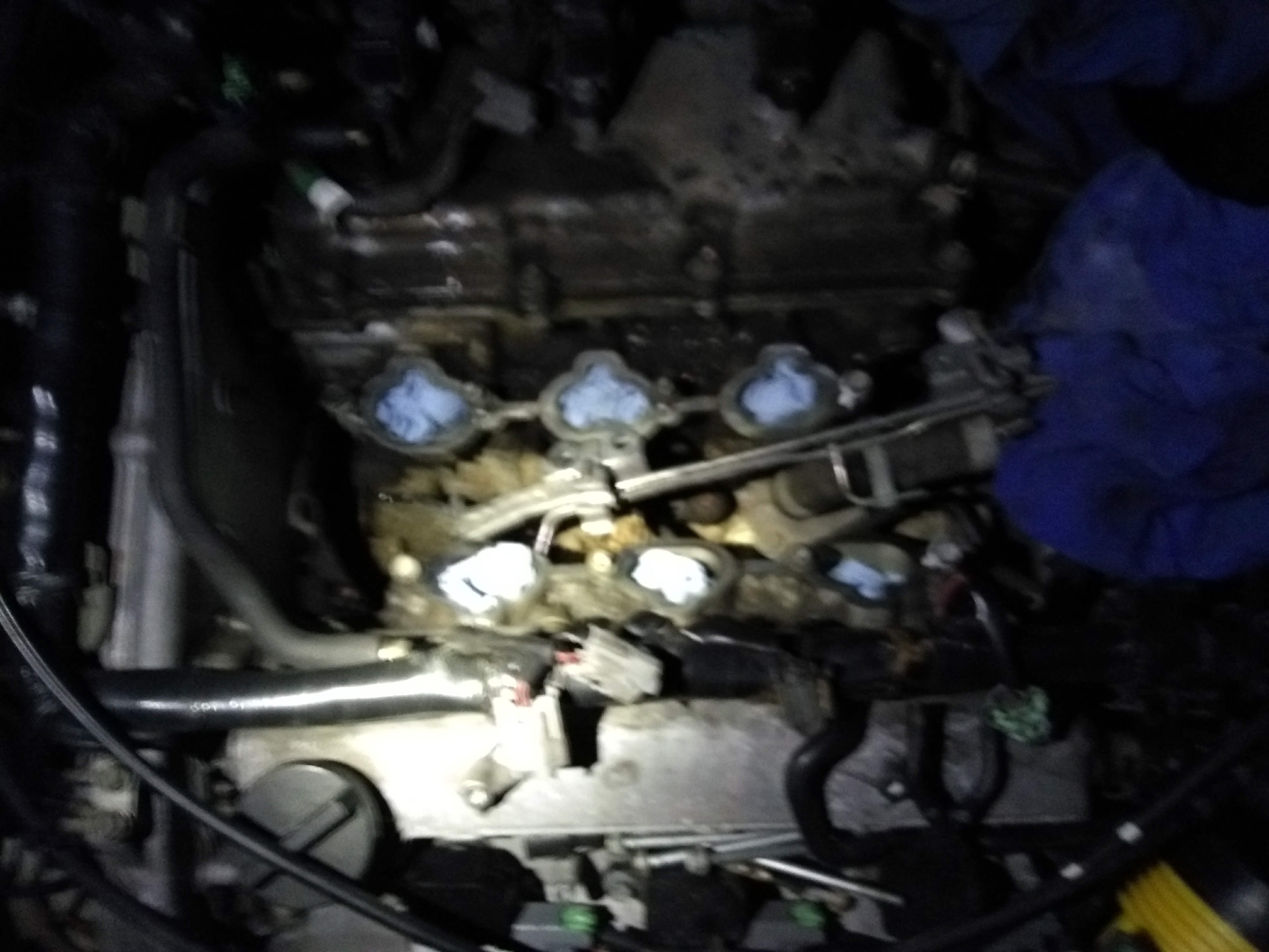

Dude he honestly has a good point, I was going to clean my throttle body on the 2k 5 speed, saw how dirty the egr (fed spec) was making my upper intake, proceeded to see how dirty my lower intake was, and in this process saw that every pcv line, valve, all vacuum lines, o rings, upper intake gasket, vias gasket, egr gasket, throttle body gasket, all needed replacing anyways. It's not that hard to take apart, I guarantee your intakes could use a cleaning, if y'all have swirl control butterflies in the lower like us, you can remove them, weld the side holes shut and gain some cheap ponies, not to mention the crud you'll get out of the mani's will regain lost ponies, and you will see what we mean when the unseen damaged vacuum lines and such are brought to your attention. Makes for a great time to really degrease engine, vacuum between banks out, check for oil leaks, spark plug tube seal leaks, change plugs, coils, valve cover gaskets, and even putting headers on are all made alot easier by doing this cleansing that only takes a few hours to complete in its entirety..
