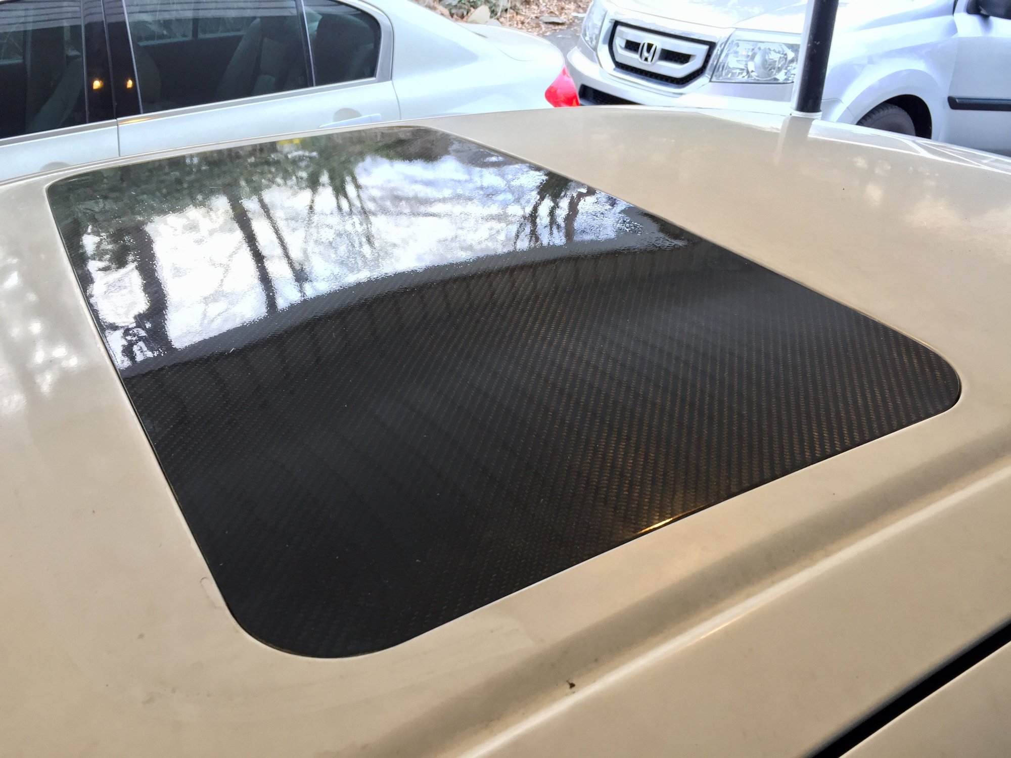

Hey, I like my delete. It’s nice to take 30 lbs off the roof.
That looks really good! All about what you want I suppose. At least there’s options if something goes wrong with your moon roof, whether you want to keep it or not.

I think that's true based on a youtube vid I saw. Nice carbon fiber piece though!
