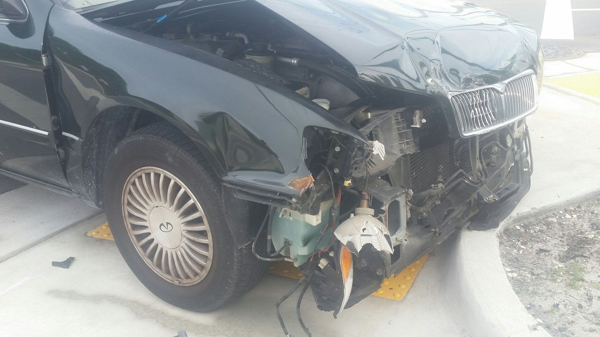

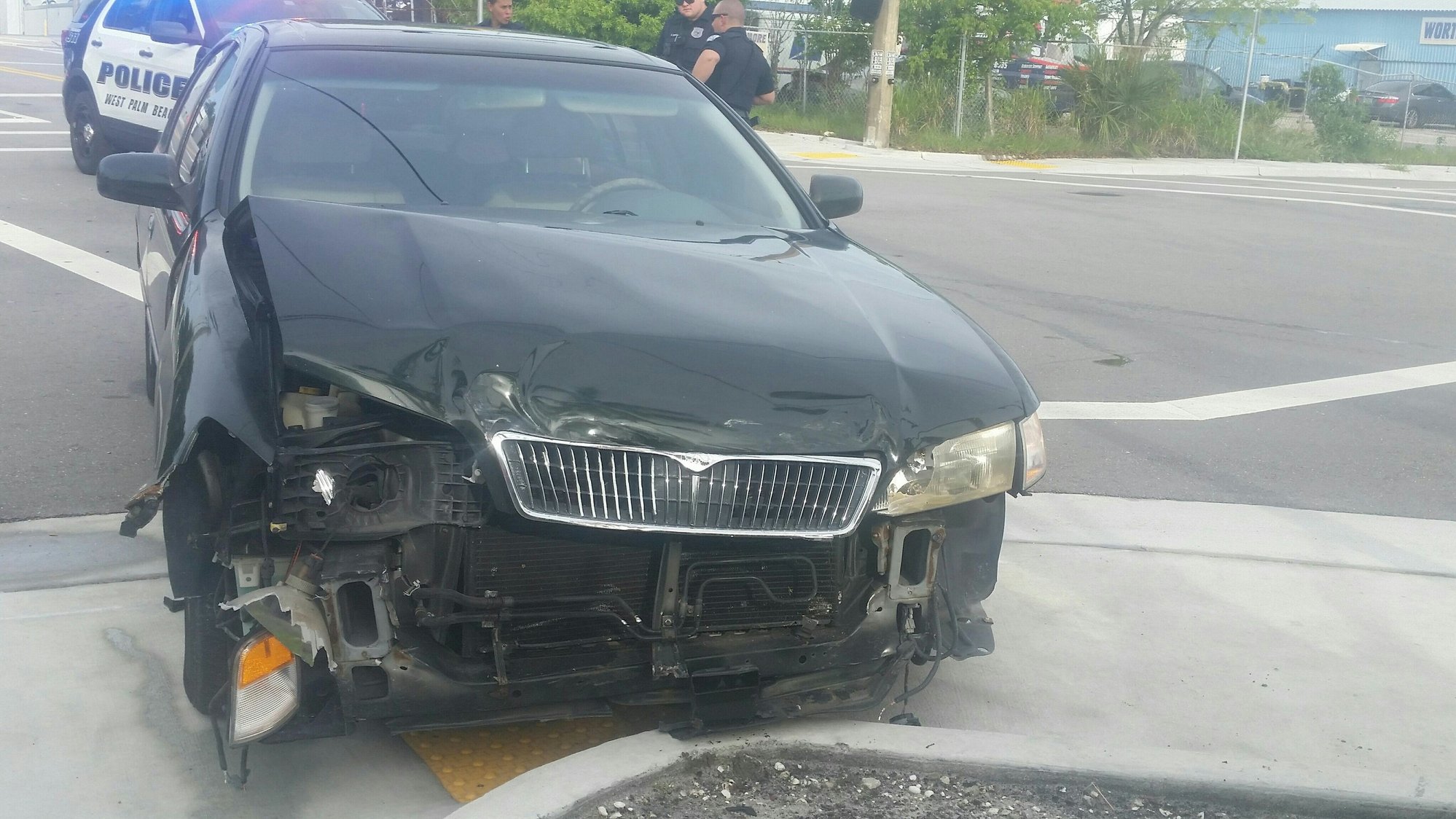

1996 i30 is pretty crumpled up front.
Hood, passenger fender crumpled and pretty much most of the plastic and lights from front end were hanging or on the ground. Including bottom "bumper"
Ooph.
OK. This happened, Last evening. I have a swollen achilles tendon (separate issue, I wasn't driving) so I haven't even been out back to look her over yet.
I'm just staring at pics trying to figure out how much to piece back together Into a working vehicle for the girlfriend to continue driving to work and back.
While I will be using you all for a billion questions I'm sure (and feel free to fill this thread with any unsolicited ideas!)
The main issue before I get to the cosmetic and lights is this?:
The shifter is in, "Park" but actually car is in reverse.
Basically the shifter is off by a position.
Is this just a linkage cable needing adjustment? I Googled a bunch last night and found nothing about shifter being off a position.
I'm told car drives fine.. We will see.
Thanks guys, this is throwing a huge monkey wrench in our day to day life.

OK. As far as front end, fender support and radiator need to be straightened a bit to get anything from junkyard bolted on.
Worst issue I see for the cosmetics of front end is that the frame piece the bumper mounts to had all the bolt holes ripped out. Assuming I'm going to have to have some material welded on to attach front sash/plastic bumper.
I could roll without front bumper for a spell. Pretty common here in South Florida with import modders actually while they swap out and paint aftermarket parts.
Can grab a hood and fender from junkyard cheap. Probably just grab a new radiator though.
That all hinges on the transmission issue though. Trying to Google that some more now.
Radiator is trash although not leaking.

The shifter is connected with a cable. The levers where it connects on the trans may be bent. Could be a simple fix.

Just inspected damage a bit more. "frame" member is bent and touching the drive pulley...
Rural young boy me says get a tractor and pull it out!
Suburban me now says I'm screwed, it will cost too much to get it done at a body shop.

Frame shops can do quite a bit of good.
I had an accident in my 73 Volvo. It bent the frame.
A shop straightened things out for a few hundred.
Then I could bolt on replacement parts.
Buy a brand new radiator. You probably would have replaced your old one sooner or later.

That passenger side frame is twisted. Might go as far as the suspension crossmember. By the time you put a lot of money and time, only to hope it tracks properly just isn't worth it IMO. Hopefully, Insurance will total it and maybe let you buy it back cheap and part it out for some more deposit and move it on up!
