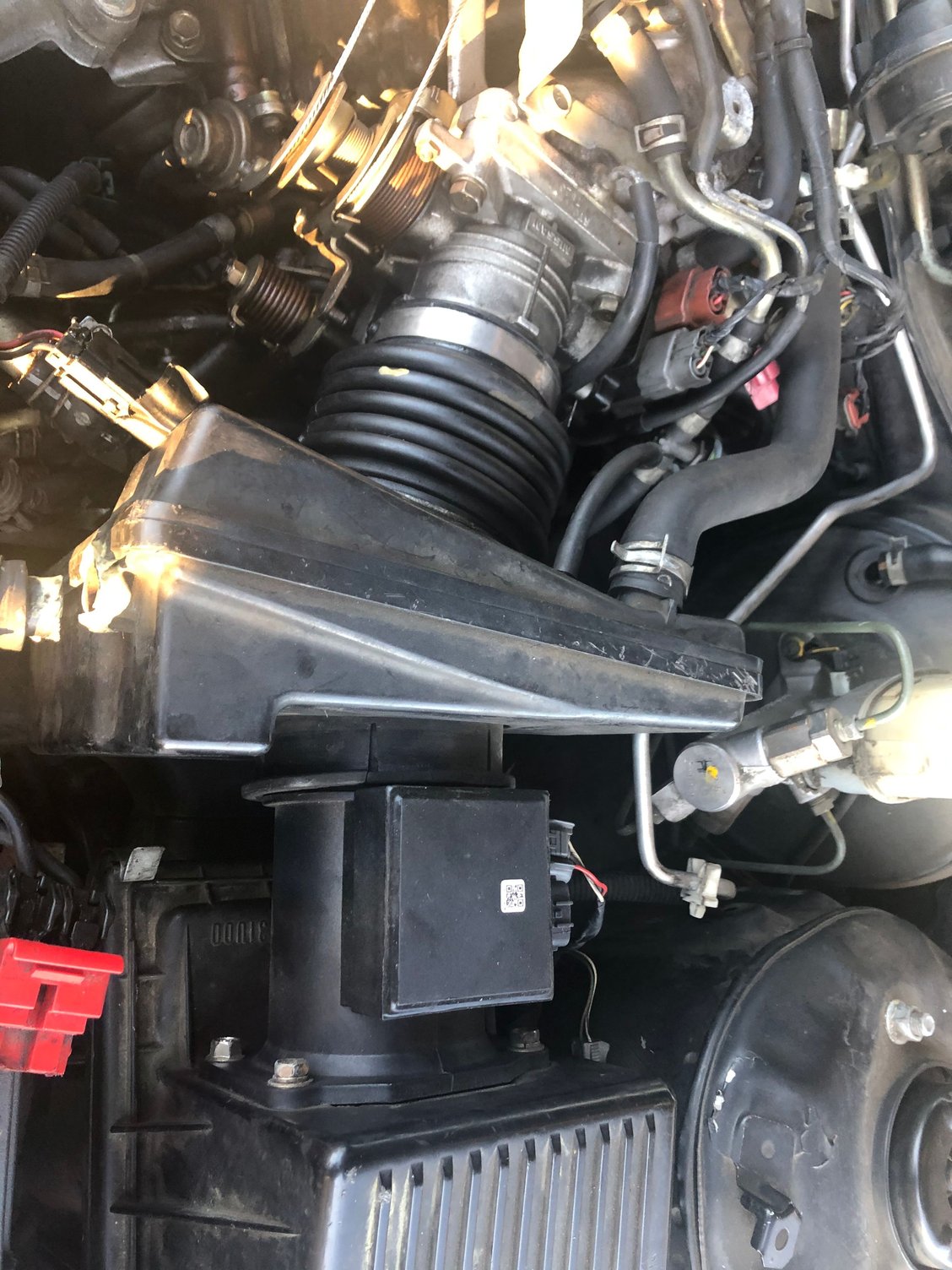

i started pulling the MAF out for a cleaning and realized the tube from the inlet resonator to the valve cover was broke. It had a yellowy job weld substance on it to try to repair and that was covered with black tape that made it difficult to notice until I moved the resonator box. Considering replacing with CAI (recommendations here?) if I can’t find one at a junk yard because the part is $260ish (yikes)

The big black box between throttle body and MAF
runs about $240 From the dealer locally - part 31u17

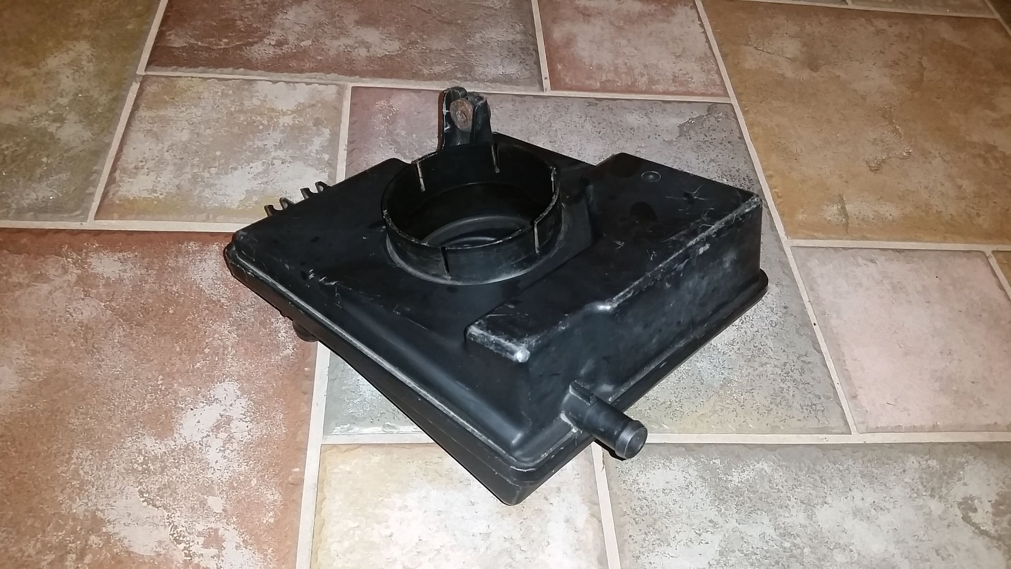

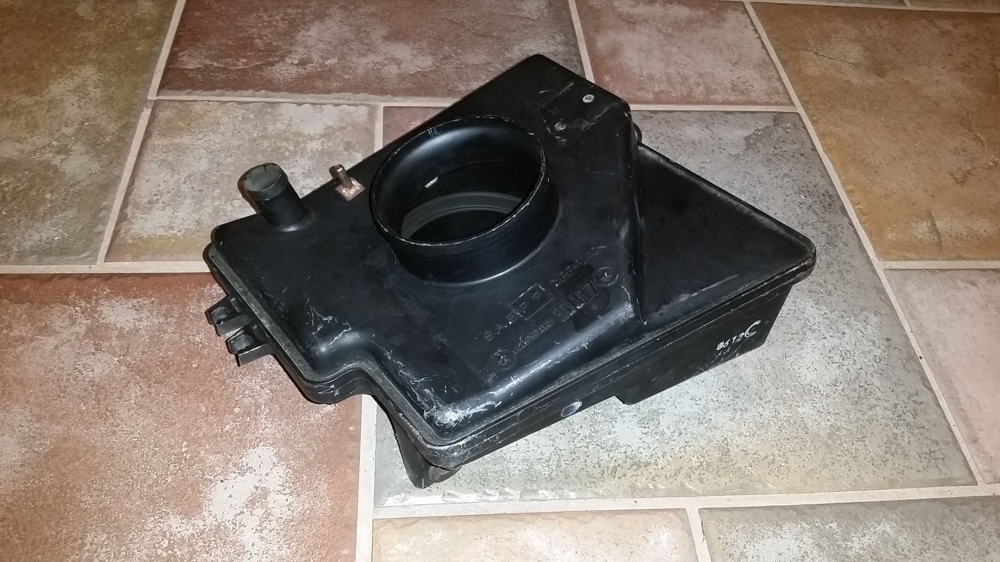

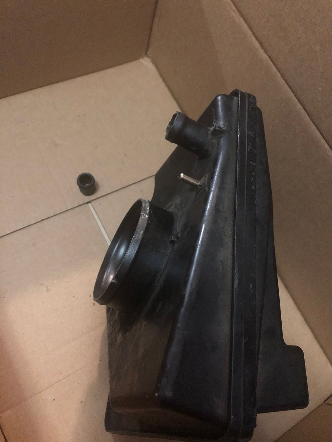

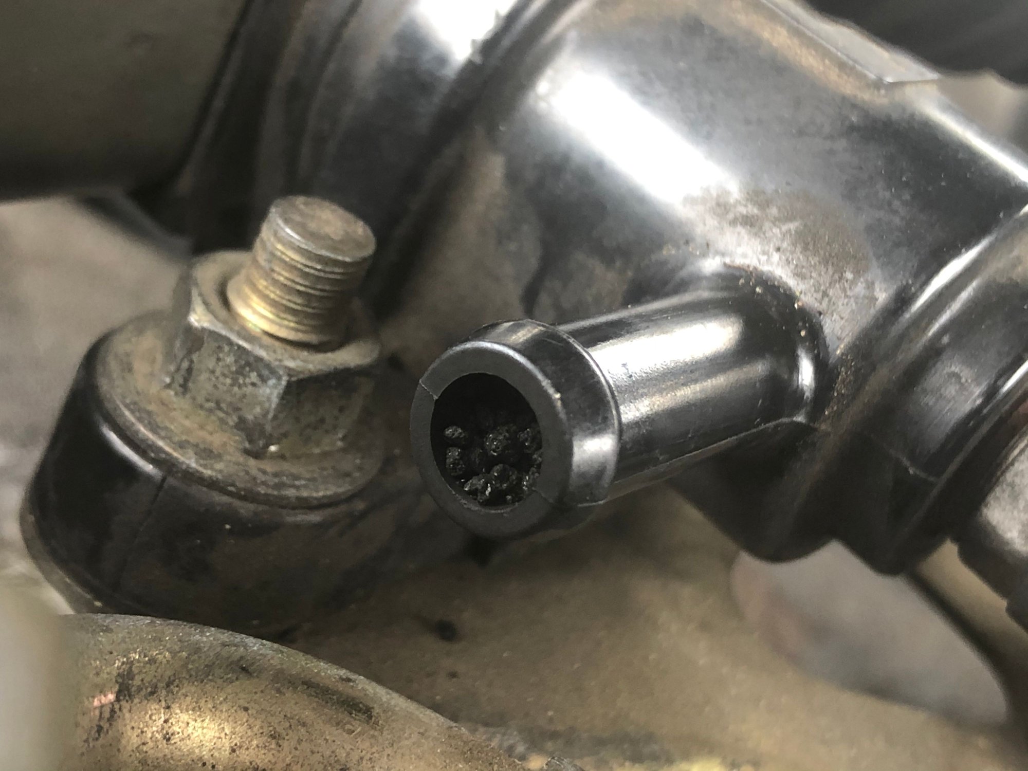

A view of the specific part. This has several hose attachments - which is the logic behind wondering if going to perhaps a CAI would be a good idea. Not specifically for power gain, but as an alternative to the dealer price (though we will be going to pull a part in Birmingham Friday to see if any of their maximas have one in good condition) Sucks they want so much when all it is is a plastic box ... I get that it is supposed to muffle the sounds of the intake, but yeesh

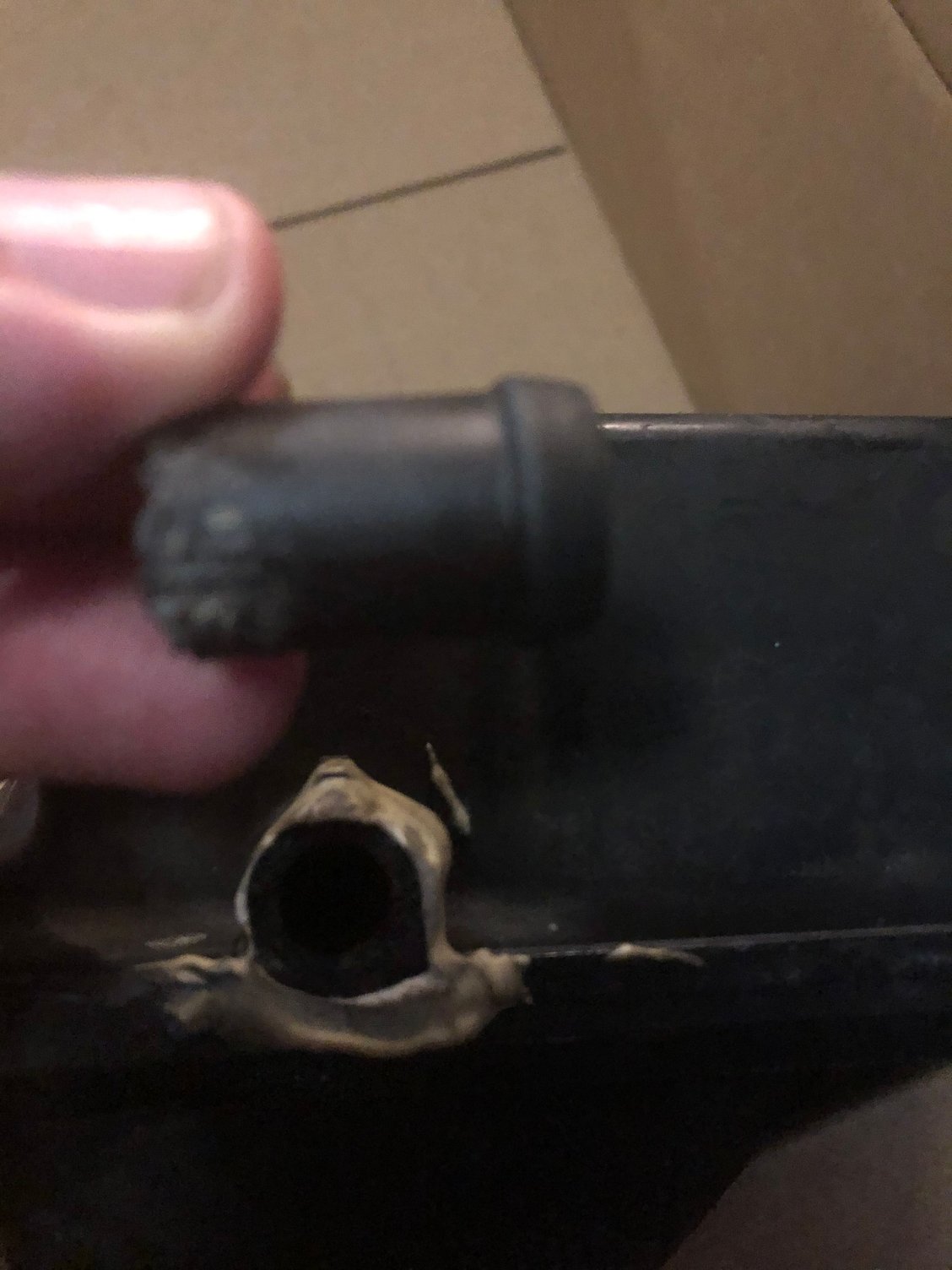

This is the nipple that was broken off. I cleaned it up a little bit thinking I might consider getting a plastic welder and trying to weld it back together since it is polypropylene and should be able to weld PP... but I keep getting ahead of where I need to be since the boy wants to do the work and he’s at his grandparents

I have one.

That part should be dirt cheap at a wrecking yard.
you might as well get a maf or two while you are there. Oh yes, the crank position sensor as well.
also any other part you need.
the broken part would cause a massive air leak.
the car should rUn a lot better once it's replaced

Us older folks have used 2-part 5 minute epoxy for all kinds of things. It could work for the broken plastic nipple on that air box thing.

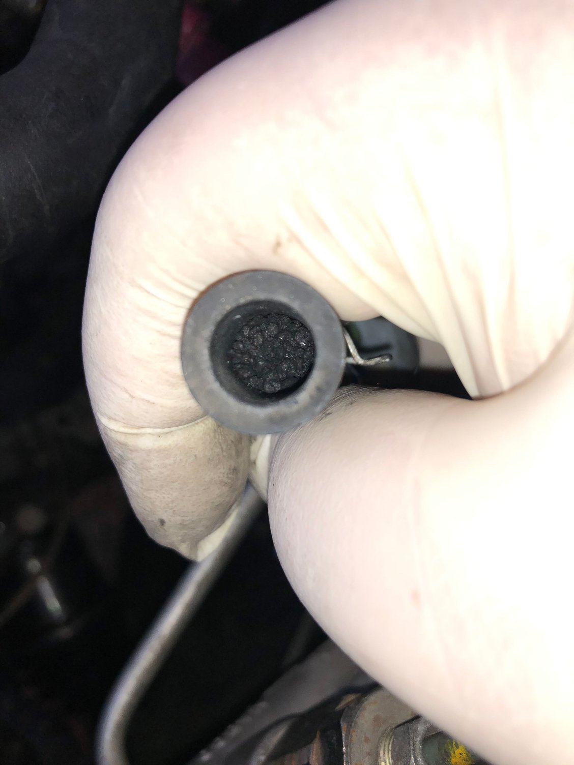

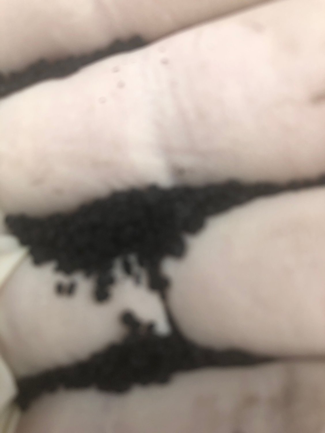

- found another tube (picture below) that the three of us under the hood couldn’t figure out where it originated or where it went (friend thinks it was a breather line for transmission)

Evap lines full of charcoal...
Old Dec 8, 2019 | 12:41 PM
CS_AR's Avatar
Joined: Jan 2011
Posts: 3,037
From: Central AR
Time for a new canister. Need to disconnect at the canister blow out the lines with compressed air.
Are you getting evap related codes?
Old Dec 8, 2019 | 12:44 PM
JvG's Avatar
JvG
Joined: Oct 2012
Posts: 2,974
From: Portland, Oregon
The lines can be blown out with an air compressor.
Caution: disconnect each line at both ends so that critical components are not destroyed from over pressure.
A friend of mine had this issue with a 1996 pathfinder. I learned about destroying parts from personal experience. It was fun watching charcoal spew from the lines though.
While I don't mean to discourage you, perhaps another, lower mileage Maxima in better condition might be worth considering.
Old Dec 8, 2019 | 12:47 PM
CS_AR's Avatar
Joined: Jan 2011
Posts: 3,037
From: Central AR
Rock Auto is a maxima.org sponsor. We get a 5% discount using the code in the following link.
Rock Auto with the discount code will be your friend as you go through your Maxima restoration journey.
https://maxima.org/forums/group-deal...22-2020-a.html
Jason Chrest's Avatar
Joined: Nov 2019
Posts: 46
From: Mississippi
No codes at all just isn’t starting. Cranks all day (as long as the battery is charged) but won’t start.
When I first got it we found codes for camshaft sensor, crankshaft sensor (POS), and MAF. Have replaced and repaired the causes for those. Found two bad coil packs and replaced... and now this.
oh I don’t disagree at all JVG. I’m ready to get rid of this car 😂 problem will be trying to get my $$ back on it
Old Dec 8, 2019 | 02:33 PM
Joined: Nov 2019
Posts: 46
From: Mississippi
Oh now that I got the charcoal out of the lines and components it’s throwing an evap code 😂
