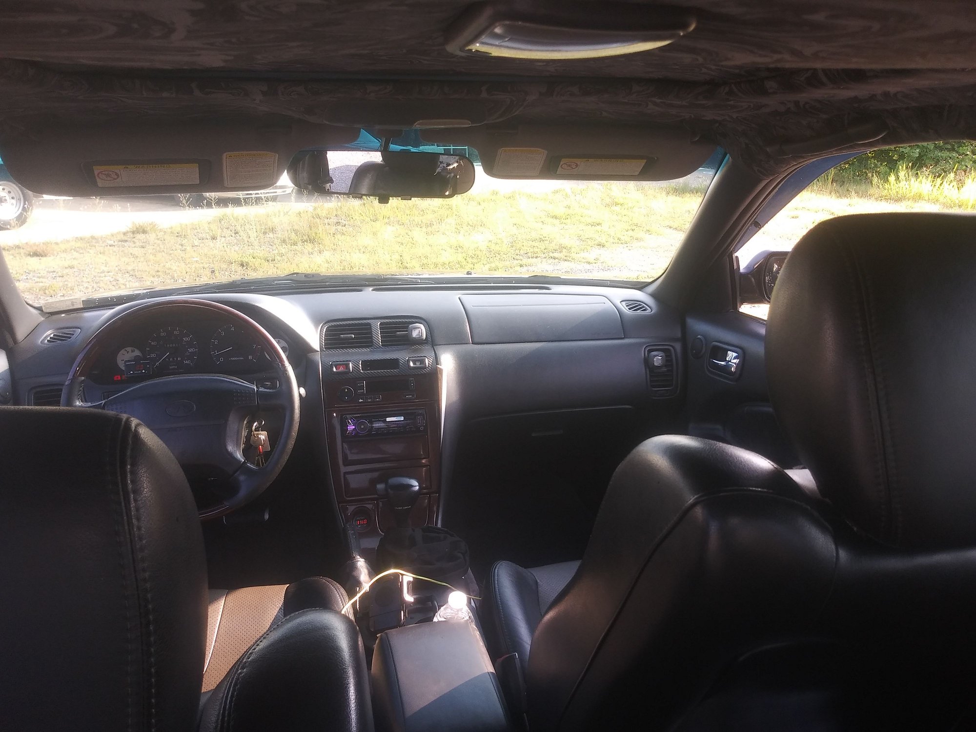

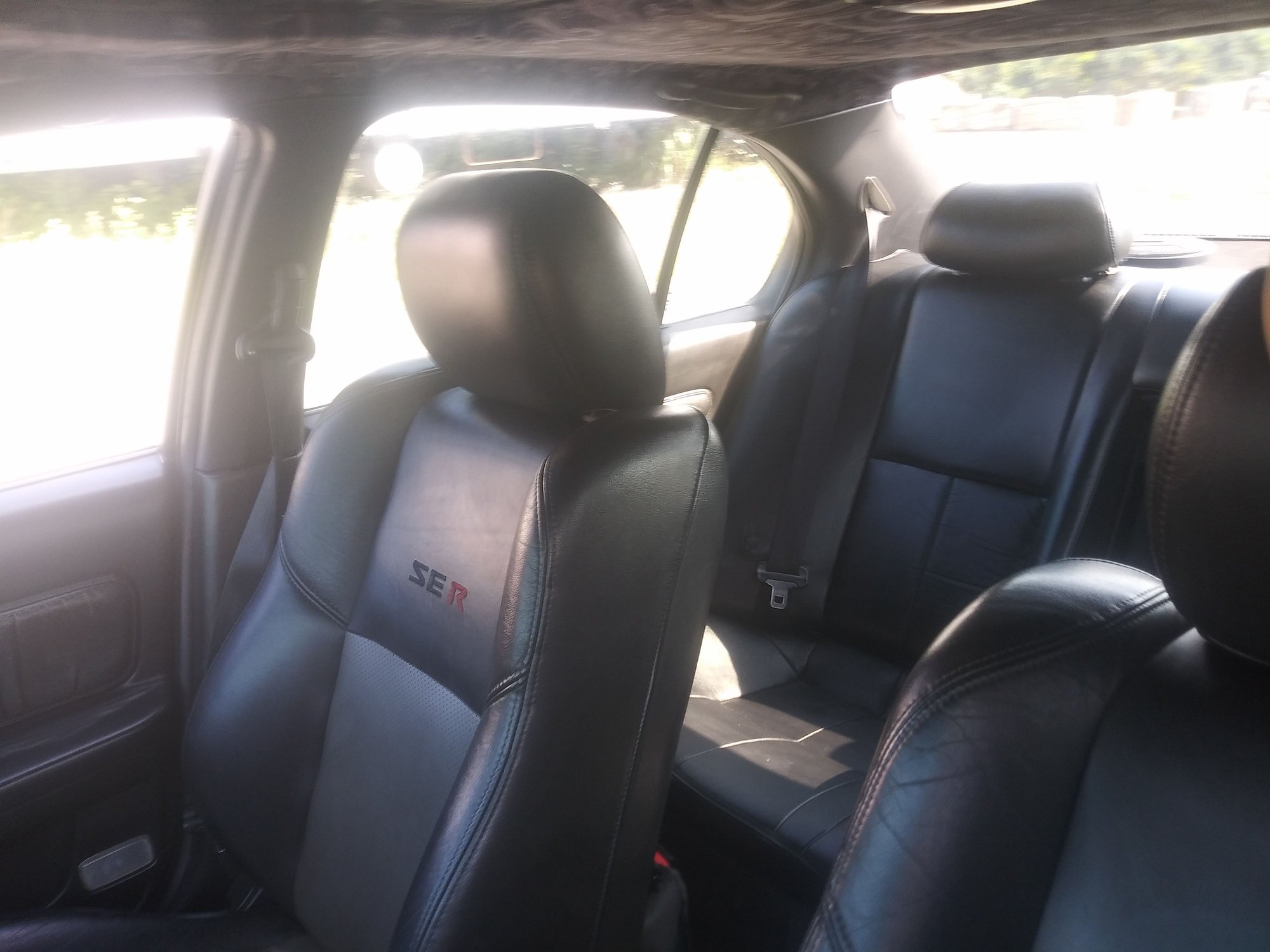

I've been running se-r for years. I30t rear upper with headrests in the back.. I'm currently collecting all the rear seats and Console from the Elite Maxima. The rear Console is just #Dope. I just don't have all the pieces yet. This is in my 4th gen

We need more pictures, zoomed out, so we can see the entire front seats.

Sorry so late on this.. I have Se-rs up front and I30t rear if my 4th.. 👍
