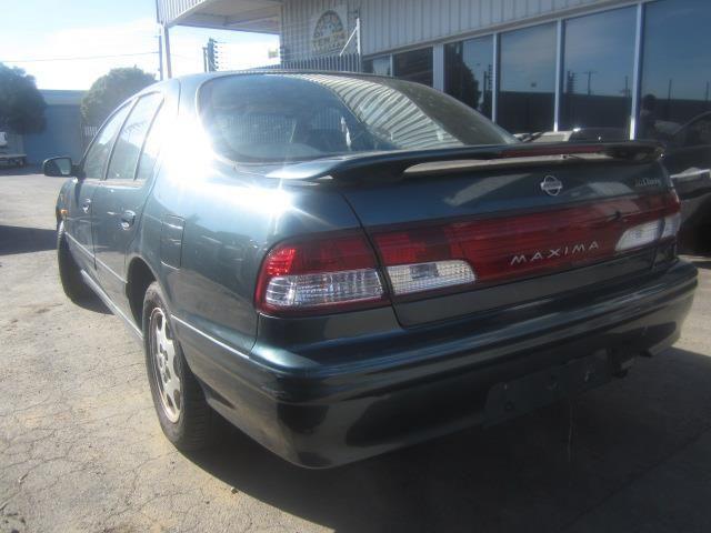

hello guys, my name is fabio and i'm from brazil, in my country i'm a mechanic.
I have two nissan maxima of my use.
Nissan maxima 30gv 1998 most complete version of it here in Brazil (I think it's similar to your infinity i30)
And I have a nissan maxima 1995 30J (basic version here in brazil)
Both have the same vq30de engine and from what I've seen everything else is the same.
I'm having problems with the nissan 30gv 1998, the car is simply weak, it doesn't seem to have the potential of a v6, it just shows its potential, when you step on the accelerator using the reduced ones, unlike the other nissan 30j I have that has the same engine , much more expert than the other.
On the nissan 30GV I did some maintenance on his engine and the following repairs were done.
Replacement of piston rings.
Crankshaft Shaft Replacement (I used the patchfinder, exactly the same in all crankshaft measurements and code.)
Rectified the heads.
Crankshaft Bearings
New Bosch fuel pump.
Anyway, I followed the manual when putting in the crankshaft sync point, it was already checked 4x and the sync points are perfect.
Equalization and cleaning of the 6 fuel injectors.
Anyway everything is correct. there is no malfunction code present on the scanner.
Anyway, I don't know what else to do.
The other nissan that I have the 30J, I also did the head rectification and gasket replacement and it's perfect, it goes well, it develops, expert to run.
Now this other one I don't know what it can be anymore, does anyone have any direction that I can investigate?
Thank you very much,
Attached are photos of the cars.
