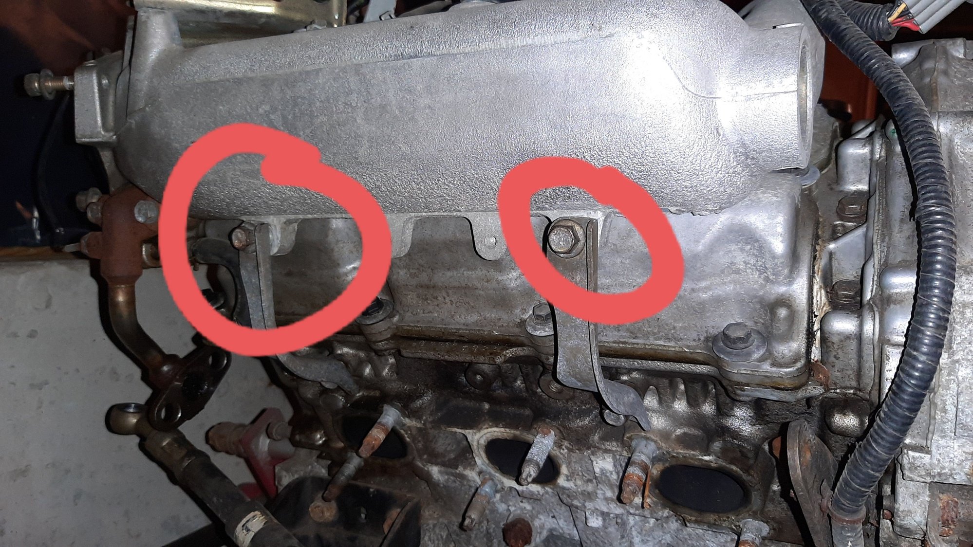

So I only found one bolt holding the back of the UIM to the brackets. 13mm head. NOT the Nissan size. So I went looking on Nissan and the part 08070-8161a is discontinued (I need 2)
Nissan DOESN'T give any info on size. Bastids. I know the head is supposed to be 12mm. Anybody know the length and M size and what washer or spacer is applicable?
My EGR Tube looks to be clean at the UIM mount as it was replaced about 3 years ago (the old one rotted and perf'd.), but I want to remove it and make sure the other end is clean like new as well. I have both gaskets. Is there any way to loosen that zinc plated pipe that is too close to remove the bolt or is cutting the end of the stud the only way? Mind you, the EGR tube is newer and the stud wasn't cut, so there is another way to make this happen. And probably less annoying!
Calling on you guys with the most fun experience! LOL
Thanks in advance!

8mmx1.25. Threads are 16mm long.
I have some of you want them, just pm me your address.
