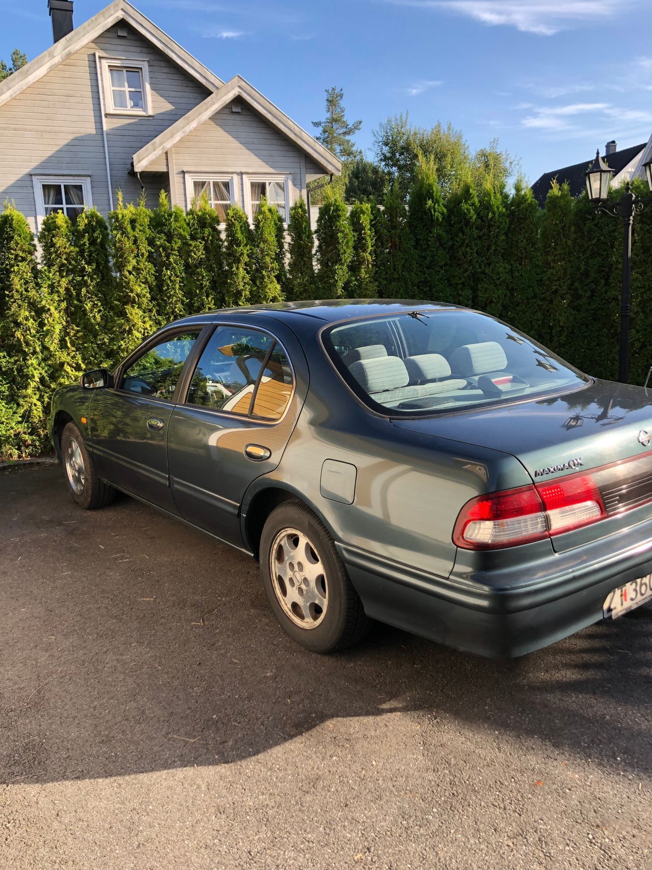

Hello all,
Well, just got back home from a test drive of a -99 Maxima with the small V6 engine that was sold here in Europe to reduce taxes, 2.0l and around 140 BHP. Yeah, it is not fast, but I am not looking for a fast car
Witch brings me to my quest for help,
Any tip on what to look out for when buying one?
There is no rust , 2 owners car with 287636 KM, all service done at local dealer.
Yes, the paint is faded and it has some marks here and there, but nothing big, the rims are all messed up, but that's it.
All things work.
I know that the 3.0 V6 is a very solid engine, same with the 2.0l?
How often do one need to do the timing chain?
Good things is that the transmission is not a CVT, so less problems there to.
The car will be a 2 car, for taking trips now and then, me going camping/fishing and so.
I do like the look and feel of the Maxima, feels solid and had a good ride to it, low priced luxury, but how is it today, reliable?
Thanks for looking and helping.

Hi and thanks for the reply and good information.
Well, yes, I will try and do some work myself, but not sure I will jump on the water pump/tensioner.....Maybe, if I can find a good video and take my time.
But, the water pump and tensioner was done at 200 000km, at the same time was also the starter motor replaced.
No information on the fuel injectors.
All 4 rotes and new pads these fall, so that is ok.
How often do you change oil on the gearbox?

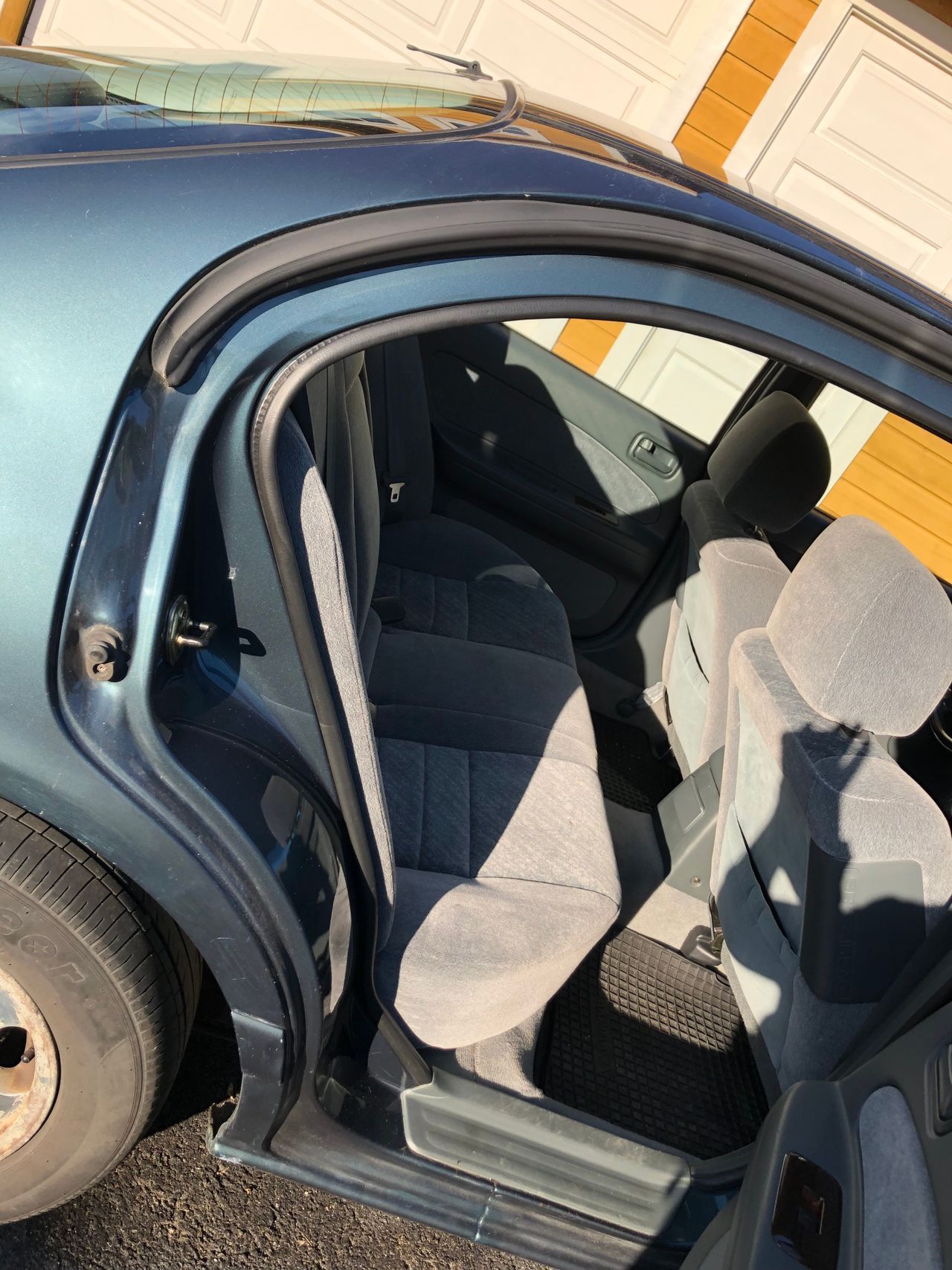

Also, I do not mind the non leather seats at all, not as cold when on jump in the seat during winter.
I think I will pull the trigger enthuse one, it is a nice car, from a time when things where more real than they are today.
