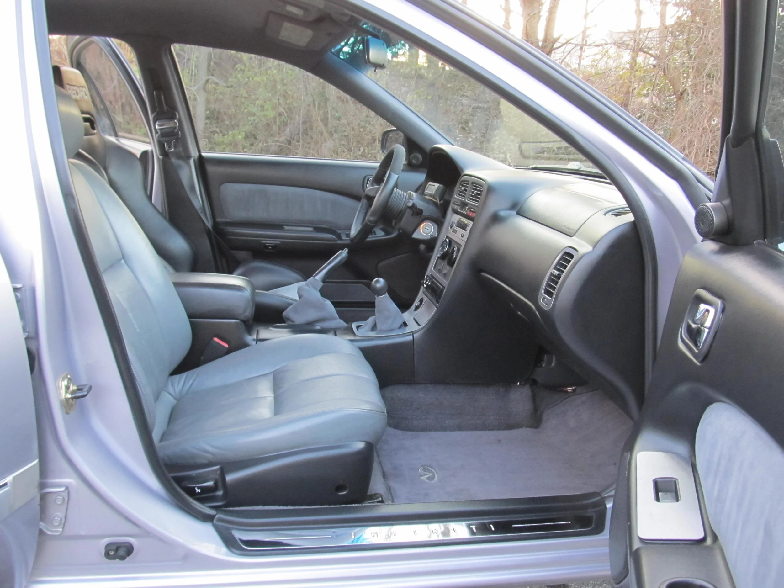

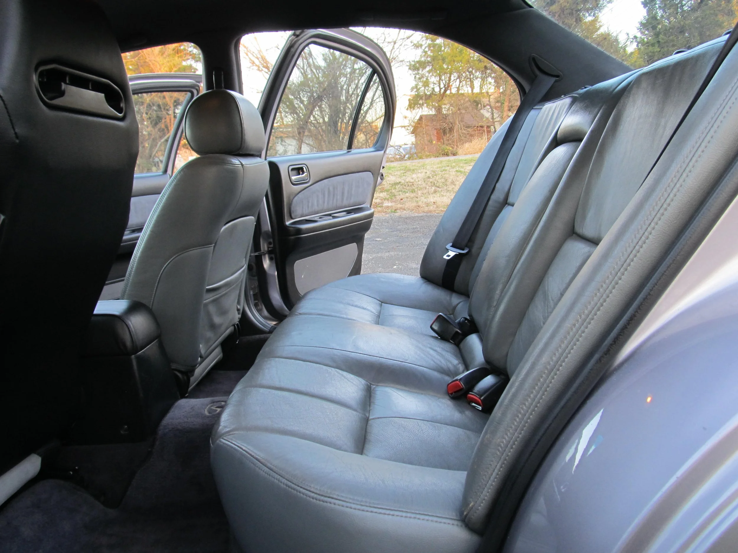

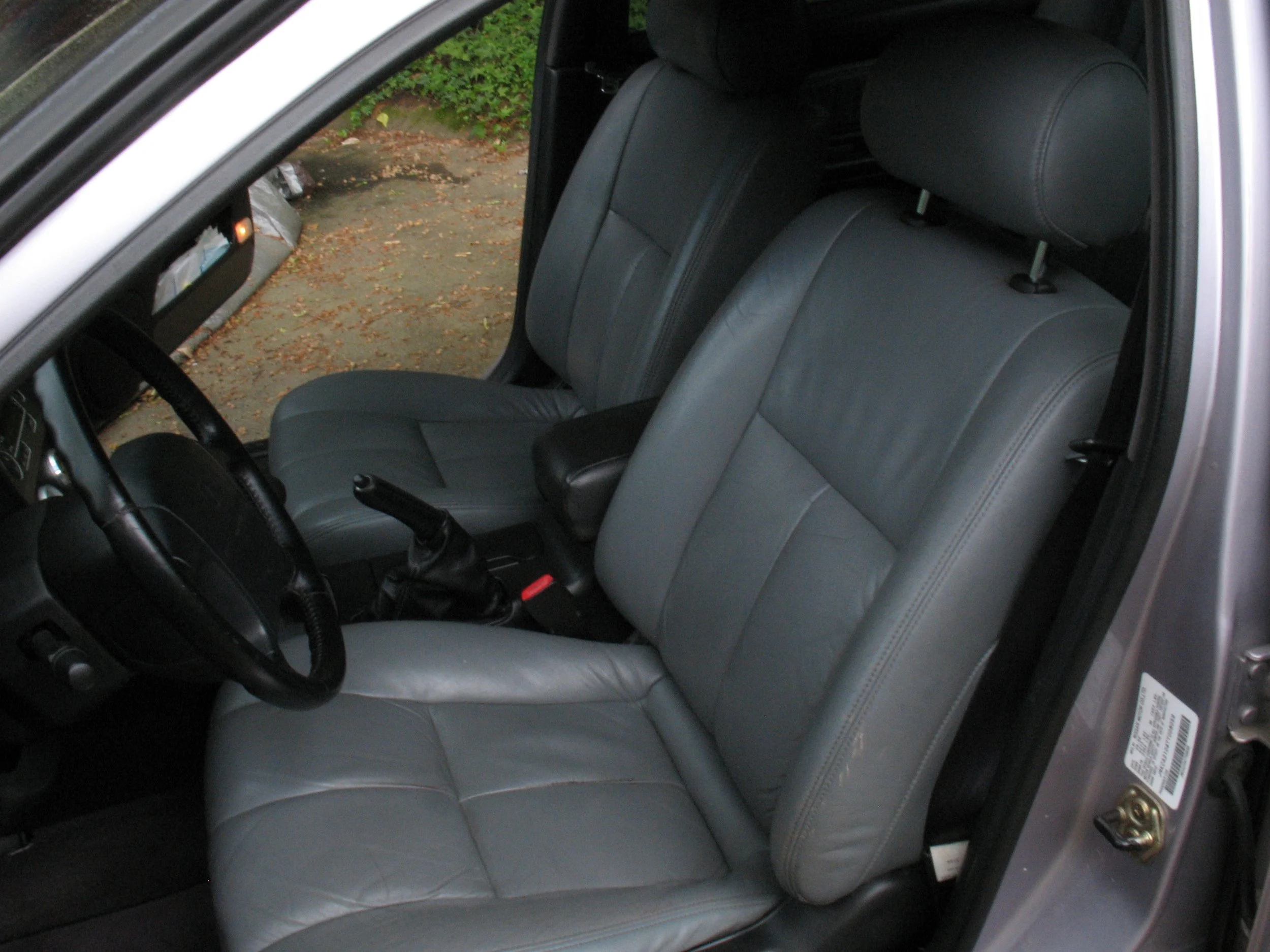

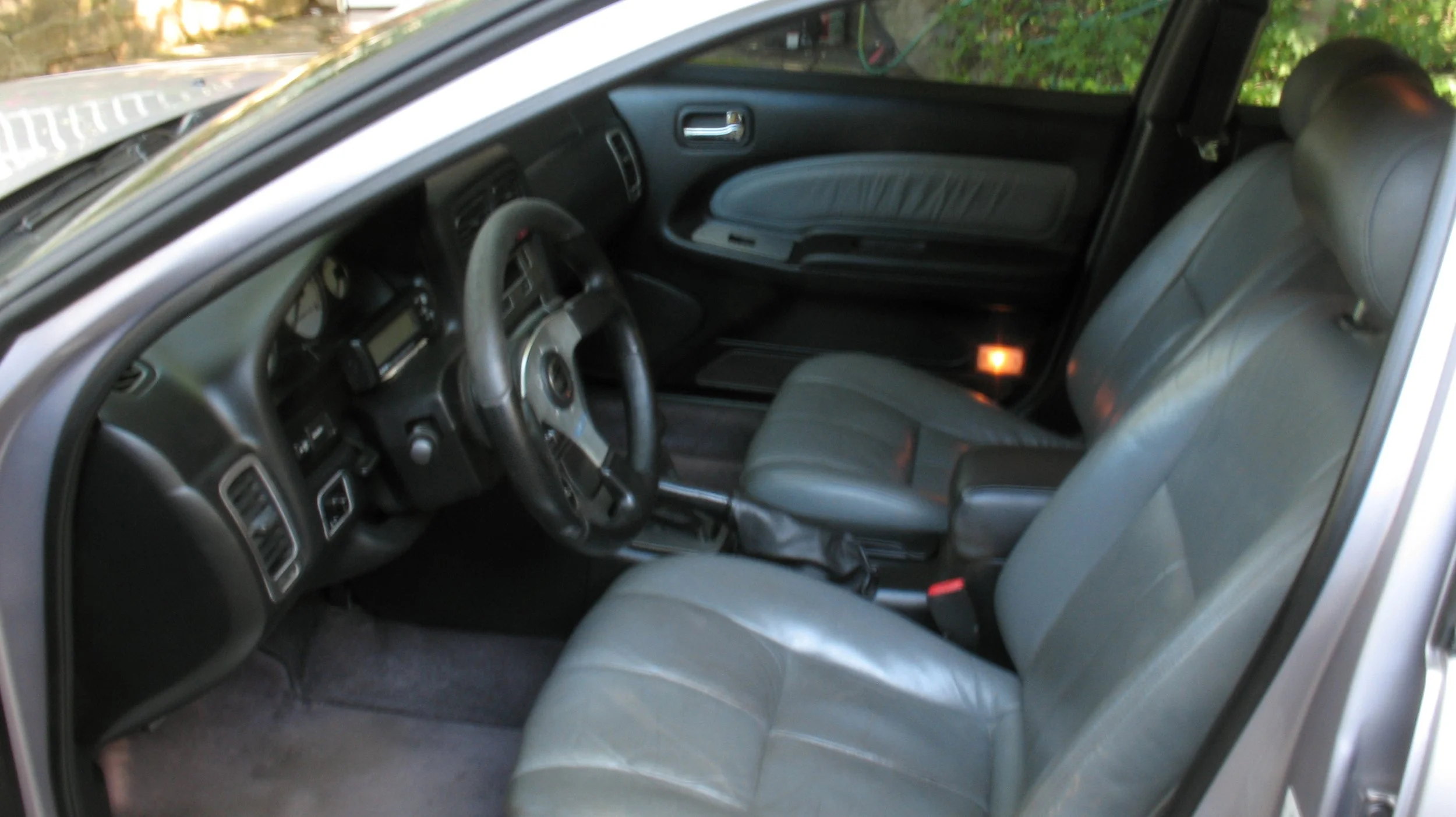

The dashboard was the normal tan color, but the seats, doors, and headliner were all this color I have never seen before. I was dumbfounded, but also giddy with excitement. What was I looking at, and how did such a thing exist? I've been doing the 4th gen thing for 20+ years, and I don't ever remember seeing such an interior before. If I had to guess, I would say 49% of cars had black interiors, 49% had tan, and 2% were that weird gray in some later 98-99 cars. Now my car (1996 I30 as well) was a little different since it had a black dash and doors, but a lighter gray leather that wasn't the same as what came in those later 98-99 cars. It also has matching gray leather door inserts.
(Excuse the crappy pics, they're very old)
Here are some more recent ones:

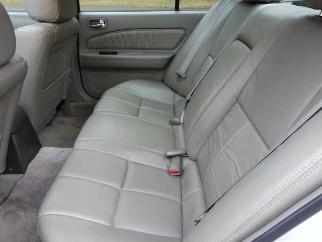

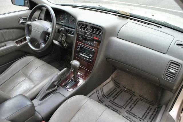

And here are some pics I found of the all (darker) gray 98-99 cars:

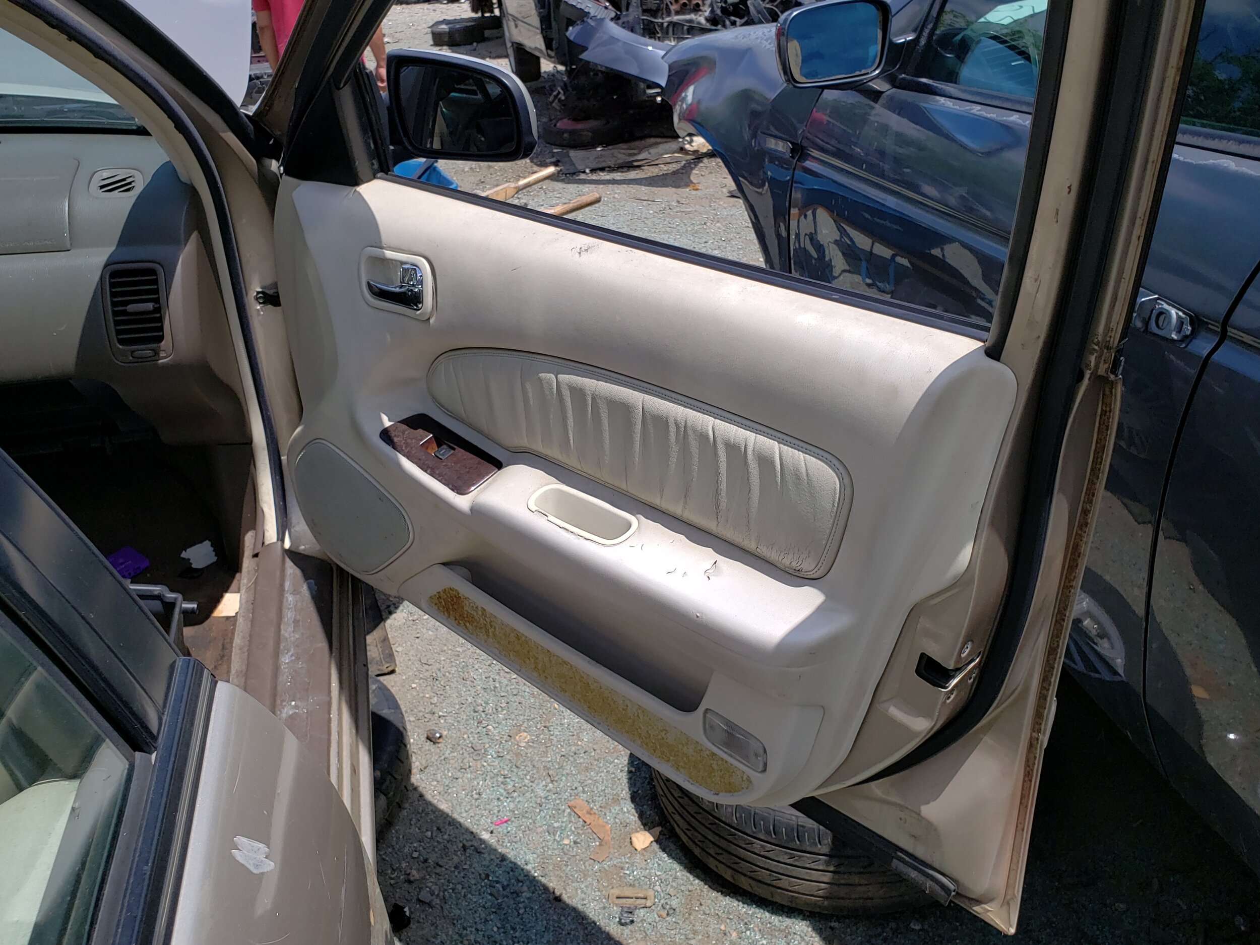

But this car was something entirely new, because not only was the leather a different color, but the doors were as well. All I can assume is that the first-year 1996 I30s had some weird options that didn't exist for Maximas and were gone by the '97 model year.
Unfortunately, the front door panels were trashed beyond repair, as was the driver's seat. The rear looked better, but due to an accident I couldn't open one of the rear doors to get a better look. All I could do was take pics and wonder how such a thing ever came to be.

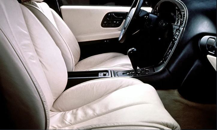

There were a few Q45s in the early 90s that came with a white leather interior. It was rare.

The Infiniti j30 also had the option for a white interior. Plenty of examples can be found on YouTube.
interestingly sage mist Maxima’s were almost always a gray/green interior, at least what I’ve seen scouring the junkyards over the years. Never seen a white one tho, very cool indeed. I would definitely also scoop this color if I found one.
