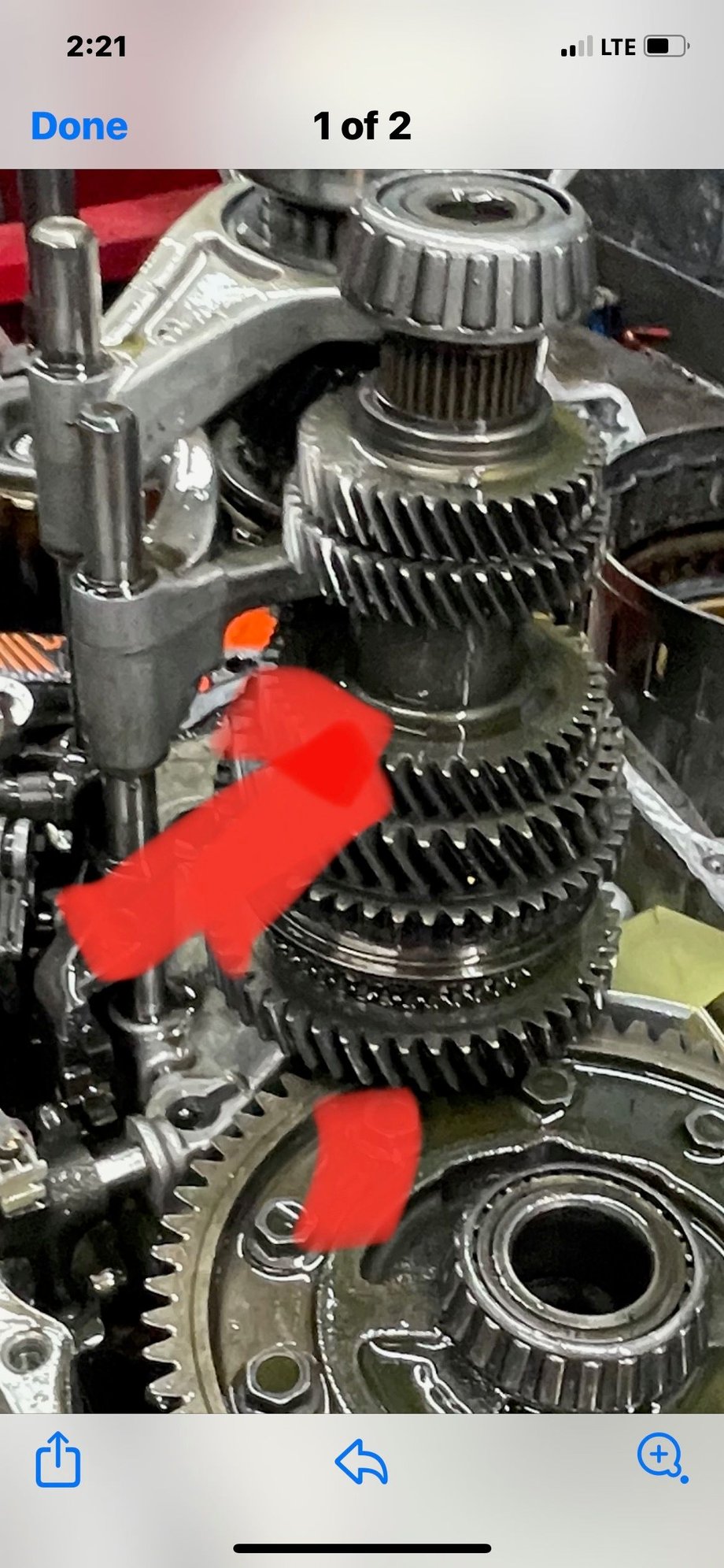

i need a beefed up 5 spd manual transmission for my maxima. i blew five teeth off of the main gear amd the pieces messed up the rest of it. i need a rebuild done, i have a guy but we cant find the beefed up parts. Anybody have any leads? i cant even find an oem one and if i was to use another oem id blow that one too..

Assuming you're still on the original 3.0, you're lucky if you're making 180 whp. There's no way you need super expensive PAR gears or even a 6 speed to put that power down. And IIRC the 6 speed only has about a 10% increase in strength/torque rating over the 5 speed, so it's not like it's a huge change. You didn't explain what you were doing when you broke your diff. How did it happen? If I had to guess it involved a quick transition from the front wheels spinning to them getting grip, like what happens when doing a burnout. We need more information.
But setting that all aside, PAR only makes strengthened gears, and doesn't make the diff, which is what you broke. Someone please correct me if I'm mistaken. So PAR gears aren't going to help you if you abuse your diff.
Plenty of people have done far more drag racing than you've probably done with more power running a 5 speed without blowing their trans apart. IMO, the problem is probably a combination of how you're shifting and the ACT stage 2 clutch. Way back in the day people were blowing out 3rd gear with ACT clutches by shifting too hard, and most of those people were running the stage 1. These transmissions are fragile in general and you need to treat them as such. I learned that lesson the hard way. Personally, I choose to run the most "stock" clutch/pressure plate that I can to keep shock loads to a minimum, and baby my transmission as much as possible. Wheel hop is also very harmful, so do everything possible to avoid that.

nah look at the damage. its not the differential. its the tranmission i grenaded. The car was just over 190 hp stock, i must just be really luck right? wrong. luck is not a factor. If I could have my mechanic install luck in my car that would be great! lol!! I had my card dino'd And it's pushing over 200hp at the wheels. Again stage 2 racing clutch, Short ram air intake, Long tube mandrel bent OBX headers and High octane gasoline. Yes I absolutely do need a more robust transmission. No I'm pretty certain that's not the differential. And no I did not burn out I accelerated and near the end of the 1st gear it Busted before I shifted. I'm 41 and I've been driving manual transmissions since I was 14. Pretty sure I know what I'm doing lol. In my opinion getting a transmission that's 6 speed from a 3.5 L engine and having that put in is not super expensive. But that's just my opinion.
I'm trying to help you and save you money. Please listen carefully.
So yes, that is in fact your differential that broke. If your mechanic told you otherwise, get a new mechanic. I've been in these transmissions a few times and have seen the exact same thing before. I know what I'm talking about. You can shell out $5,000 on all PAR gears (or whatever it costs these days), but you'll still have a stock diff, and if/when it breaks again, all it will do is trash your fancy gears. And then what?
Your car puts down 160 whp stock. You did not gain 40 whp from intake and exhaust. If your dyno said you make over 200 whp, it's not accurate. But even if you did put down 200 whp, that in no way justifies the need for a stronger transmission. People put down over 300 whp all day on stock 5 speed transmissions. It's how you drive it that makes all the difference. It's also possible that your transmission was just at the end of its life, and you can slap in another stock 5 speed and never have another issue with it. But your decision to run a stage 2 clutch isn't necessary and only makes it more likely this problem will happen again.
I just went through the process of installing a 6 speed in my car, so I have firsthand knowledge of the process. If you are paying someone to do it, it will not be cheap. It's significantly more work than just installing another 5 speed.
Again, just to reiterate, YOU DO NOT NEED A STRONGER TRANSMISSION IN YOUR CAR. And FYI, plenty of people break 6 speeds as well. They're only about 10% stronger than a 5 speed and are in no way indestructible.
