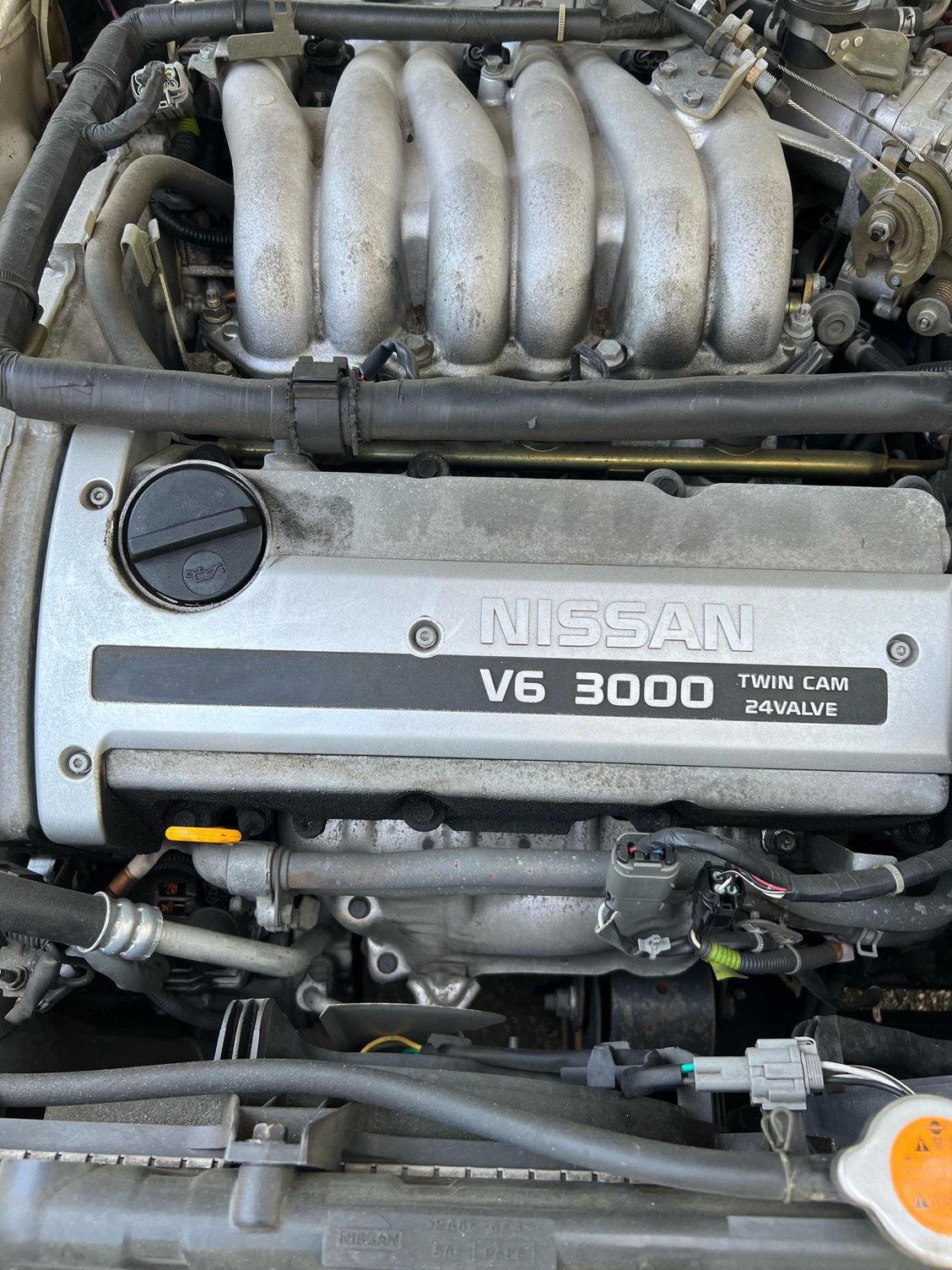

Hi -
I only have 70k miles on my 98 maxima yet my mechanic said I need both valve cover gaskets replaced. What are some of the signs of a bad gasket cover I can check fo ? As I have no oil leaks nor any overheating problems. Is this common with only 70k miles.. As the car is in mint condition but 25 years old. Also what would be the typical cost replacement work and parts .. As he said its a lot of hours to replace both of them.. Also what are the best valve covers gaskets to get?
Thanks in advance

Bad valvecover gaskets wont cause overheating, they will usually cause oil leaks down the heads to the block or leak into the spark plug tube and soak the plugs in oil. Mileage doesn't really matter either, its rubber that's subjected to cold/hot cycles that will inevitably wear out and cause leaks
If he said there's no oil whatsoever on the heads or spark plug tubes that would be odd, but if you can't see any oil leaks on the ground there is potential for leaks still as the oil could just be gunking up on the block. I would ask your mechanic specifically why he's saying they need replacement.

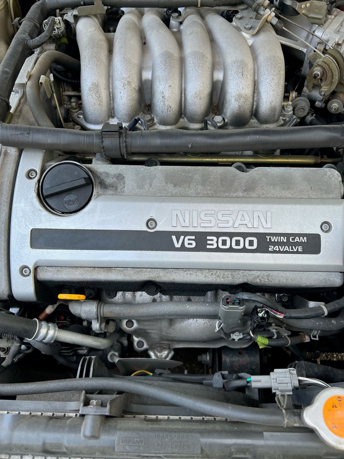

Thoughts ?

That's just gunk and sweat that can be washed away, if its not leaving drips or much further I wouldn't necessarily worry about it. Usually valve cover gasket leaks are more visible when you hoist the vehicle and look up at the side of the block vs the top though
