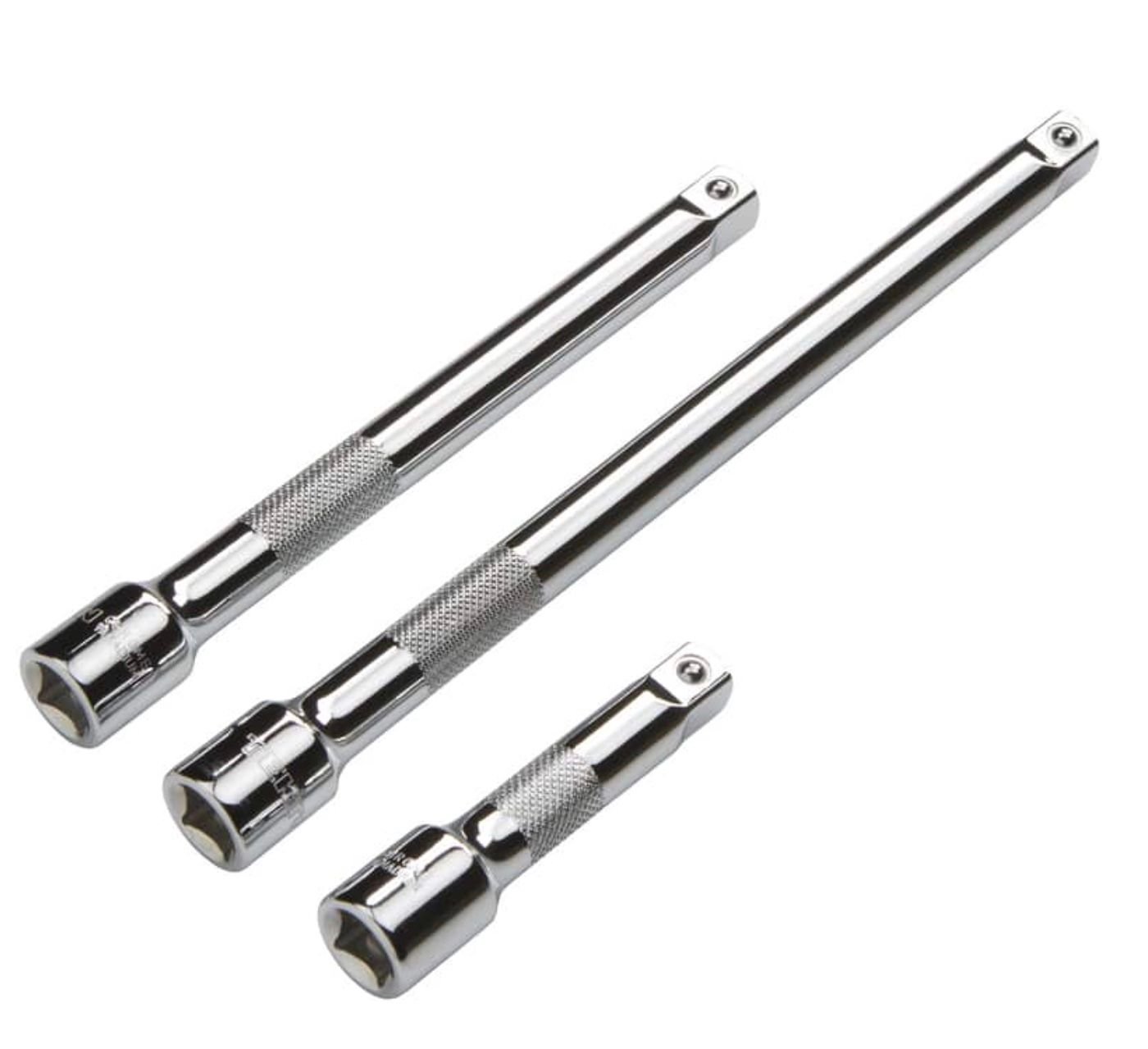

Access the KS from the driver’s side of the intake.

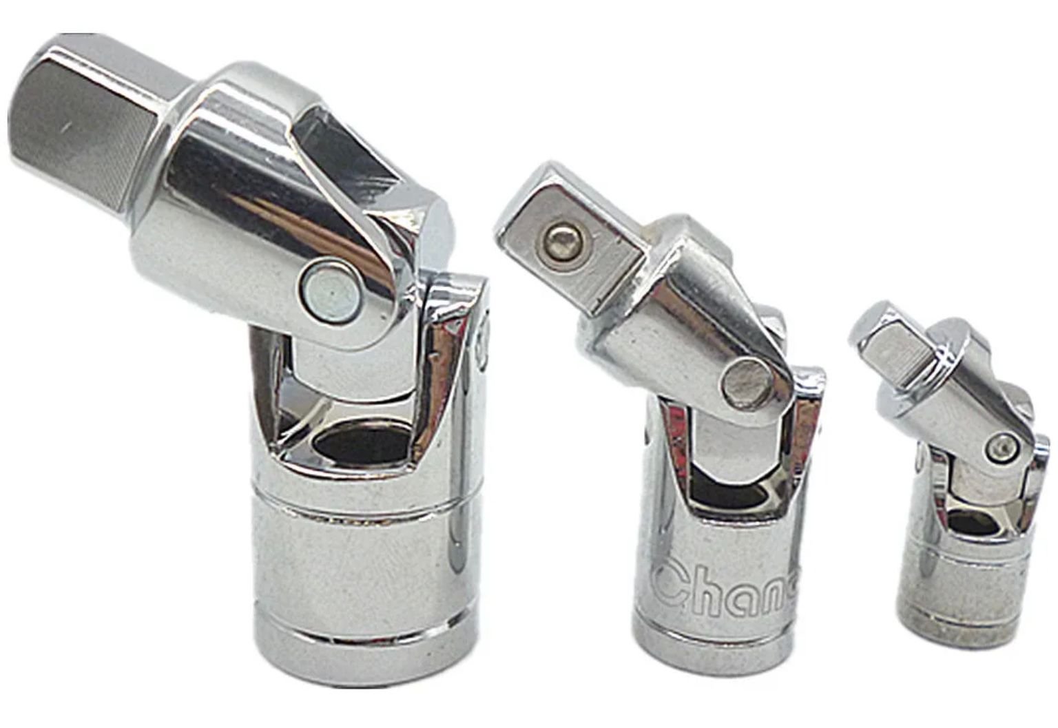

Use however many, appropriately sized, socket extensions that you find necessary, in combo with the appropriately sized socket swivel, to get your socket onto the KS bolt.
Patience and persistence are a virtue but it truly works … I’ve done it a number of times over the 25 years I’ve owned, driven, serviced and repaired my 4th Gen.

Having someone with very small hands is the best option and using multiple extensions and a swivel/u-joint. It can be done without having to remove the intake plenum. Its only a single bolt that needs to be removed, good luck.

The multiple extensions trick works best.
I wrap my extension joints with black tape so they won't come apart.

Regarding removal of the knock sensor, especially if it's original, you may find that it's quite seized, and you may or may not have success with the universal joint method. With this method there's also a non-trivial risk of bolt head rounding if you're putting a lot of force on it and the socket slips (translate, plenum removal in your future). At a MINIMUM you should liberally soak the bolt and bottom of knock sensor (where it meets the block) with PB Blaster and let it sit for a while BEFORE attempting removal. For me, the SAFEST and most effective method for breaking this thing loose if it's really stuck has always been the 12mm box end and pry-bar method. Here's an oldie but a goodie, showing the technique:

If not, get some 1/4 swivel sockets, 24 inch 1/4 extension, and 1/4 ratchet. Your first time you'll need patience, a flashlight, and some imagination.

I agree. 15 mins with swivel sockets, extensions and some touch. You don't need to get a hand on the bolt or sensor. Right hand on socket wrench (with extensions/ swivel) left hand on knock sensor wire (do not disconnect until you pull it out, use this to guide it out after you loosen the bolt. If you do it carefully the bolt will stay in the sensor and all come out from under the intake plenum together. Extension rod magnet in place for backup does not hurt. Replace knock sensor wire with new sensor and use that to guide it back under the plenum and with some touch you can get a thread in with the swivel socket and tighten her up, all without fitting your hand in there.
