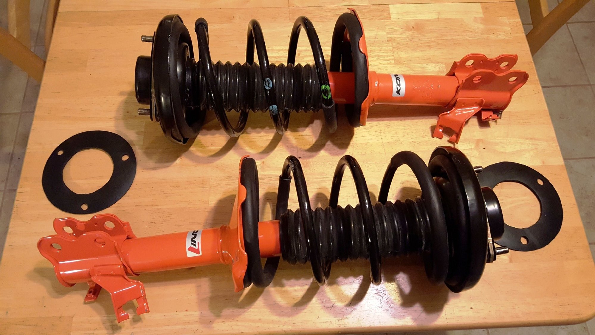

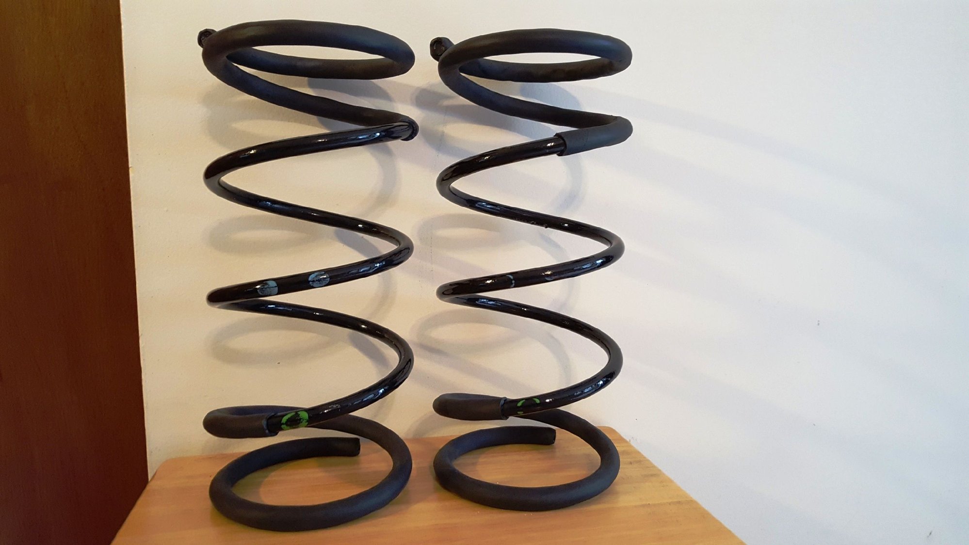

I have had three different sets of aftermarket Strut Assemblies on my 99 SE. All were garbage. Moog, KYB and Monroe.
I went back to original used SE springs, New Koni Orange STR-T Struts and all New OEM Nissan other parts like from the factory.. FINALLY... Like it should be.
I didn't use OEM coil spring insulators. Instead I used thick walled Heat Shrink tubing on each end. Exponentially better and will always stay quiet. See the picture below. I also cut my own 1/8" thick rubber gaskets that go between the body and strut tops.
My cost of assembling all four was approaching $1K before Covid. So glad I did it RIGHT. Hope this helps.
