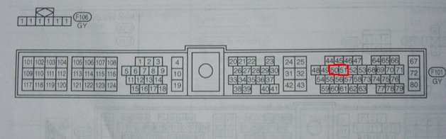

Well I hooked mine up to the rear 02 because I don't have any cats in my car but you probably do so you'll have to use one of the fronts which read exhaust before the cats. See if you hook it up to the rear the guage won't read rich/lean, it will stay in the middle because the rear 02 sens is after the cats and is used for catalyst effeciency testing. The easiest way is to go to the ECU (under the center dash kick panels) and splice into -do not cut- the 02 sig wire. Left front is ECU terminal 51 and R/F is 50. I have a pic of the ECU terminals. I will try to EM it to you if you like because the site I use to host photos is down right now.

You can splice them up to the factory ECM wiring behind the radio on the floor. You can approach it from the passenger side. You can splice them to either #51 or #50 IIRC (you will need the diagram but I don't have it scan in and available)

Thanks guys for the replies..Maximus75 if you can send me that pic that would be great. If you'd like just email it to me Nelson_Burgos@yahoo.com

Hey, is there an echo in here? Chunger, is that a carpet on your dash? Anyways, PRPMax, you've got mail.

No prob though its kind of a sh!ty pic. Give me your EM adress

When you check engine light comes on, you should try to see the error code. You can do that by turning the screw on the ECU clockwise then counter clockwise (after 2 seconds). What I suspect might be happening is that the gauge is loading the sensor altering its output slightly. If you have a multimeter you can check this by probing before and after you attach the wire. The ECU will think that you are running too rich or lean based on the reading from the sensor output. If you check the error code, I might expect a 114 code (I think) too rich or lean (don't know code for lean).
HOWEVER, I have not heard of other people having this problem. You may want to check your ground wire to make sure it is properly grounded.

uh, i wired mine straight to the ecu, but i didnt use either of those you mention, i use one on the row beneath it. I get great results, no problems......

Thats for the rear 02, won't be accurate if you have cats.
